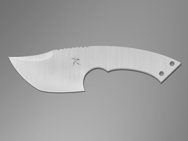

Ill be going back to Afghanistan soon and would like to make a few knives for some of the guys in my unit. Something simple and easy to make. Here is a sketch I drew on photoshop.
1095, 3/16" thick, HT myself to around 58-59. Handle will be cord wrap. Edge will be semi convex with a grind on top that will not be sharp just to ease penetration if need be. I like a good wide blade with some belly to make up for the short length and it makes it hella stout.
Size is about 7 1/2 " overall with about 3 1/2 blade and 4 " handle and the blade is 2" at its widest. No plunge lines for ease of grinding and I really don't see the need. The handle is pointed on the end for glass breaking and skull crushing. It will more than likely mount on the chest area with a kydex sheath. It will probably get cold blue or a forced patina to help prevent rust.
What do ya think? Any thoughts? Changes?
Thanks.

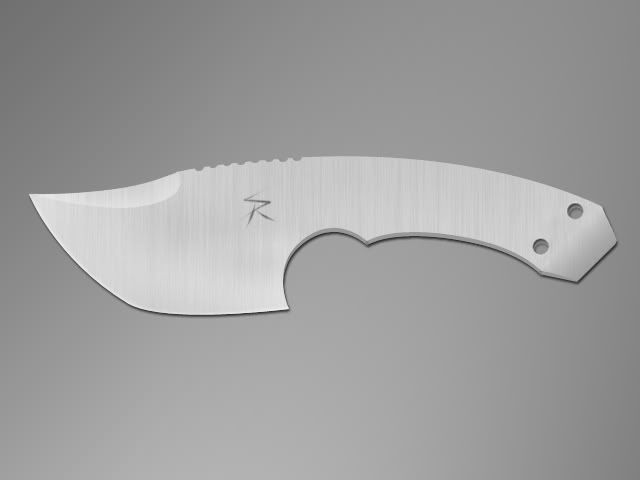

Thanks for the comments fellas. Here is an update that I might make from a user on another forum. I made a pry section on the end. I still am not sure about it yet but I may try it out on the first one. If I dont like it I can just grind it down to how I had it before.
maybe a little chopping, more than likely cutting straps , cord and MRE boxes. Hopefully it never needs to be used for stabbing but thats why i having a grind on the spine to help for penetration if need be. It will probably see its far share of prying as well.
i like it but I suggest skeletonizing the handle to save a little weight and to ease in cord wrapping.

Really like the pry-bar pommel on it. Maybe drill some holes so micarta/g10 etc slabs could be added. I really like the design though, looks great.

Since i added the pry on the end I might just put one lanyard hole in the end to keep it from being a weak point when prying.
One more thing. If i do add the pry can i heat the pry end to nonmagnetic and quench then turn the knife around heat and quench the blade then temper? I usually just heat treat the blade a little pass the handle but with the pry end it needs to be hard enough to where the metal doesnt deform or bend to much when prying but not so hard that it will snap when prying. Im open to suggestions abou this because ive never made one like this before.

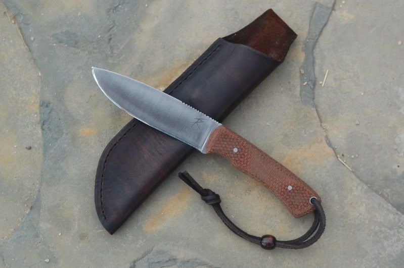

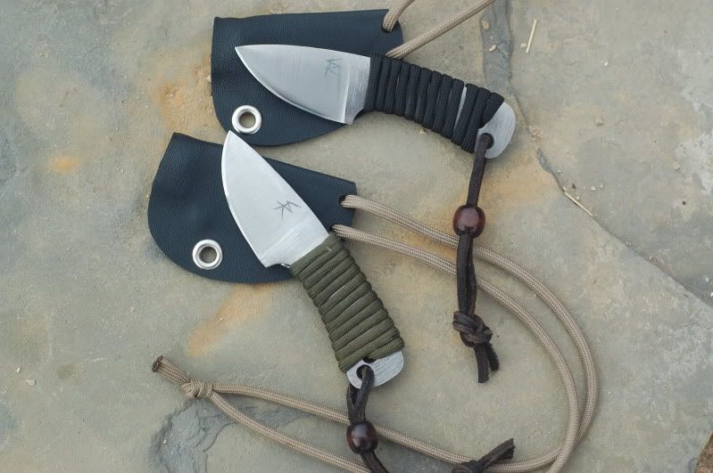

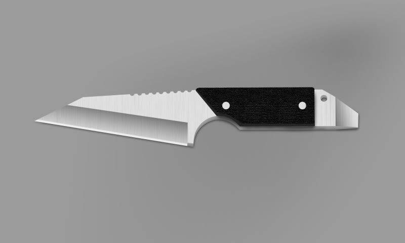

The first one is the one I made for my dad, the two smaller ones are the ones that i made my father-in-law and step-dad. The last picture is another one I drew up earlier today. So far all my knives have used convexed edges but this one is a chisel grind because i have been wanting to grind one for a while now.
nightman you are good with your hands. nice design & the only suggestion would be to round off the point a little on the choil. sounds like you may be doing some sniper work--just curious. thanks dennis
I like it very much! Personally though, 2" wide is a bit too wide for my tastes, maybe just 1.75"? But that's just me.
