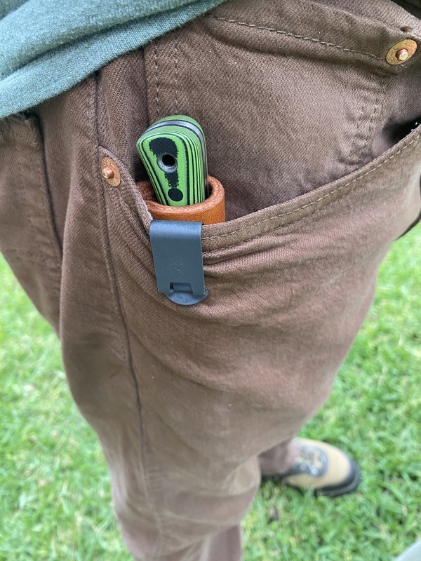

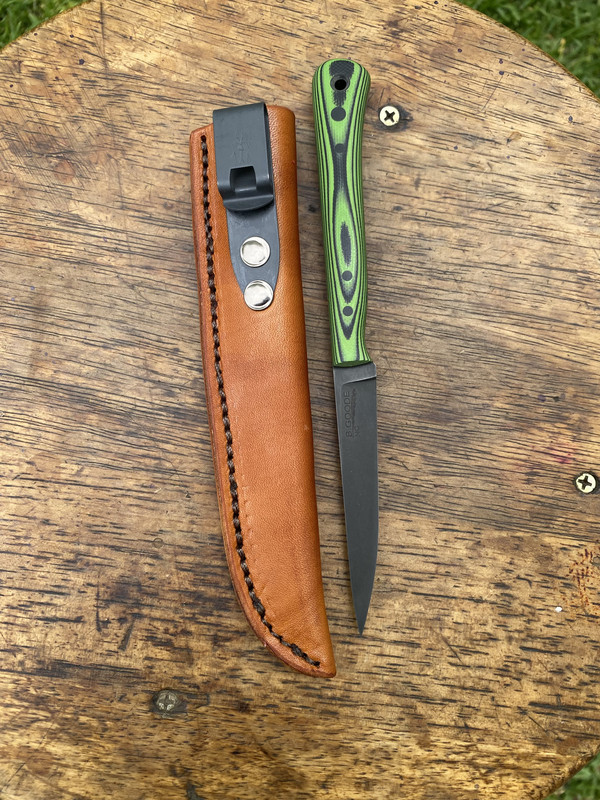

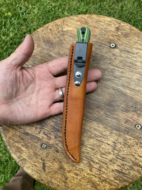

Okay this one was a challenge.
Had to make sure it was secure in sheath plus not stick your leg through too soft or thin leather.
Very happy with this sheath. I didn’t think I could pull it off with the clip and a classic single welt. I don’t like double sided welt for pocket carry. I guess I’m a weirdo 🙂
