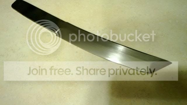

I started getting things ready for my little tanto style knife with saya. I want it to look something like this -
The handle and saya and going to be osage and the blade is going to be .125" 1080 steel. The blade will be ~5" and the handle will be ~4.5".
I got this much done today -
I still have to file a bit more on the bevel, should I go up higher than what I have, or is that about right?
Hopefully I can get some more time to work on it this week.
I would quit filing there, and finish the bevels with sandpaper and a hard flat block. You want them dead flat with a crisp straight shinogi. All the fine details, like the yokote, should be sanded in after HT.
When you get to that step, I'll give you a trick that gets a crisp yokote. It might look nice to file small 45 degree flats on the mune (spine) to make it have three equal size facets. This is called mitsu-mune ( Three sided spine).
Don't forget to drill the ana and make the machi (shoulders the habaki sits against) before HT. An aukuchi still has a small and thin tsuba(guard), but it is the same size as the handle, so it does not stick out any ( it is actually more like a seppa). 1/8" thick metal to match the habaki is normal. Copper works well for both.

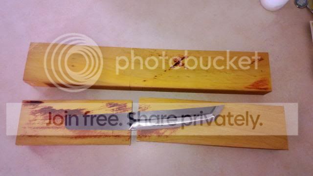

Unfortunately, you already have cut the wood in half, but the preferred method is to inlet the wood to fit the whole blade with the bevels down, then separate the two halves.

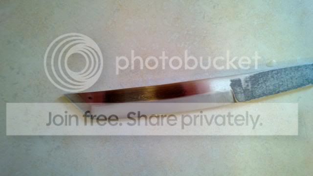

I think this is as good as I am going to get with hand tools... I really need a grinder. Now on to the machi and the ana. I had an idea about using Brazilian walnut or black walnut for the habaki, would that work? Or just stick with the copper?
I would not use wood. Use 12-14 gauge copper sheet. Wood at .100" and less would not work well at all.

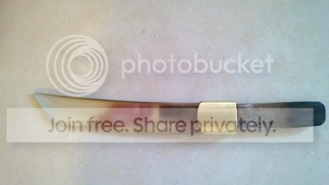

I got my habaki made and slid on, not sure if I'm 100% happy with it-
What do you think?
That looks pretty good.
Hard to tell from the photo, but if a habaki is just perfect, the mune and ha should be level with the habaki top and bottom. It is hard not to have a little projection, especially on your first habaki. This is part of determining how deep the machi should be.
The machi-gane ( the stops that slide up against the machi) should be about 3/4 of the way back in the habaki.
BTW, I know you said you were going to drill it in post #9, but where is the mekugi ana? The nakago (tang) looks like you annealed it and decided to drill it after the tsuka/saya are made. That works fine, too.
OK, I am going to tell you what you have done on this blade that makes it a tanto shaped western knife, not a real tanto. You made a tanto shaped blade on a tang. The proper way is to file the whole bevel all the way back to the nakagogiri ( end of the tang). The nakago ( tang) should have the same shape and bevels as the blade part. There is no plunge line. When the habaki is slid on, it should meet seamlessly with the blade surface all around. Properly fitted, you should not be able to slip a piece of paper between them anywhere. With the plunge and thicker tang on your blade, the habaki will obviously have a gap at the ha. The shape of the nakago varies, but the whole blade should have a smooth and gradual taper in thickness from the nakagogiri to the monouchi, and then taper toward the kissaki (The front 1/3 of the blade length from the tip is called the monouchi). This tapered nakago will allow a tight fit into the tsuka with only the mekugi holding it together. The tang you have is just a flat piece of steel that is thicker than the blade, and will not work as well. For this reason, most "Western Tanto" knives like yours generally have the handle glued on, and the peg is just decorative. The true tanto can be disassembled for cleaning and sharpening with merely the mekugi knocked out.
This isn't to say that you haven't made a nice knife ( I am impressed by how well it looks), but just to tell you where it should be different if you are looking for authenticity.
