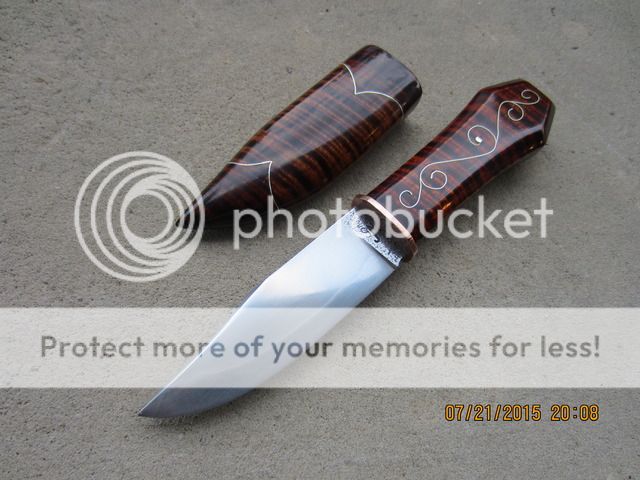

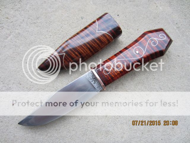

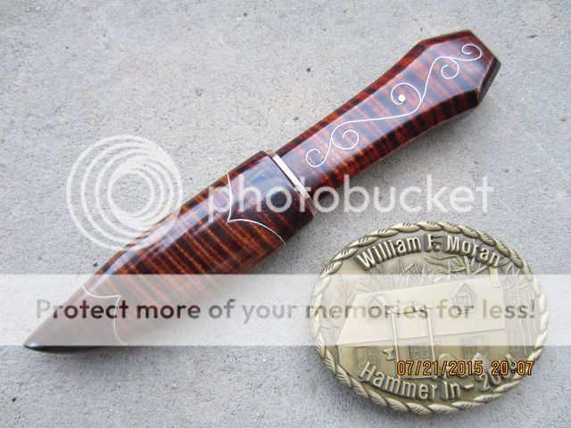

I made this for my wife's Birthday. A small stock removal blade from an antique saw mill blade, edge quenched. Stained curly maple coffin handle with silver wire inlay. And my first curly maple sheath, The sheath has a small magnet inlayed inside the sheath to hold it tight, it has silver wire work and two tone stained. Blade is 3 1/2" OAL 7". Hammer textured copper guard.

super sweet! Not what I was expecting wrt the shape of the blade, but a nice surprise. A chubby little bowie- cute as a button :)
Beautiful knife and sheath my friend.....I'm sure she's thrilled!

VERY BEAUTIFUL KNIFE, THOUGHTFUL GIFT.
GREAT grain pattern in the maple, NICE TASTEFUL inlay design, NEAT BLADE. :thumbup: :thumbup:

That's some beautiful workmanship!!! Can you tell me what you stained and finished the wood with? Thanks for sharing.
Bill
Thank you for the kind comments, my wife loves the knife/sheath!
bgmills, I stained the maple with fiebings leather dye, {med brown & light brown} and four coats tung oil for the finish. I rubbed the finish with a cotton rag soaked with boiled linseed oil and made a slurry of "Rotten Stone" abrasive, and rubbed the blade with the rag also to mellow the 800 grit blade finish. Fun project I'm thinking of making a big version.
