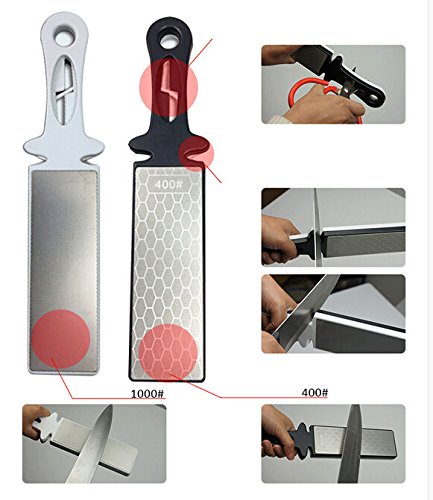

You should like this, both carbide scraper, ceramic crock stick, and diamond stones in one, under $20
actually this model might be all ceramic crock sticks, there is a similar one where one of the notches in the handle is carbide scraper
