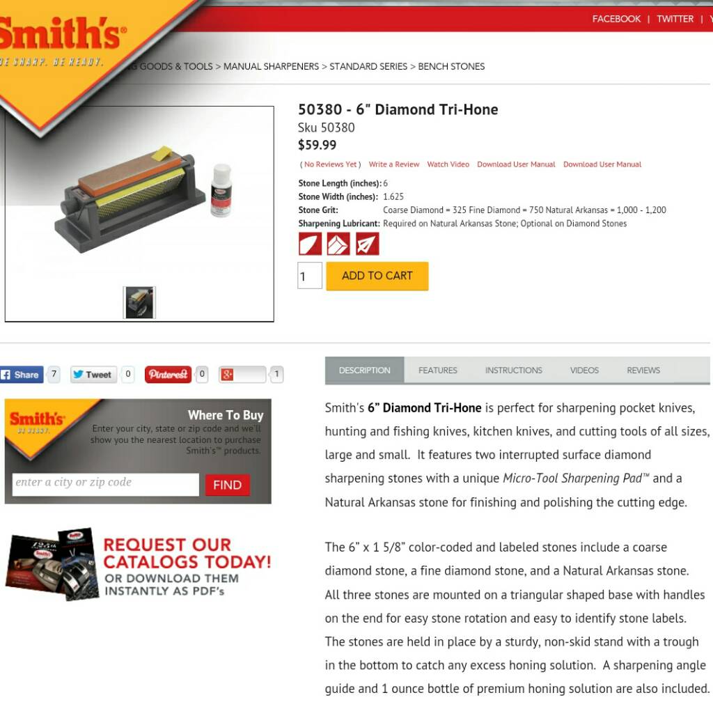

I found this small bench sharpener with 2 diamond stones (coarse & fine), plus a finer Arkansas stone. It has great reviews and looks like the ticket. It is a bit short at 6" long, but the price is right at <$50.
What do you experts think?

I have no issues with the Smith's tri hone. I have a number of Smith sharpening stones. Use a long chisel type on my machetes a lot. You should be good to go, although you might find a larger sharpening surface easier to use.
Thanks rimfire. Here's a picture of the sharpener that I forgot to post.
And a link to the product description.
http://www.smithsproducts.com/product/50380/

I've used this exact system for all of my freehand sharpening and achieved good results. It's not fancy, but will get the job done. Put a very nice edge on all of my kitchen knives as well as a Benchmade 950 Rift. As was mentioned before, just have to make sure you are getting a burr.
