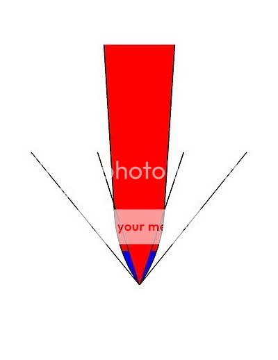

Sharpening a knife is a matter of geometry period. Edge holding is a matter of steel and heat treatment period. These are simple statements you can take to heart. People will say x brand knives are hard to sharpen or y brand knives are hard to sharpen.The problem these people are experiencing is that the blade is too thick directly behind the edge. Anyone that has been cut opening a tin can has experienced the power of edge geometry. If you look at the following drawing there are two sets of lines. The closer you get to the inside lines the better the knife will cut period.

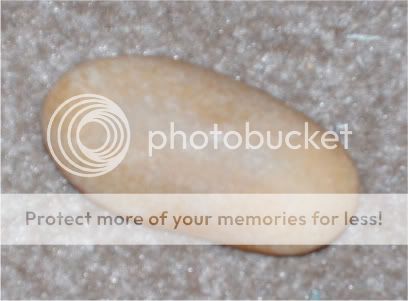

As you reduce the angle of the edge one of two things will happen. The edge will chip or it will bend. Then you can put on a secondary bevel if needed. There is no voodoo involved in sharpening , there are no magic stones or gadgets. It is a simple skill anyone can acheive.The picture below is a rock i picked up in my yard that i sometimes use as a finishing stone. If you look closely at the middle of the stone it is darker on the ridge i use for sharpening.
If you feel sharpening impaired take heart it's easier than you think.

thanks. so if i create the secondary bevel it should be at a higher degree than the first right?
Con, correct . Blade, I would'nt word it that way but I can agree with you . (Just the first sentence) . The diagram looks alot like one in John Juranitch's book . Quote: "no voodoo, no magic stones and anyone can achieve it". This sure sounds different than things I hear around here at times . DM
