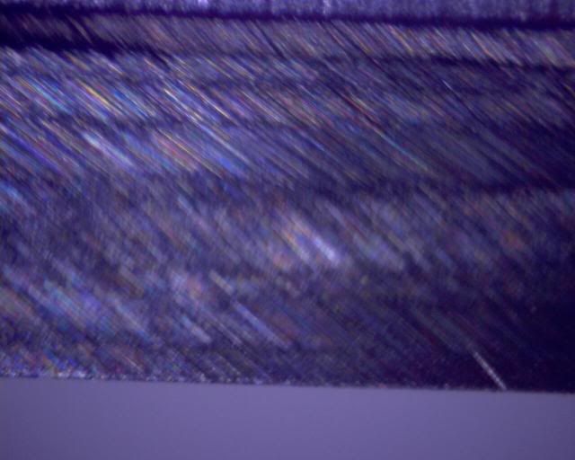

Using high magnification is the best way though because after all the methods for finding a burr are exhausted and you think the burr is gone.... its not.
Here is a pic of a edge after being sharpened on the EEF DMT hone, I thought I was done and ready to strop until I took this pic.
100x
bgentry, that is another way but I think you will find problems when the burr becomes very small. I use the finger nail method because I can feel a burr in the range of 8000 and beyond, the edge can still feel equally sharp and still have a burr.
100x
Wow. I honestly cannot see any trace of a burr there. You are good. And speaking of magnification, I picked up this a while ago and returned it for these, the only reason being that I always hear when someone recommends a loupe that it be 10X. The lighted one that I returned is 15X and I thought maybe it was too strong to properly see what I needed to see. But the built-in lamp was super helpful and the whole set-up much more stable than the cheap-o plastic eye piece loupes I ended up with. I'm considering buying it again when I go to Lee Valley tomorrow to pick up a double-sided strop and some diamond paste.
