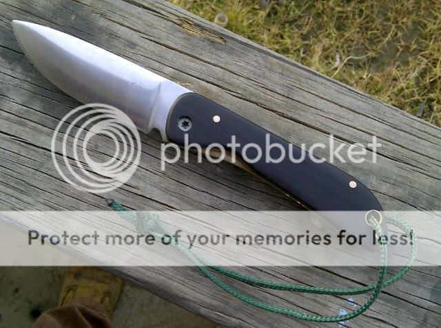

Smokepole Ranger Friction Liner Lock Knife. Finished
As this is a first attempt the maker has offered it to me at what's best described as a very fair price which I cannot divulge. He plans to produce more for sale with alternative lock types and scale materials if there is sufficient interest...

Pic's of the knife pretty much finished. Really pleased with the result.

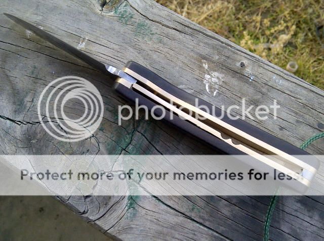

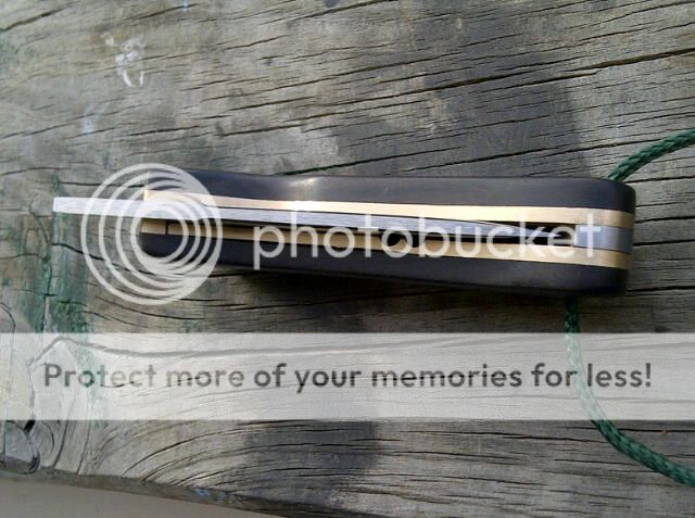

Very nice folder, I have a similar one ( ff/extended tang and liner lock )made by a Japanese blacksmith, carbon blade but ss liners .Your brass liners look good.

Awesome looking blade. Definitely interested to know what the price tag might be if he made others. Looks like a beast of a folder that'll handle it all.

Really nice looking folder. I especially like the brass liners. I'd be interested in seeing more of his offerings myself.
came out really nice

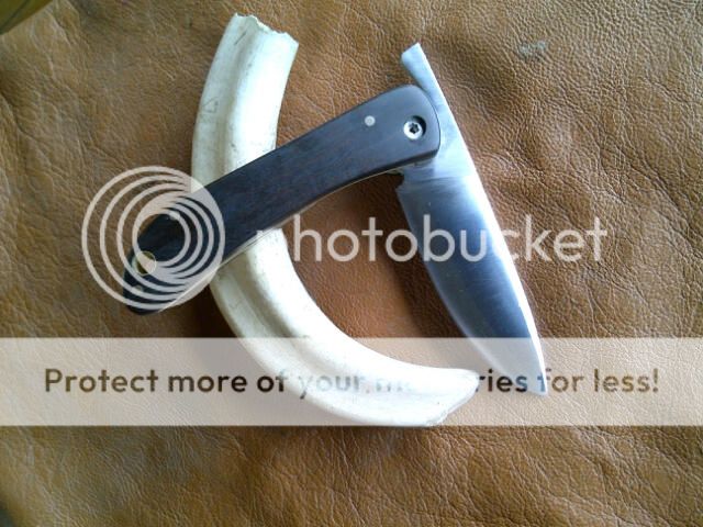

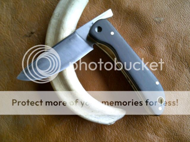

I like the friction-linerlock combo actually, interesting geometry too

First of all, thank you for the kind comments and interest in this knife and the design - even though he is very modest, a large part of the credit must go to Sam (avoidspam). I am glad he likes the way the knife has come out - it has been a pleasure doing a commission for him. The knife should be with him shortly and I can only trust it will live up to expectations.

Redbusa06, essentially you are correct, but I prefer making the bend only after I have milled the indents in the lock part of the liner/frame. I like to bend it kind of all over, with the emphasis on the milled area, and it would depend on whether you will use a detent ball or not - if you do, you have to taper the lock part also, or mill a slot for it in the liner - in both cases on liner locks where there is a scale present too. On frame locks you don't have to taper the lock part of the frame to allow space for the ball, but some do in any case so that it doesn't stand proud of the rest of the frame when the knife is closed.

I just realized that knife also reminds me of a Case Russlock, which if I'm not mistaken is basically a friction folder with a linerlock.
Well, the knife arrived today..... I can only assume that Willem must have had a smile on his face as he finished this one. All the pictures he sent could not do the knife justice, the knife far exceeds my expectations, beautifully designed and crafted with everything working so well together.
