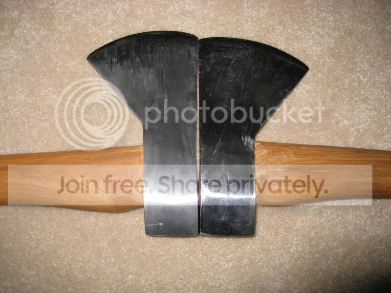

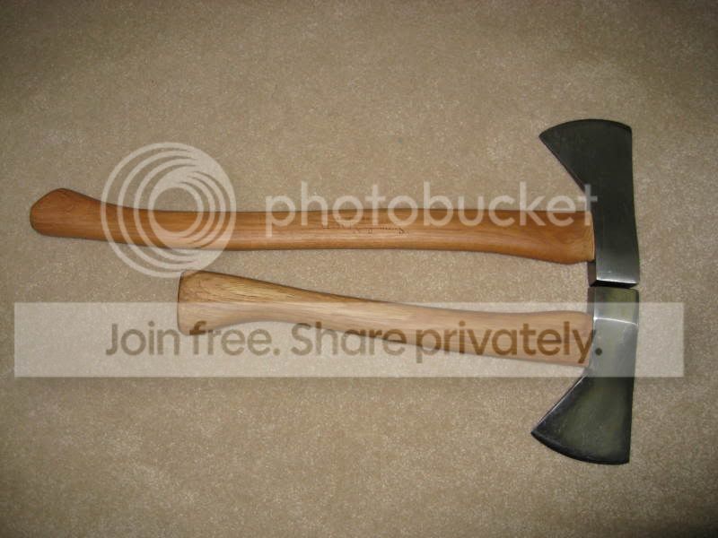

I am told the Pen Bay and the Hudson Bay share the same head. From the pictures you can see they are very similar but not the same. The shorter Pen Bay is on the right. Interestingly the Pen Bay weighs 40 ozs and the Hudson Bay weighs 41 ozs. The GB SF weighs 34 ozs.
I bought the Pen Bay first and Brian did a polish finish on it. The Hudson Bay came with a satin finish. If you are buying a S&N be sure to get the modified one from Brian. If I were to keep only one of the S&N's, I would keep the Hudson Bay as it is easier for me to use and weighs virtually the same.
