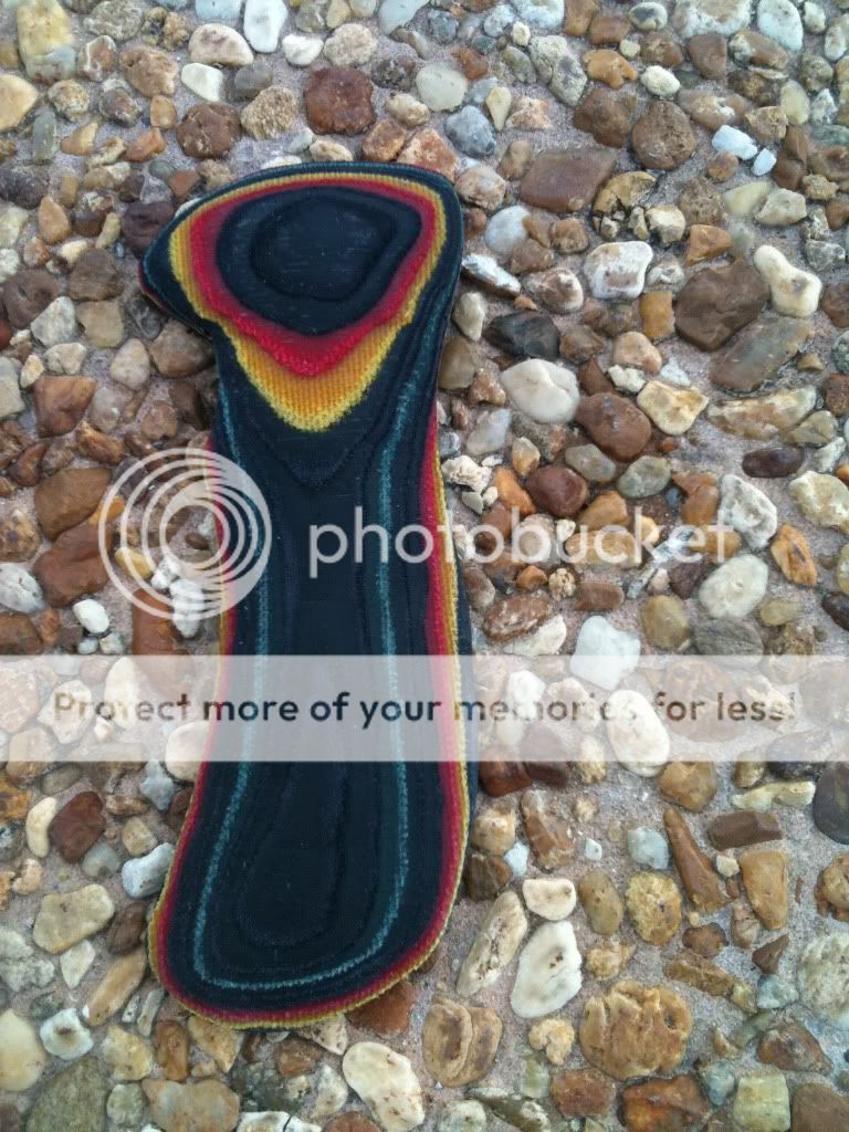

Snakeskin....
It's canvas. But it's got less canvas and more resin. Several colors of resin and at least 2 (bear with me, I'm color blind) of canvas. Lots of work goes into that micarta.
I didn't even know resin had a color that was evident after it dried. This is really interesting...
I didn't either. I thought the colors came from the canvas, paper, or linen. I was under the impression that the parts of snakeskin that are not canvas are paper, i.e. the red and brown colors. And that the yellow and greenish white colors were canvas or possibly linen. :confused:
My first attempt( all canvas) was an epic fail, been meaning to try again with a mix of linen and canvas, just might have to add paper into the mix
Definitely doesn't look like snakeskin, but I don't think it looks bad... would probably be really sweet for a contoured hand-shaped handle.

I could be all wet. But well-cut Snakeskin shows a lot of very very very very very smooth areas around the canvas layers. Perhaps it's paper sammiched in between canvas. It ain't anything with a grain structure.
Look at those 3-series rope-cuts. I just always assumed it was solid resin between the canvas. Resin HAS to have a color - otherwise black canvas would be. . . um. . . BLACK and not farkin ugly light green!
If there is some sort of structure, it gives me hope. I always assumed Snakeskin was much more frageeeeelay because it had less binding material in it and more resin.
I think your on to something there Dennis. The red is definitely paper micarta, but on some there does appear to be a separating layer. On my AD its apparent but on my skinner its not. Also I'd swear that theres a big difference in the makeup between the two handles. The skinner has canvas readily apparent while the AD has a much finer material (ie linen) in the same spot, the tan and gray being the mystery. I once had a Snakeskin NOe that was all very fine, no obvious canvas type weave. I miss that NOe. :(

Snake skin is a combination of paper, linen, and canvas micartas in layers. I think its that formula that makes it so difficult to replicate, aside from the original maker that is and he seems to not be doing it any more.
Interesting......First time I have ever had anyone tell me that it is actually completely different materials combined like that.

burgundy paper, gray canvas, burgundy paper, tan canvas, repeat.
I stand corrected on my linen supposition. :o It looks like canvas and paper micarta's layered. There has to be a substrate in between the canvas layers not just resin as there is some space there, it would squish flat under pressure.

That is exactly what I have thought it was too. Then towards the top there is a layer of red paper and yellow canvas then back to the other colors. :thumbup::cool:
