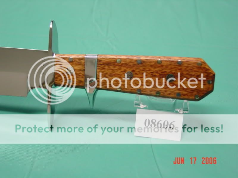

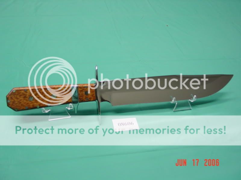

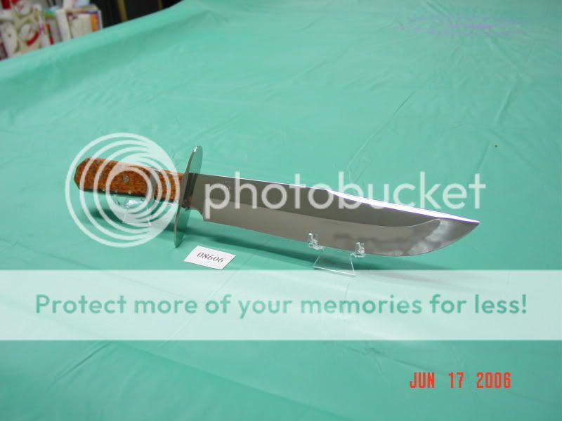

I just finished a sub-hilt coffin handled bowie with Snakewood and it turned out well. 2 days after I finshed, it developed a crack the full length of the handle on one side. I was careful to not have over-tight pin holes at assembly. Anyone else have this problem with Snakewood and what can I do to prevent this in the future? I will attach pics of the knife prior to cracking.

Dan...did not overheat, the pattern indicates shrinkage and with as many pins as I had, something had to give. It shrunk back away from the tang edges just like when I used some green wood once. I am wondering if this stuff was green. I'll try to get some pics up of the crack.

Everyone has this with snakewood.It does not stabilize well and is usually used in the natural state. Take the crack and fill it with cyanoacrylic repeatedly until filled.Cover the entire wood surface once the crack is completely filled and dry.Let dry for at least a week. Re-sand with 400 and then go to whatever degree of final finish you did before. It will remove the crack to almost invisible after buffing,and the wood will be much more crack resistant.DON'T heat the wood up while sanding and buffing.That is the kiss of death to snakewood.
