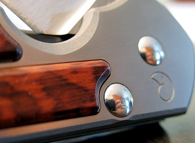

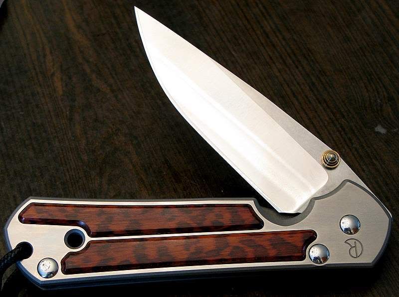

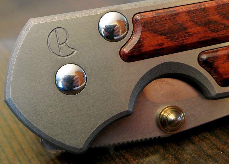

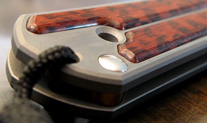

Hi guys and gals, my large Sebenza Classic with Snakewood scales
arrived today, what a cutie pie she is, very sleek, take a peek, here
are a few shots quickly taken tonight;
First order of business was to flip those screw heads to the clip side
and have the polished smooth sides on the main side of the handle,
to me, it just looks nicer.
Easy to do, just one at a time, carefully loosen and push up to free
them and then push the rest of the way out with the allen wrench
insert it from the other side, and tighten it down, move on to the next
screw, just do it one at a time and you'll be fine :)
