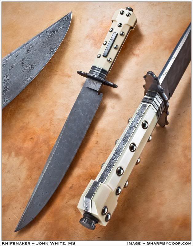

Let me add two magnificent photos of the finished Dogbone...
First by our own Coop...
and one Chuck Ward took at the Arkansas show...
The knife we'll be looking at here is a 10 1/4 inch, six-bar Turkish Twist Damascus Dogbone Bowie, with Walrus Ivory scales, and fittings of matching Damascus, and Sterling Silver.
At the end of this thread, we'll see photos of the finished knife by both Coop, and Chuck Ward.

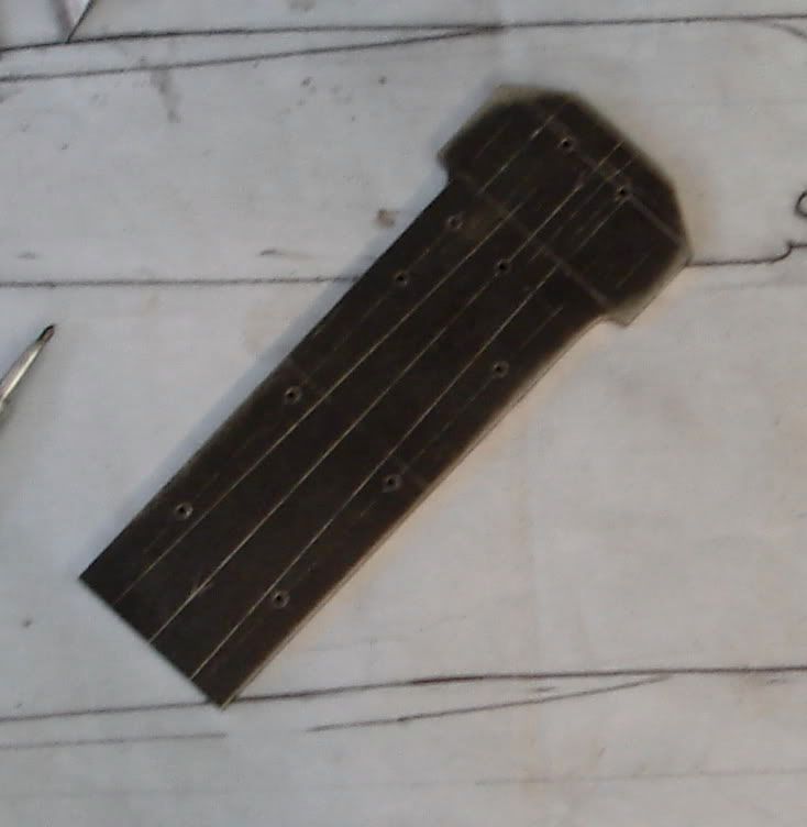

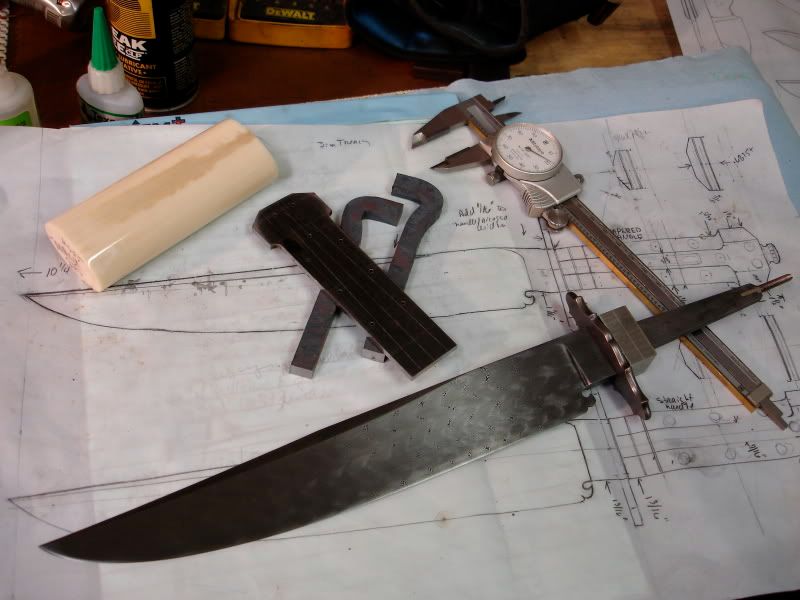

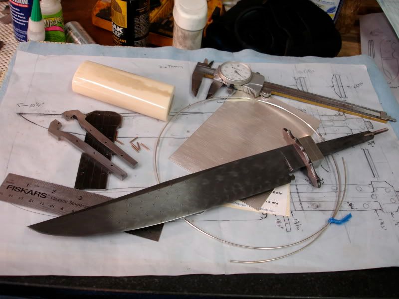

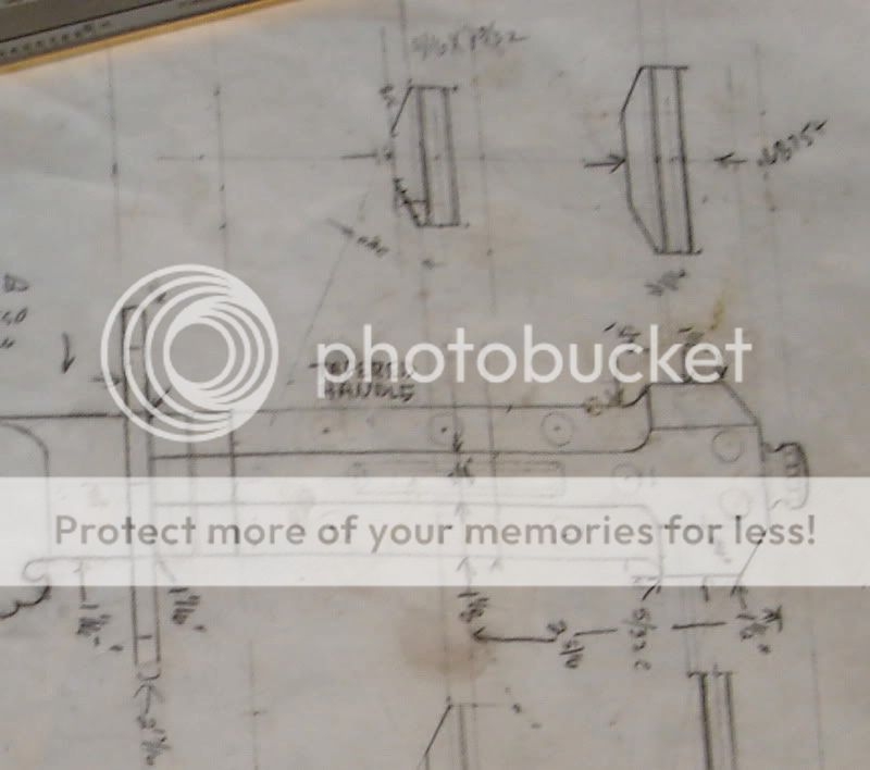

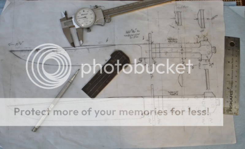

Snap #1- The design drawing, and the handle plate.
Jim asked for a Walrus/ Damascus Dogbone, and requested a six-bar Turkish pattern. We both knew we'd be referring to Tim Hancock's master interpretation of this traditional style, but I also taped a photo of the original 1800's "Loving-Kimball" above my desk when I did the drawing.
I sent Jim a sheet with two designs, the bottom,with the standard parallel sided handle, and the top, with a double tapered handle, thicker and wider at the butt than at the collar.
As I'd hoped, Jim chose the tapered.
The detailed drawing, with sections, allowed me to pre-plan all dimensions and tapers,
and to cut a 1/8" steel pattern, which could be drilled for all pin holes.
This pattern could be super-glued to the damascus frame pieces,and to the sterling silver frame spacers for drilling the pin holes, and stacked over both when I drilled through all, into and through the walrus scales.

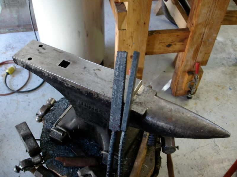

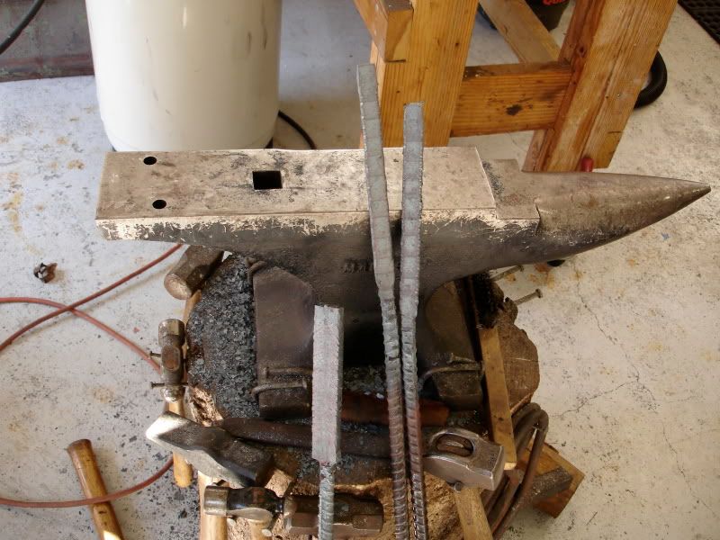

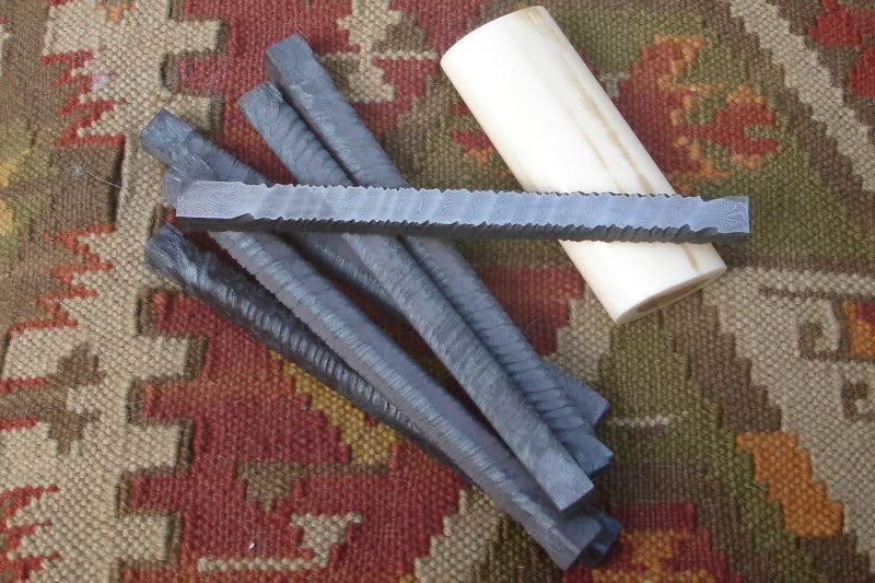

I forged and twisted six bars, 1/2"x1/2"x6", of 176 layer Damascus.
By the way, that's the chunk of beautiful, creamy walrus that makes up the handle scales. We'll be losing almost all of the streaks as we cut into the ivory to shape the "dogbone, but the cream color will more than make up for that.

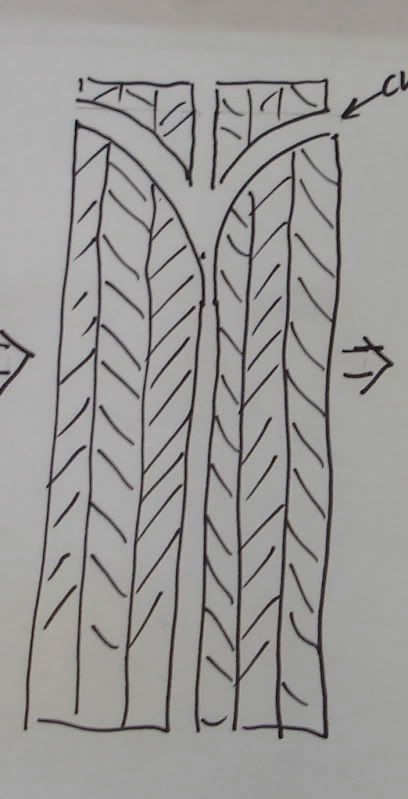

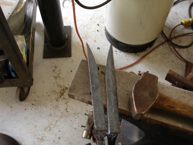

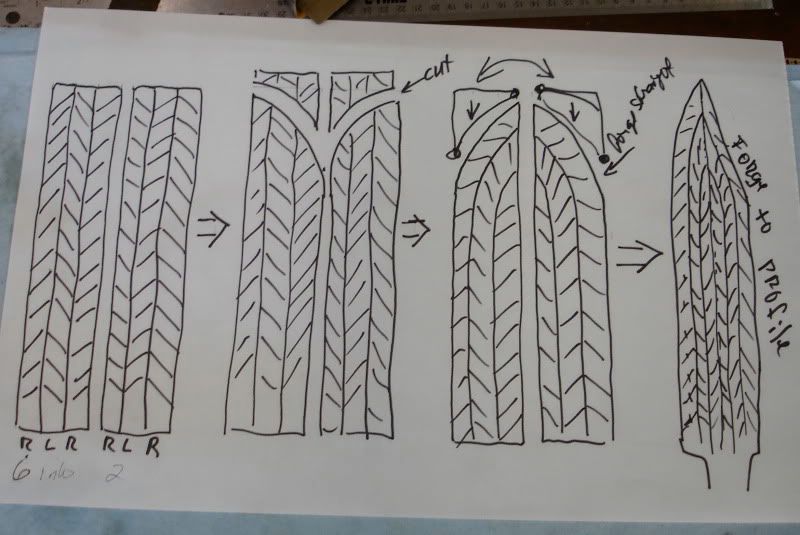

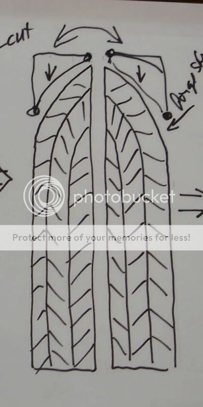

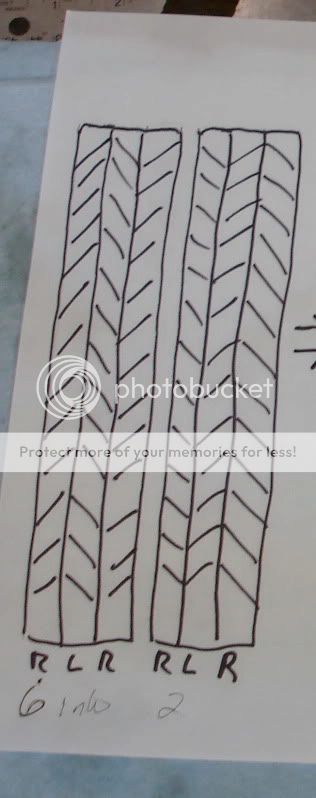

In a six-bar, we want the two outer bars to run the length of spine and cutting edge, and meet at the tip. We also want each inner bar to meet along the center line in a symmetrical manner. Here's one way to do it.
First, using the twisted bars, forge two, three bar billets, with the twists alternating.
like so,
and so,
then cut curves from what will be the center-line to the tip, like so,
and so,
then forge the curves flat to the center-line like so,

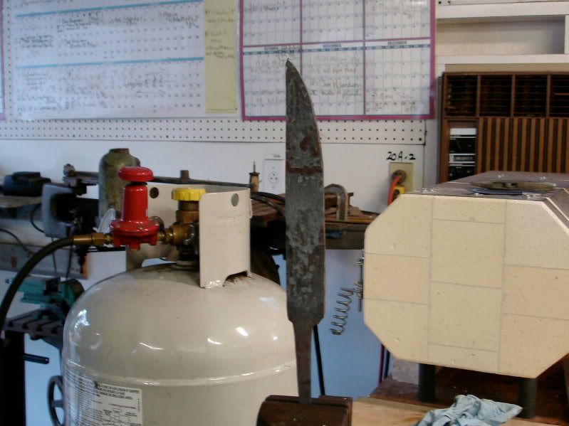

and finally forge-weld together, and forge the blade to profile, like so.
like this,

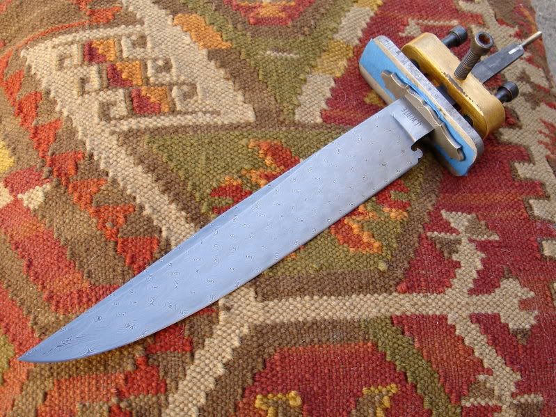

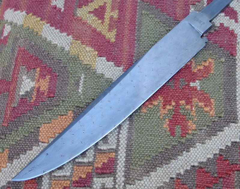

and after heat-cycling,rough grinding, hardening, tempering, finish sanding, and etching, we'll have this.

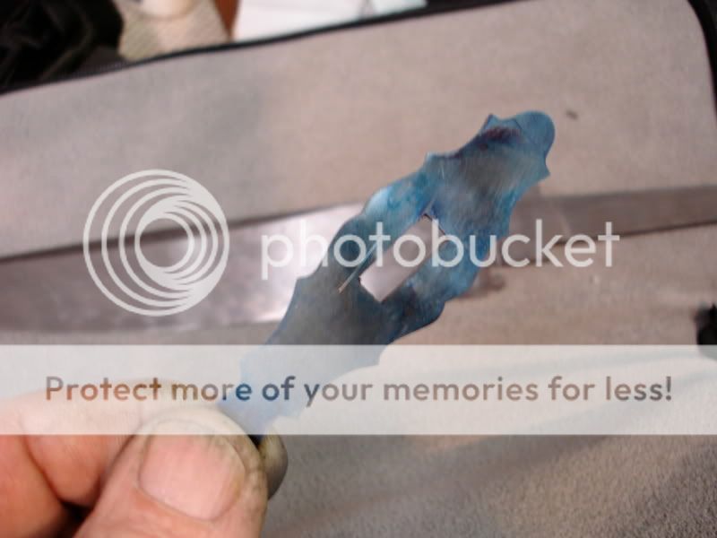

Snap #3 Shaped Guard
With the blade finished, I'll forge out four more twist bars, two for the frame pieces, and two I'll weld together for the shaped guard.

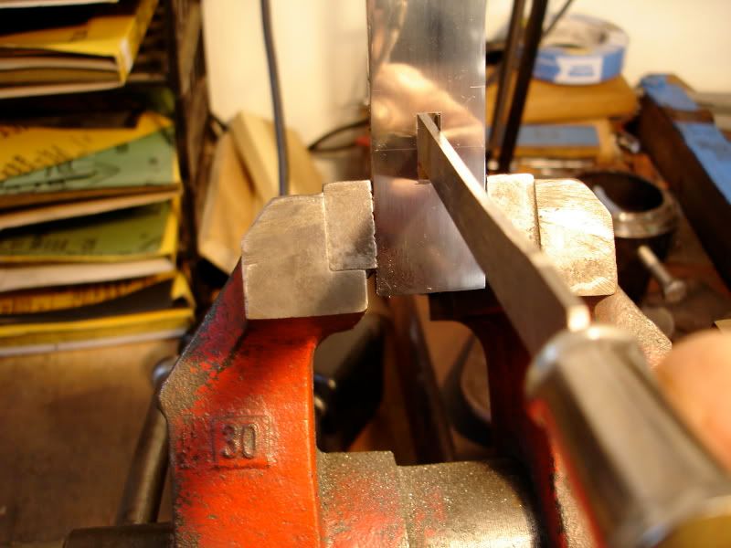

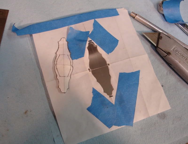

Since each shaped guard I make seems to need to be a different size or shape, I don't bother with a metal pattern. Instead, I'll fold a piece of tracing paper twice, at right angles, and draw a quarter pattern. Folding the paper over, lets me trace the pattern through and duplicate it exactly. Then, I can simply tape the paper to my guard material, and cut the shape out with a razor knife, leaving the outline on the steel, like so,( note the octagonal "Dogbone" shape of the collars on the guard drawing)

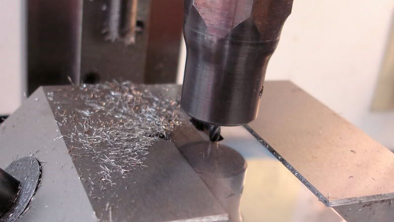

With the pattern marked out on the polished damascus, I'll mill out the slot to within a couple thousandths,

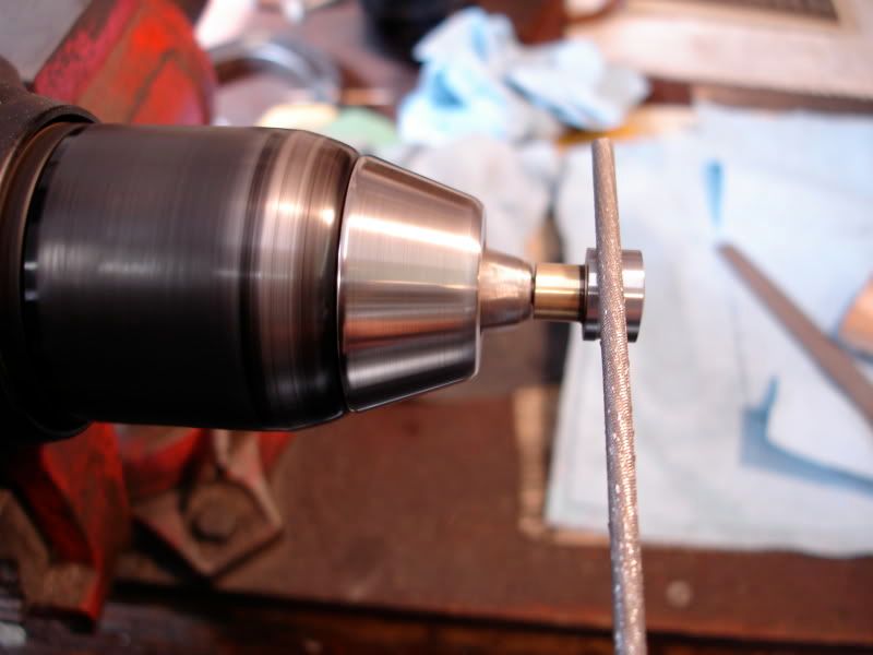

and file the milled slot for a press fit. The polished damascus creates a mirror, which lets me keep the file absolutely perpendicular as I cut.
Using the work platform, and a 50 grit Norton, its easy to grind to the cut pattern lines.
Round over the edges with chain-saw files, sand out to 600 grit,
Heat-treat and temper the guard, since the etch looks better on heat-treated damascus,
re-sand to 1200 grit, etch, and I'm ready to press the guard onto the finished blade. I'll use a screw press, adapted from Uncle Al's soldering fixture.

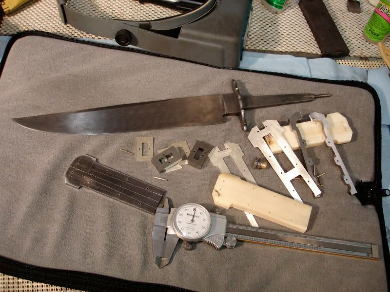

In this shot, I've slotted the two pieces of twist damascus, and three of sterling silver, onto the tang, where they'll become the octagonal, grooved collars. I've also flattened, and forged roughly to profile, the two frame twists we saw earlier. They're lying under the steel pattern I made from the detailed drawing. I keep the Walrus around for inspiration.
Here, I've cut the frame pieces to exact profile, using the pattern, and then, by super-gluing the pieces to the steel pattern, drilled all the holes for the sterling pins in the correct spots. That's $120 worth of Argentium (non-tarnishing) Sterling Silver plate and wire under that blade!
As I begin to assemble and dis-assemble the handle the hundreds of times this will happen over the next days, I'll need a finial to hold it in place. Here's my state-of-the-art, 18volt, Makita portable lathe, and chainsaw file cutter turning the damascus I've silver-soldered to a round nut.
In this shot, I've been turning out the parts. In each case, I've used that steel pattern to mark out the profiles on silver plate and walrus, then superglued the pieces to the plate for back-drilling. At one time, I had a stack of two sterling spacers, the two frame pieces, and one scale, all stacked up and glued to the pattern for drilling.

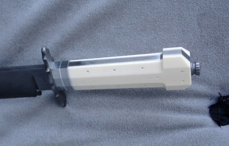

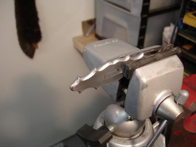

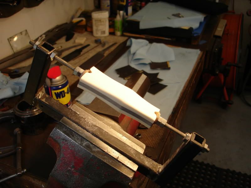

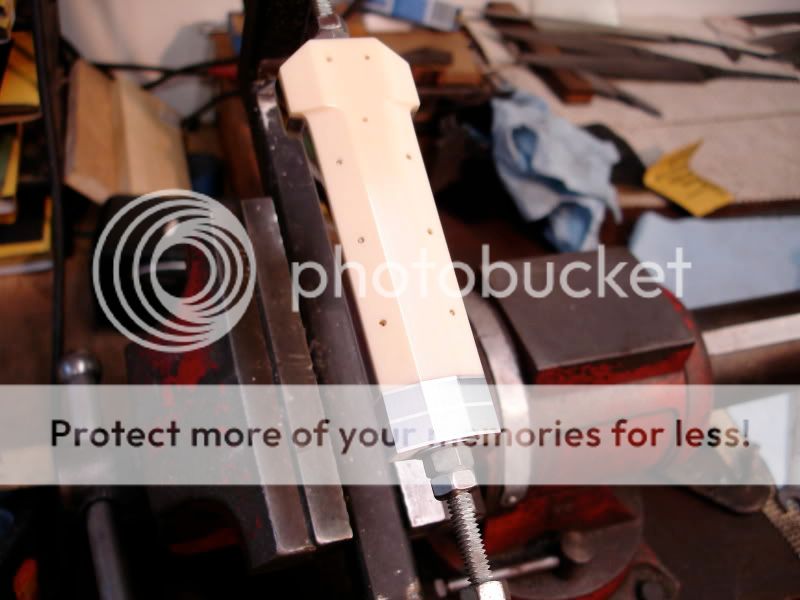

What's this thing gonna look like when its all put together. Here's the handle rough-ground, and on the spindle for hand finishing.

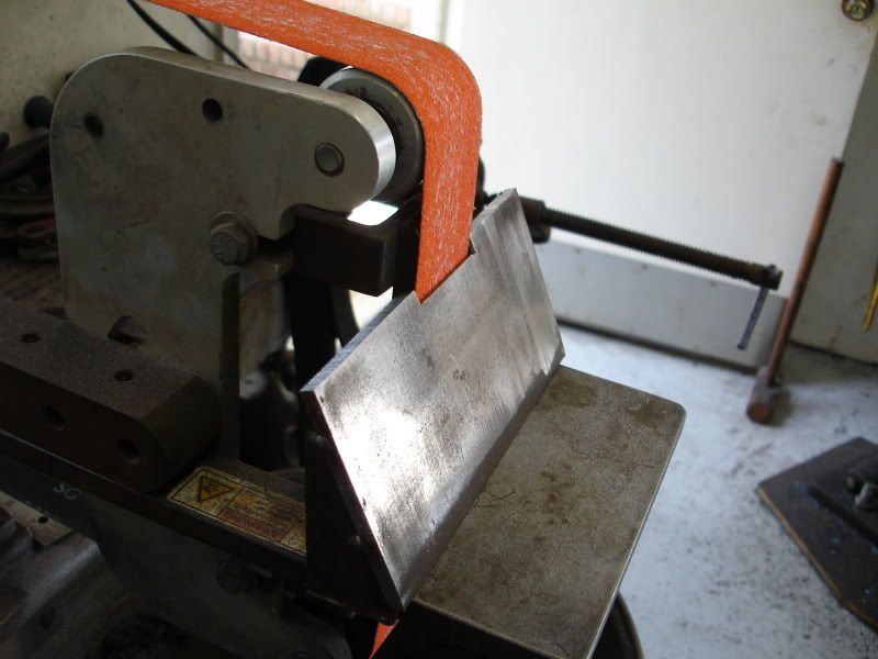

This spindle is a "C" shaped jig, with a 1/4 inch re-rod, and a set of nuts and washers, that clamps in my vise, and holds a handle together, while it lets me turn it to all angles for filing and sanding. Here's a better view(with a different handle)
And here, by the way, is the angle plate on my grinder's work platform, set to the 24 degree angle taken from the detailed drawing, that cut those facets on the handle.
This knife took about two and a half weeks of eight hour days. Lets assemble this puppy, and look at it, to cheer myself up, and try to keep going.
