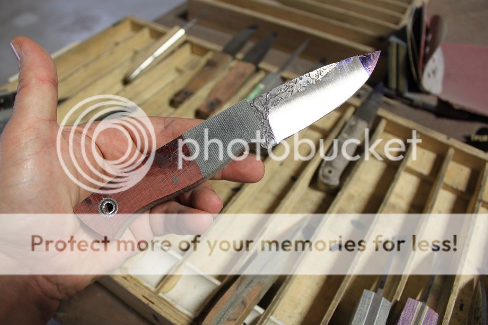

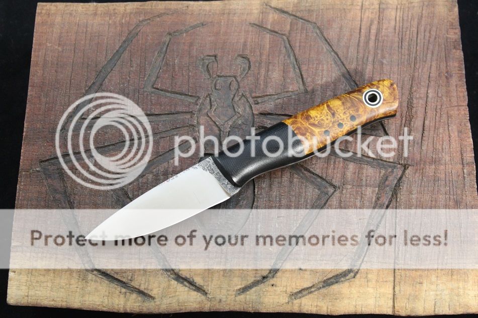

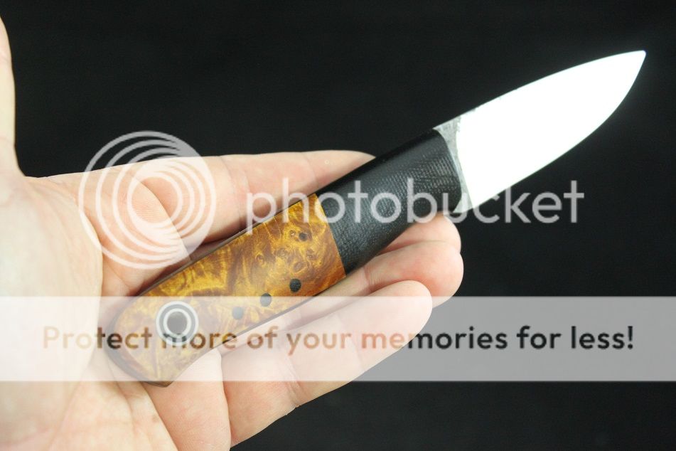

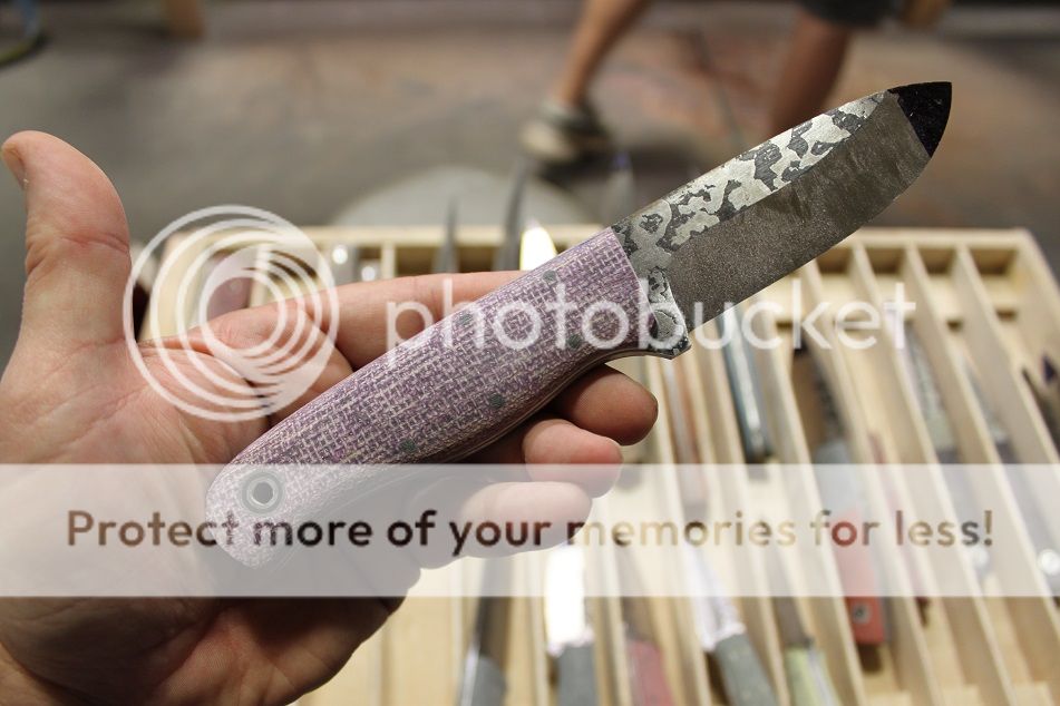

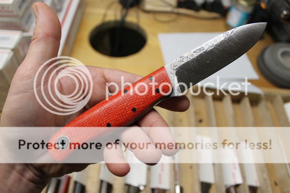

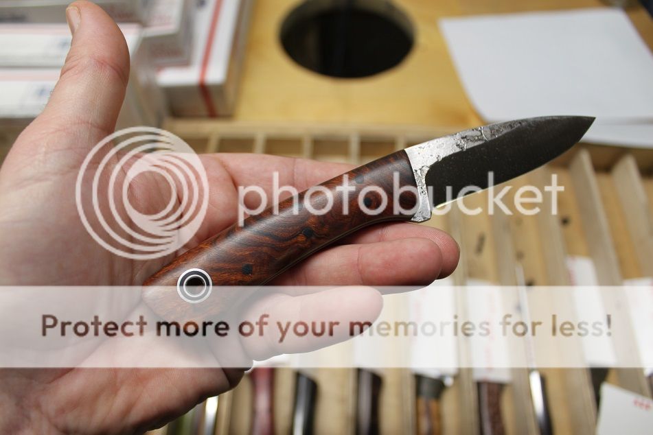

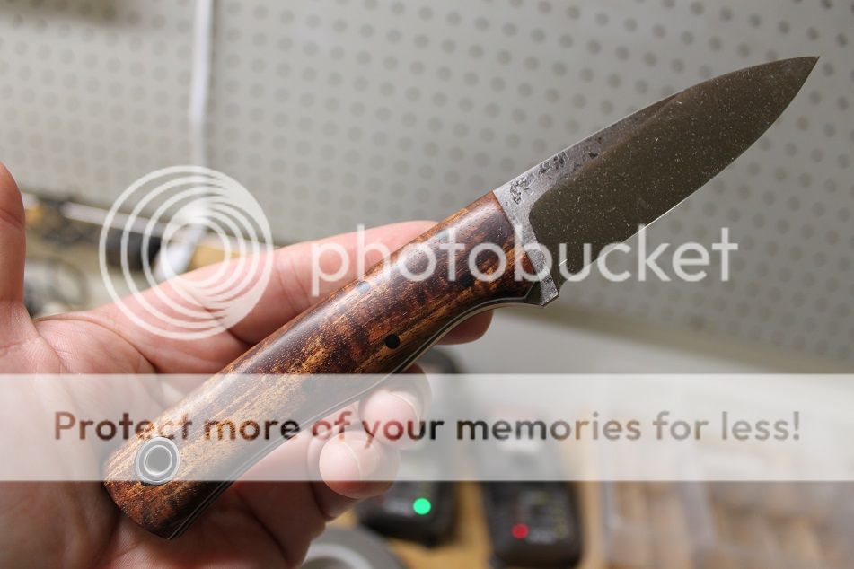

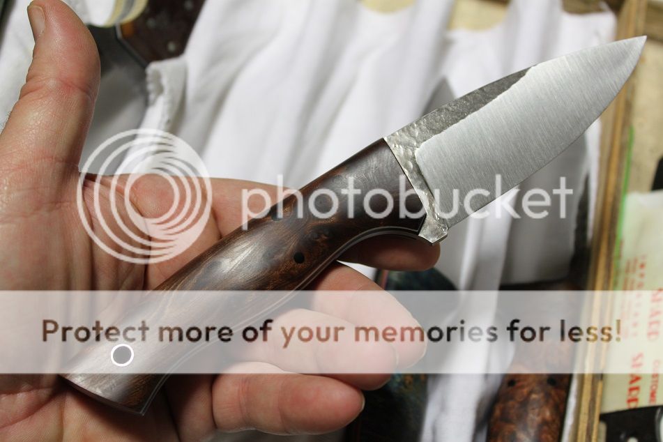

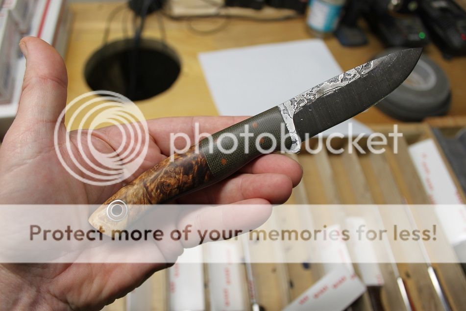

Thought I saw someone asking what does Andy carry or use everyday .. so I swiped this from his pocket for a couple pictures.
It was one of his 'Knife Guild Knives'. Pics do NOT do these knives any justice They do have a feel and look that are museum quality.

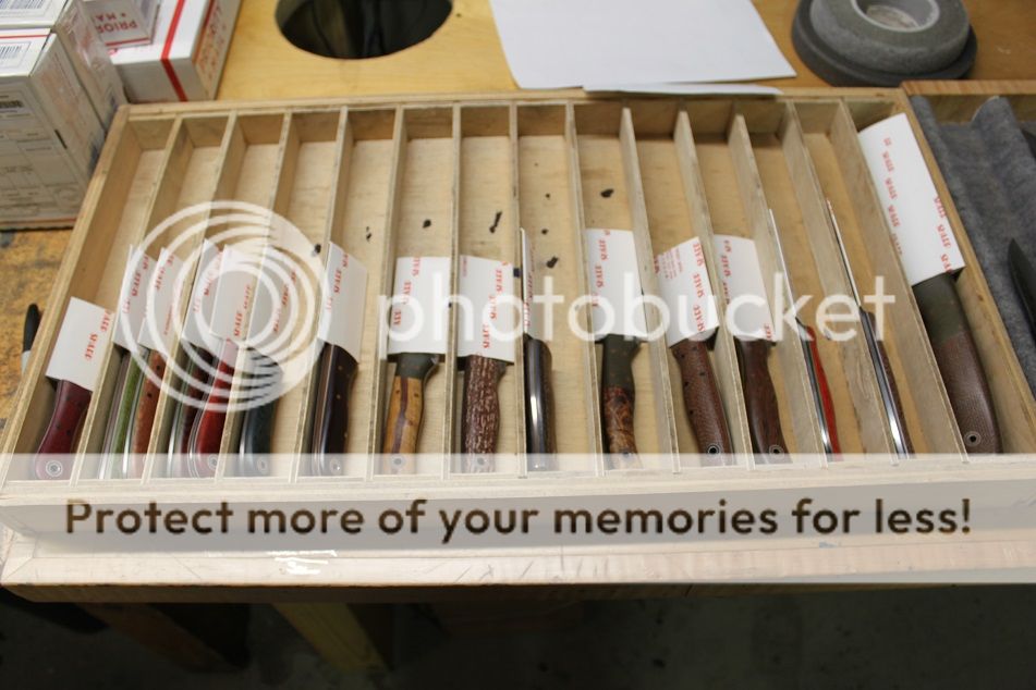

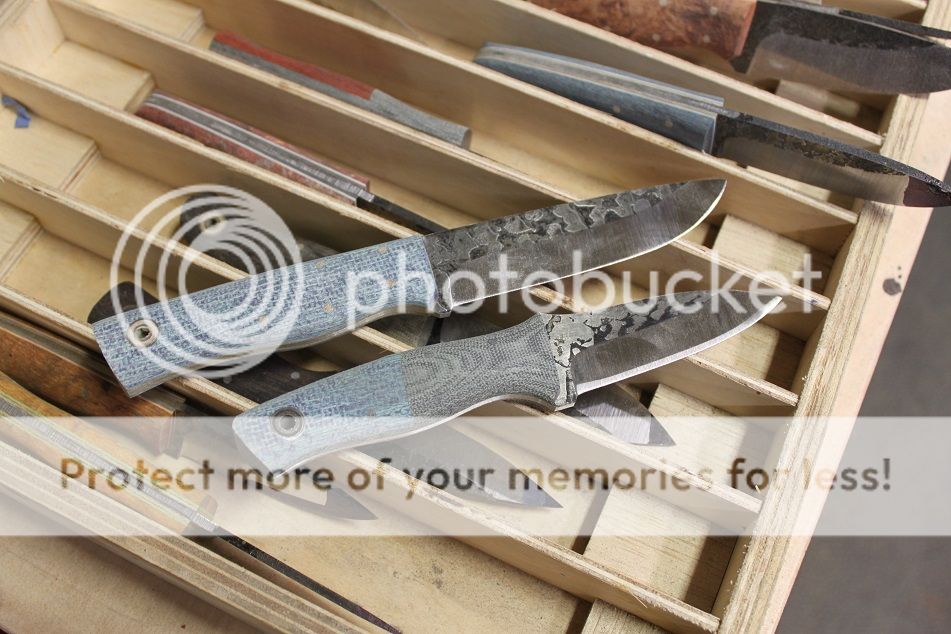

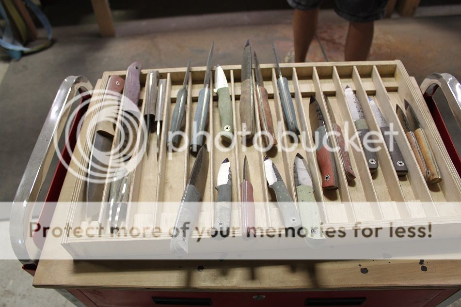

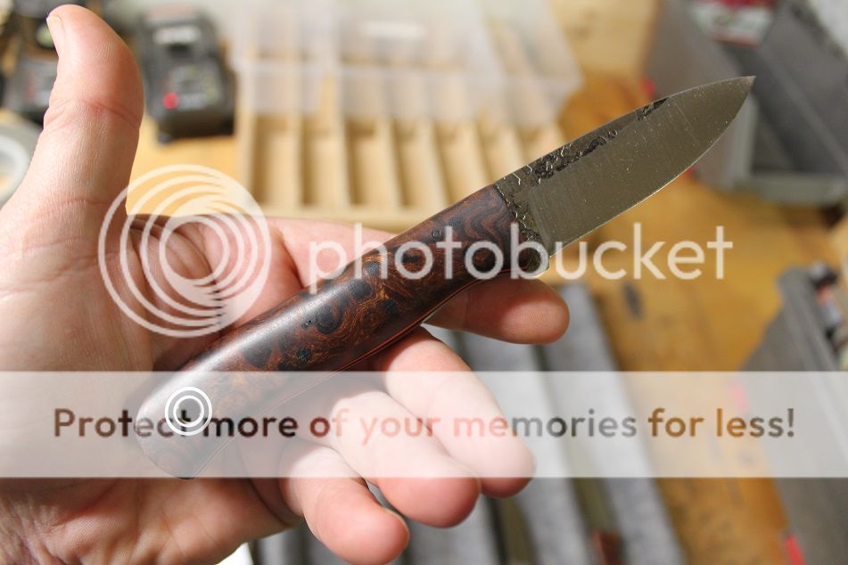

Dealer Caddy #1
Dealer Caddy #2

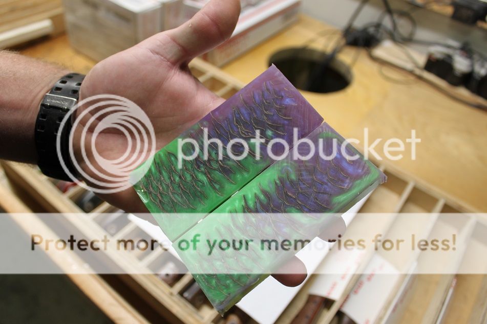

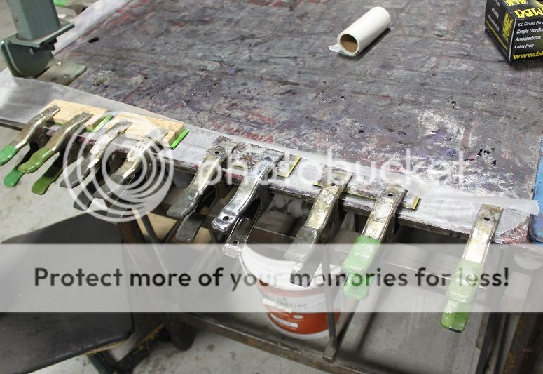

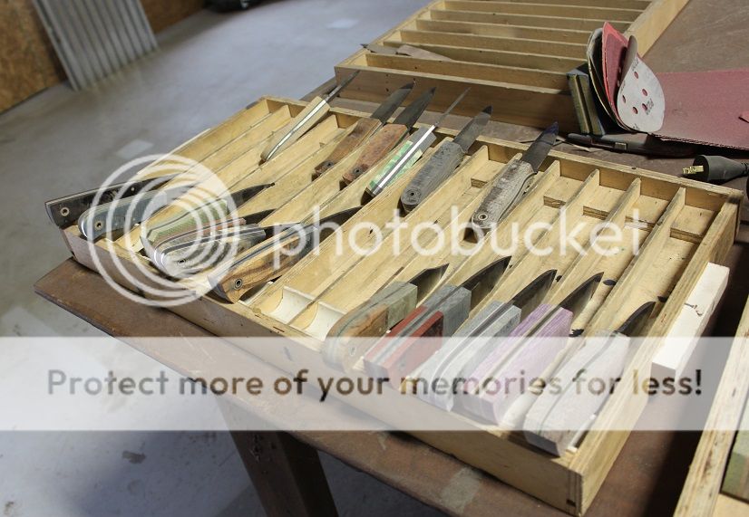

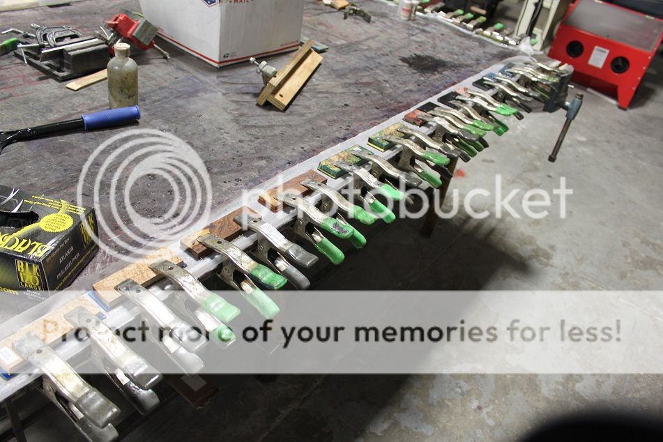

Glue Up Scales table.

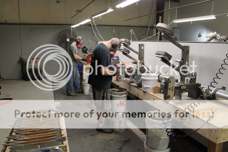

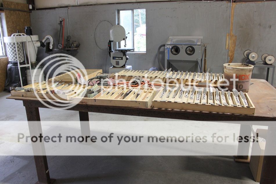

Prepping Table - Grinder Room

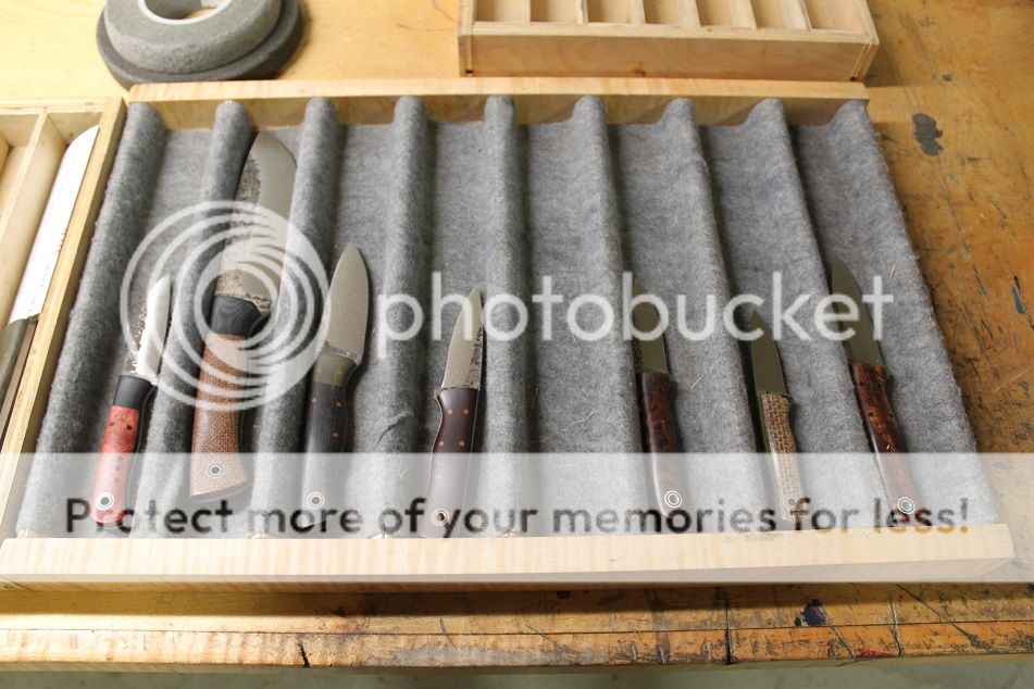

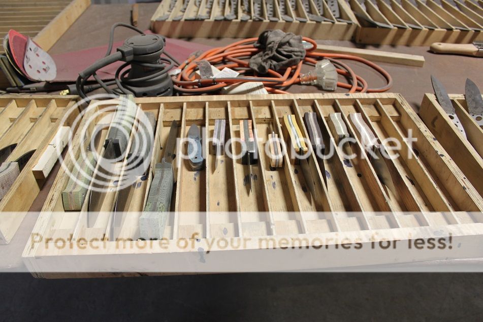

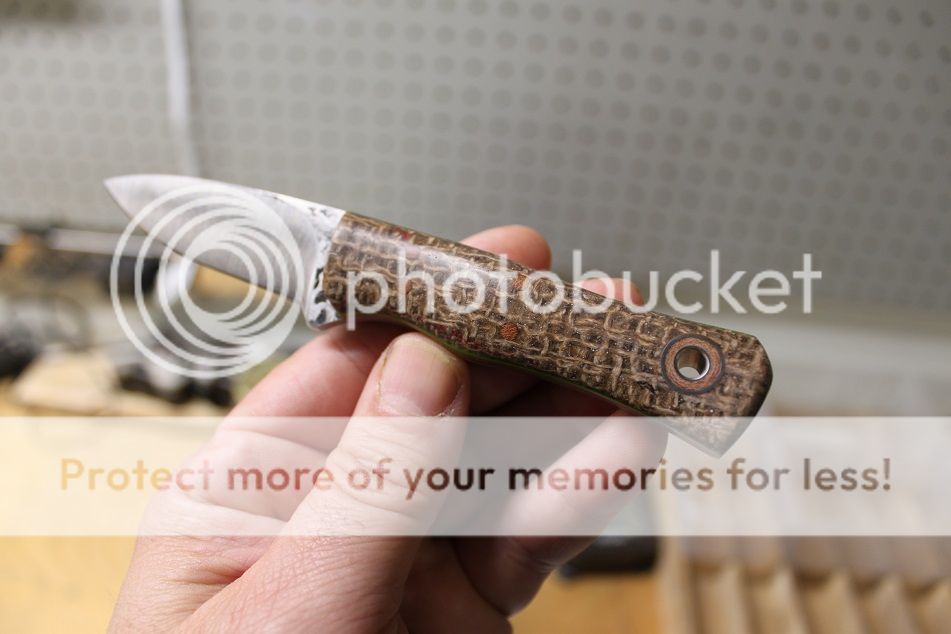

Custom Shop Caddy on the Prepping Table

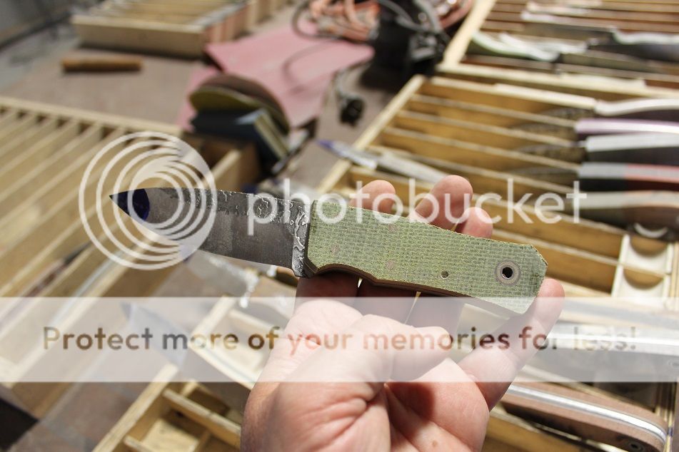

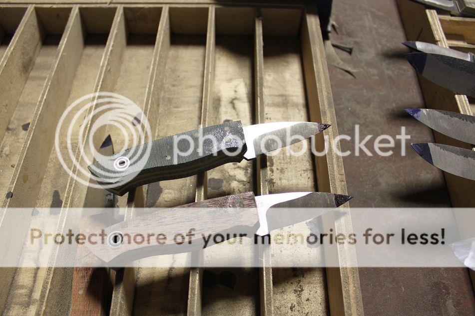

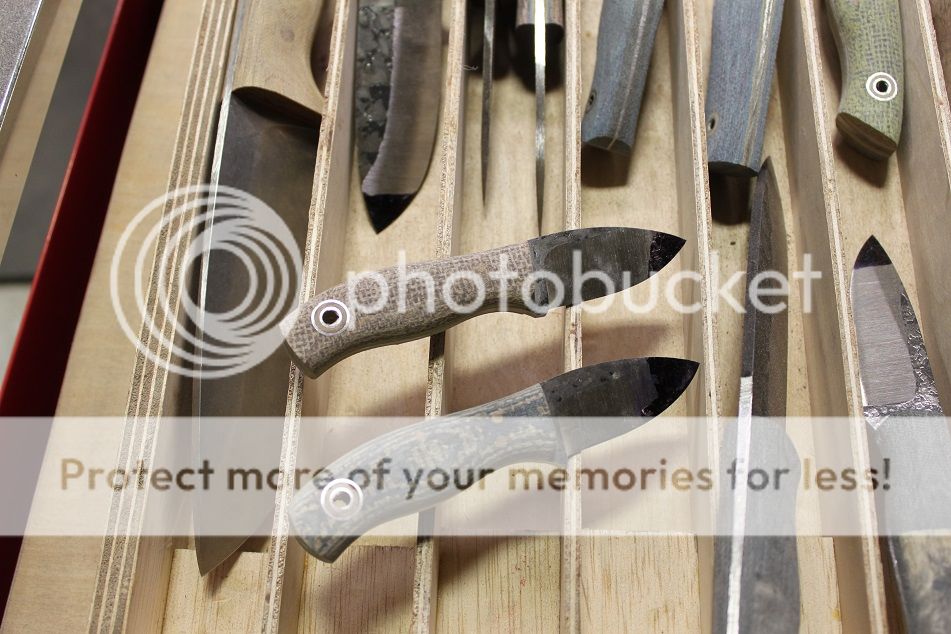

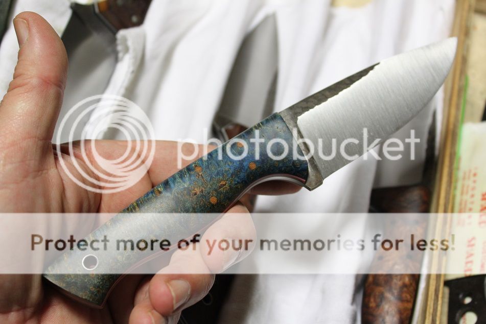

Ready for handle shaping Caddy (hand made knives)
Andy's Handle Shaping Caddy for the day.

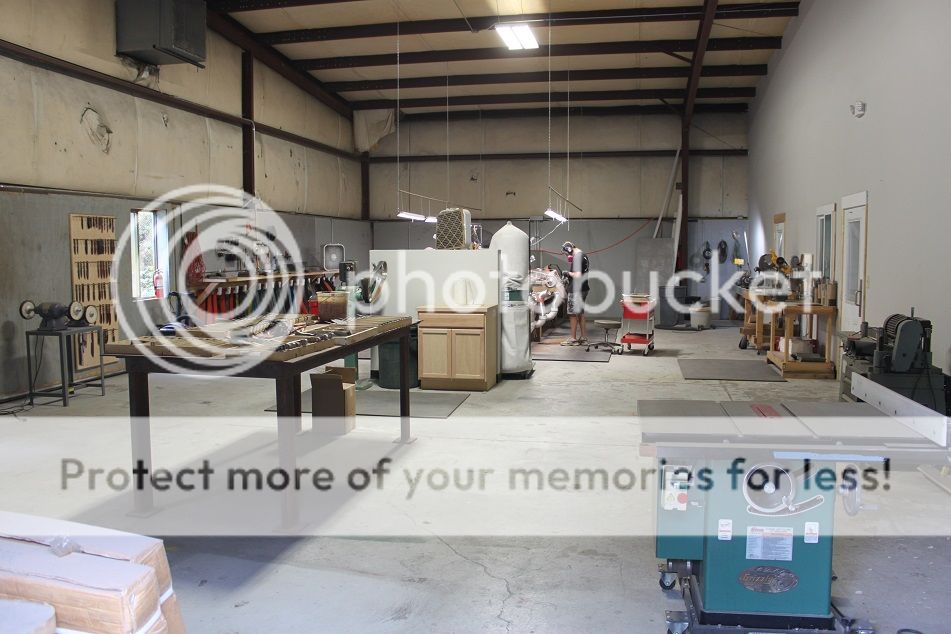

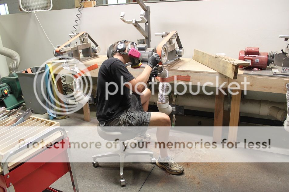

Looking in at the Grinder Room - prep table in foreground. Handle shaping/sharping area on right, blade profiling/metal work on left

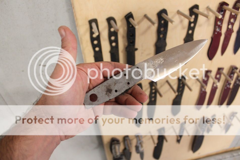

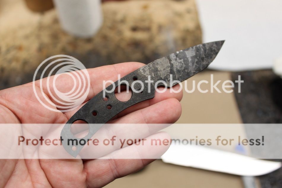

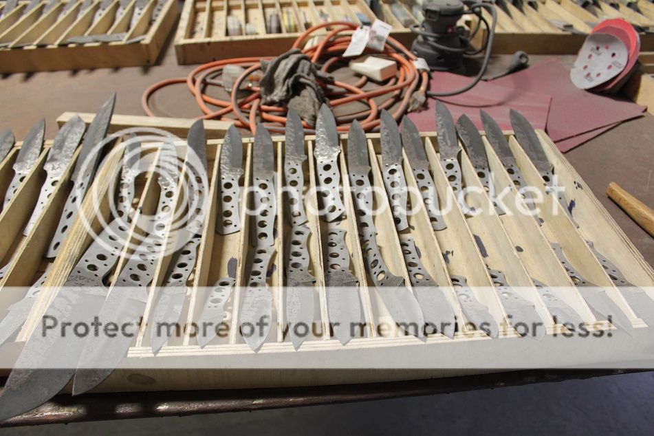

Blanks, blanks, and more blanks .. getting ready for the process

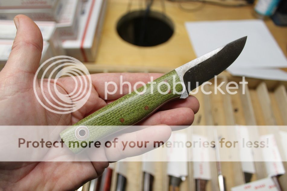

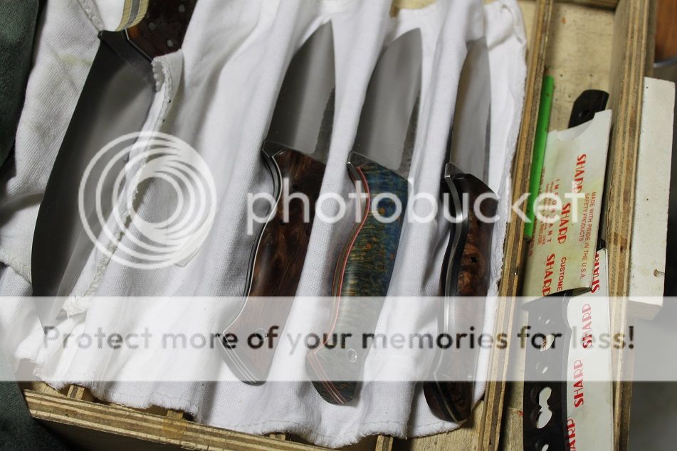

Osprey Knife & Tool Caddy

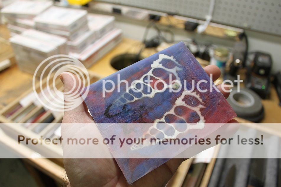

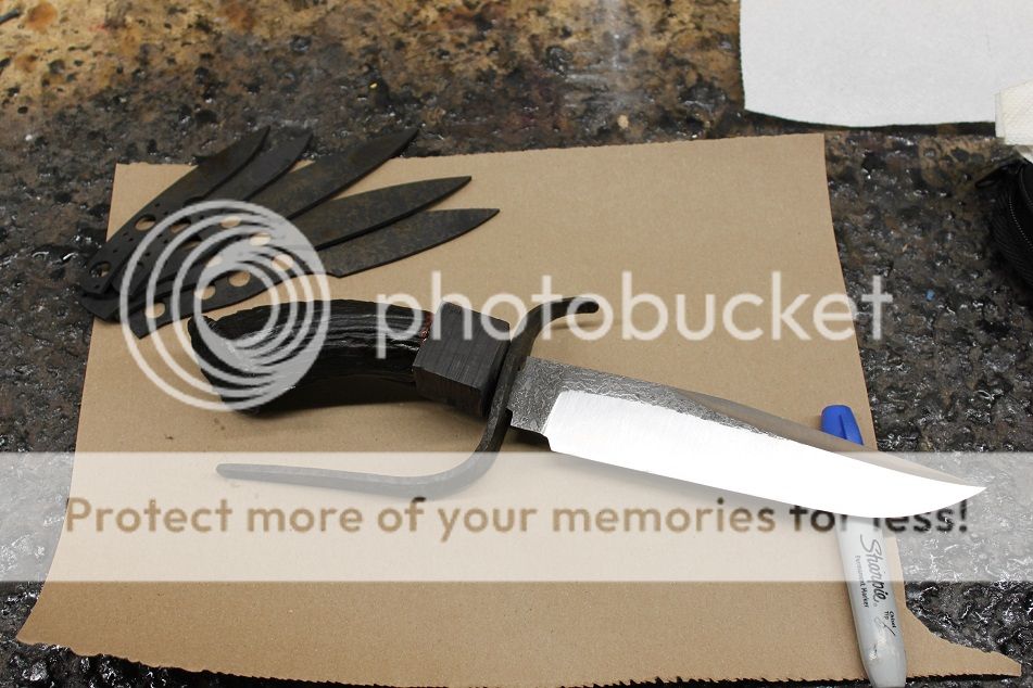

W.A. Surls's WIPs
That's a sea shell slice inside ..
Man, those Ospreys just keep getting better and better! (I suppose that's the point though :))

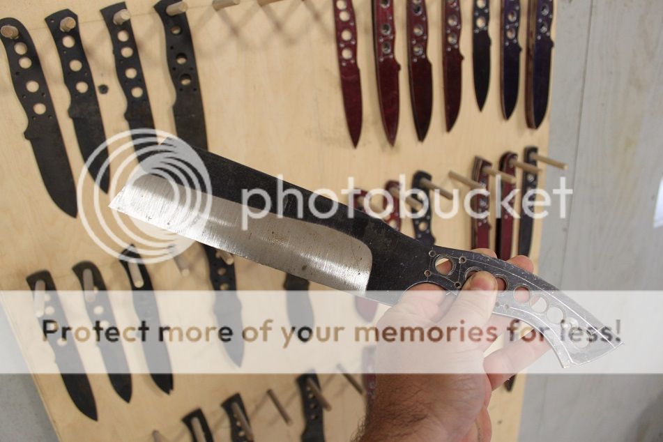

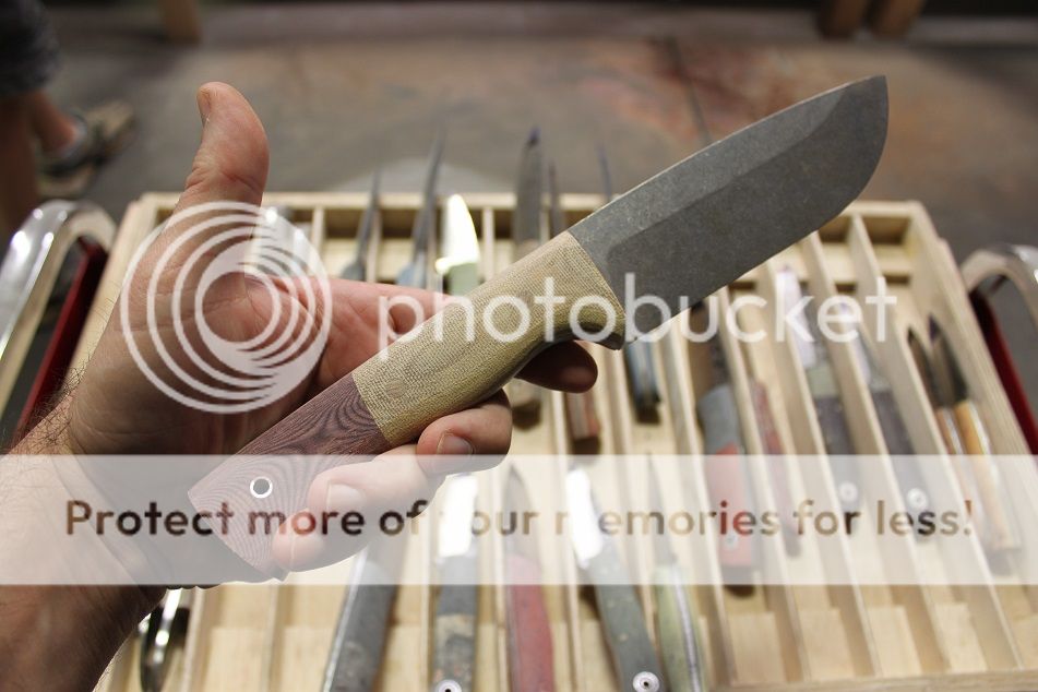

I will never EVER make another of these DAMNED Bow Legged Ugly Ass Choppers. I've lost two of the three we profiled after hours of time grinding the nerdy bastards. If this third one turns out it will go onto my man room wall and it will take more than $10K to tempt me to sell it. Its an ugly horrid design. I hate it on all levels. The pattern is closed. Never again.
ref: http://www.bladeforums.com/forums/s...hopper-SUCKS-ASS?highlight=bow+legged+chopper
However, maybe it looks a little smaller than a BLC and more a Chopped BL Chopper
I LIKE IT!!!! $Not 10K like it, but....

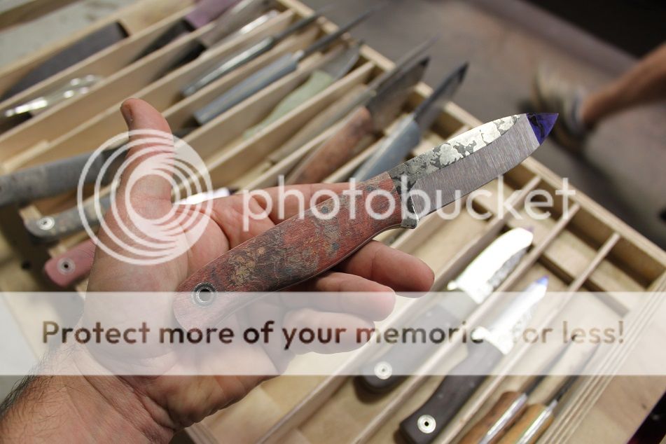

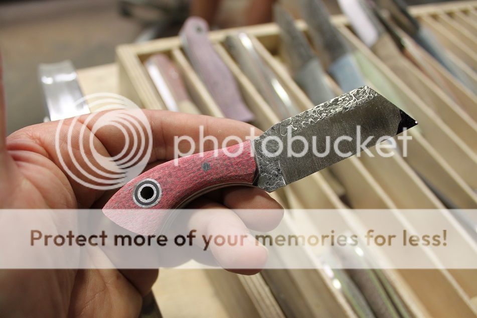

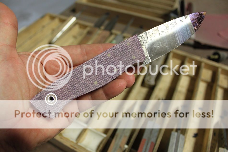

I hope this is a good enough place to ask, what is the purpose of re-dyeing the tip of the blade after the initial grind?
They do it to track where it is in the production process. Color initially has to do with type of steel (A2 is red dykem and 01 is blue dykem) but the finish tip seems to mostly be blue. I think it's a signal that they still need to do the finish grinds.
Blue Dykem is used on 01 Red is used on A2 Also A2 is also identified by an extra hole in the tang. Because after heat treat they all look the same. The dyed tip is Andy's way of telling he left off on 120 grit and still needs to take it up to the A100.
I adopted some of these techniques and made them my own as well, for example I use red for CPM154 as well as an extra hole. O1 and W2 are blue for me. I dont use the Dyed tip method because I usually only have 1 to 2 batches of knives going at once so its easier for me to remember what I have left to do.
I hope this help explain a little the reasoning behind the different topics discussed above
