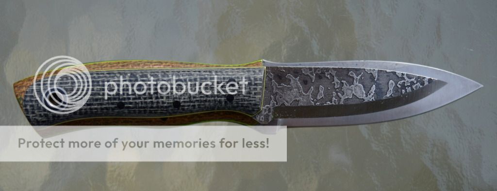

I have long wondered why the Sneaky Pete is not more popular than it is. Andy has said many times that he believes the Sneaky Pete has the most comfortable handle of any model he makes. When a gifted knife maker who is known for his amazingly comfortable handles makes that kind of statement, it should grab your attention.
I believe that there are a couple of reasons why potential buyers are somewhat confused by this model. First, the handle design is very unique compared to more traditional 4” handle designs represented by the Bushfinger, Recluse, Kephart, and Bushcrafter/Arete models in the Fiddleback line-up. It has a taller elliptical shape, particularly on the back end. , the unique handle design combined with a spear point blade makes it difficult to classify what role it is supposed to fill. Is it intended to be a last ditch self-defense weapon or an outdoors/camping/bushcrafting tool? I suspect that Andy may have been straddling the fence when he designed this model. The reason I say this is because my research indicates that this model was first offered for sale on 05/10/13 as the “Bushcraft Dagger.” That name clearly hints at a dual role. The model name was changed to Sneaky Pete after that first offering. This model went through one design change in July 2014 to add a large chamfer to the pommel end of the handle in place of the original sharp corner. I will comment more about this design change a little later into the review.

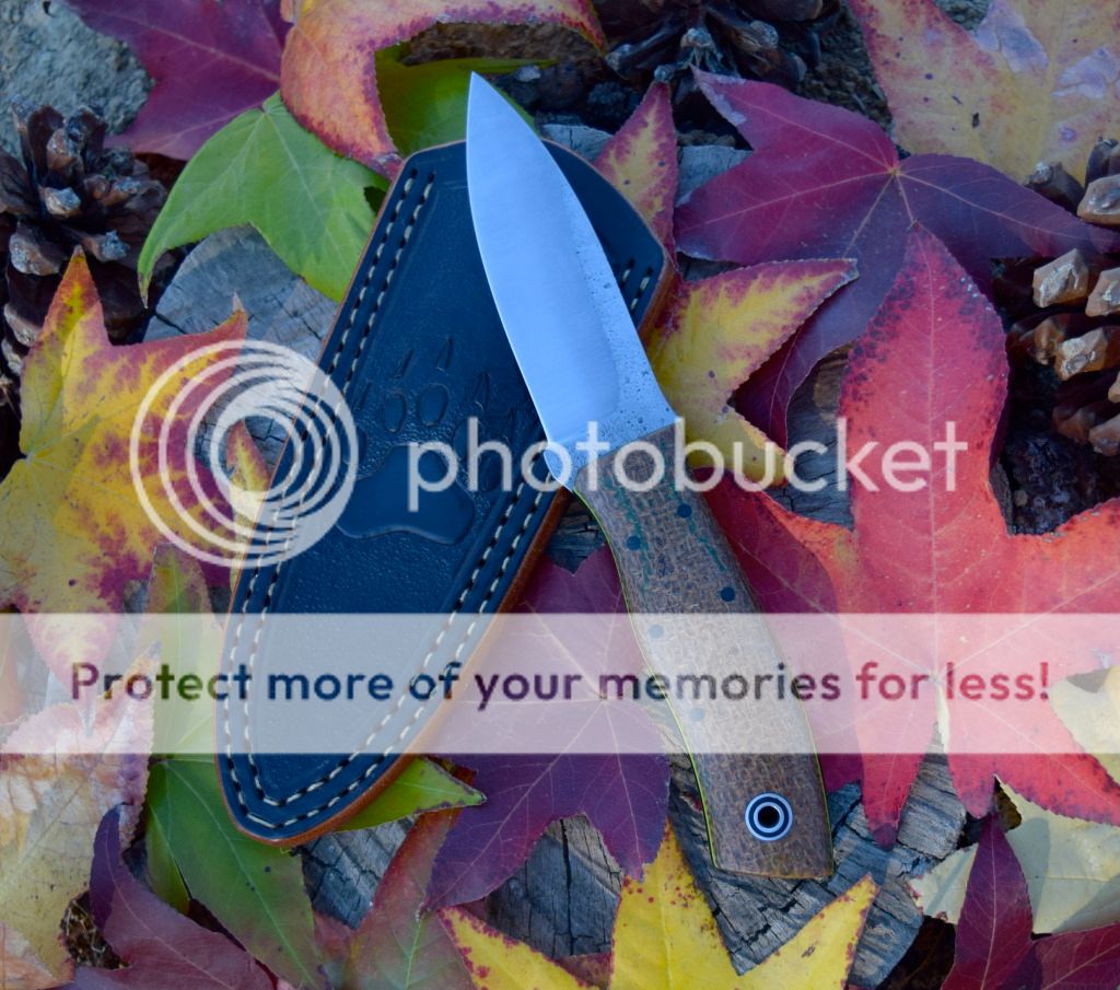

My personal Sneaky Pete was from the 11/01/13 FF batch. At that time, it was only my 2nd Fiddleback Friday purchase and my 1st knife with Shadetree burlap. This knife started a Shadetree theme to my collection that still applies today for the most part. Something about the design of the knife struck a chord with me. Even so, I stared at the photo below many times over a day-and-a-half before I pulled the trigger on it. Those were still the days when competition wasn’t as fierce as it is now and you had more time to think things through.
Specs:
FF Lot Info: 2013 1101 018
OAL: 8.498"
Blade Length: 3.980"
Handle Length: 4.518"
Steel & Thickness: .124" O-1 Tool Steel (Note: Originally advertised as 5/32”)
Tang Type: SFT (“skeletonized full tang”)
Grind: Convex
Handle Material: Coffeebag Burlap from Shadetree over black g10 with a lime green g10 pinstripe
Weight (oz.): 6.1 ounces
Blade Height @ Ricasso: 1.200"
Handle Width @ Palmswell: .775"
Handle Height @ Palmswell: .1.250"
Circumference @ Palmswell: 3.668”
Distance Front of Handle to Palmswell: 1.970”
Balance Point: .375” Behind Front Pins

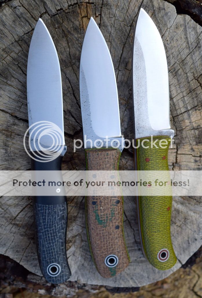

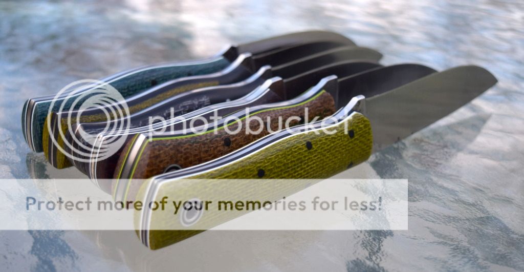

I like using "compare and contrast" type photos to show relative size and point out certain features and/or differences that may go unnoticed when viewing one knife alone. I tried to capture a good selection of knives and different views to emphasize certain characteristics of the Sneaky Pete (i.e. “SP.”)

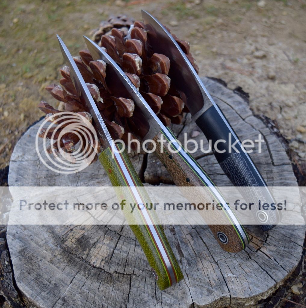

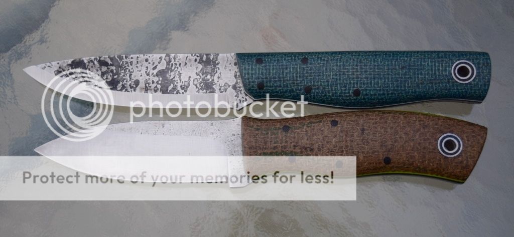

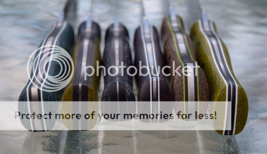

These are three different style handles in this group. The Patch has a relatively straight handle with a square butt. The SP has a noticeable “S” curve shape on the top of the handle going from the peak of the ramp to the top corner of the angled butt. The Hiking Buddy has a very slight curve on the top of the handle leading into the round butt.
This stacked view shows the differences in handle shape and height as well as blade shapes. The Patch has a relatively straight handle spine versus arched curve of the SP. That convex curve on the top of the SP handle feels really natural when it is nestled into the concave curve of the palm of your hand. Another difference between these two is that the Patch has a square butt versus an angled butt on the SP. Having the butt of the SP angle forward from top to the bottom certainly looks cool, but it comes at the expense available finger space on the bottom of the handle. I have found that the length and shape of the bottom of the handle is a more important measurement to me than overall handle length because it determines whether my fingers feel relaxed or cramped together in various grips. To emphasize my points, note that even though the SP handle is .400” longer overall than the Patch, the usable handle length on the bottom of the handle is almost the same with the SP being only .070” longer.
Another stacked view showing comparison of blade tip designs. The Hiking Buddy is a little more of a drop point compared to the spear point on the SP with the tip right on the centerline of the blade.
This stacked view of my Monarch on top of the SP shows the similarity in blade shapes with spear points positioned on the centerline of the blade. Both of these models also share relatively tall and slightly narrower handles compared to other models in their respective size ranges.

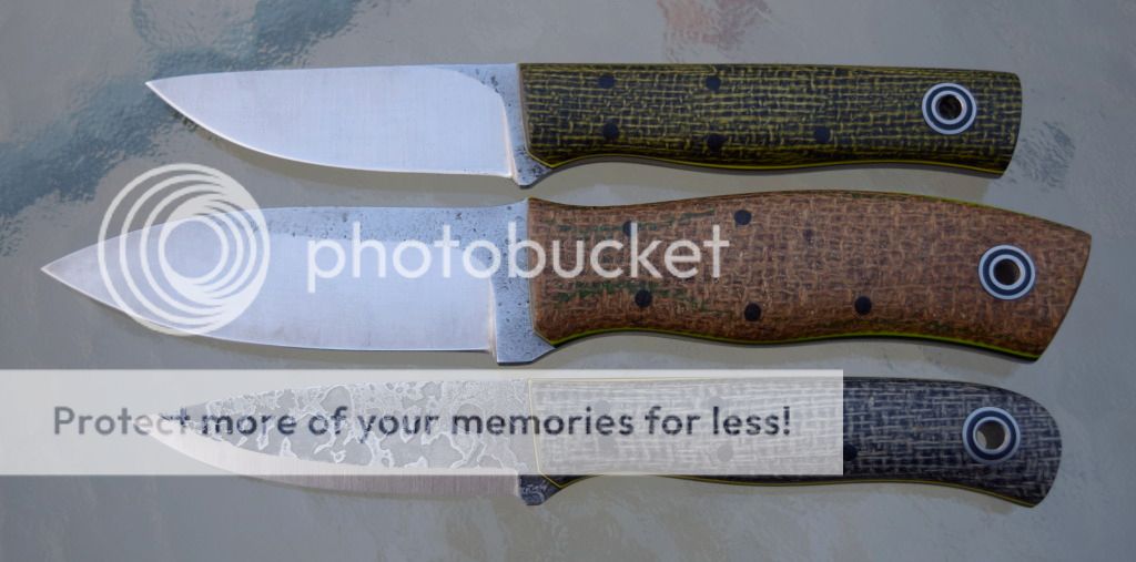

Here are a couple of shots to compare the SP & Terrasaur. The blade and handle lengths are longer on the Terrasaur. The blade and handle heights are taller on the SP. The center of the palm swell sits about .440” further back on the Terrasaur.
The straight handle spine and square butt of the Terrasaur looks starkly different than the flowing curves and angled butt of the SP handle. The Terrasaur has about .450” more finger space on the bottom of the handle than the SP does, but the tall narrower handle on the SP provides unmatched torque control and pinkie finger leverage compared to its rivals in the 4” category.
Here are a couple more photos that show the tall handle height of the SP in comparison to some other Fiddleback models. Besides the superior torque control I already mentioned, the height of the handle on the SP at the butt end does something that other models don’t do as well. It gives your pinky finger a feeling of power and leverage instead of just providing a place to rest it. Let’s face it, the pinky is the weak link in gripping control to the point that many makers and users discount its importance in actual use. You can see that in the popularity of three-finger knives that leave the pinky out of the party altogether. That is the compromise you make to get smaller size. On a full size 4” model, the ability to have all four fingers working evenly together is a powerful combination. The SP handle provides that feeling to me better than any other model in this size range.
L to R: Terrasaur, Recluse, Arete, Monarch, Sneaky Pete & Leuku

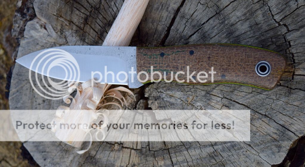

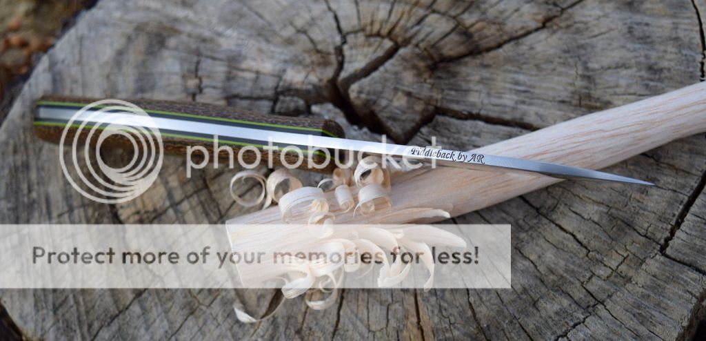

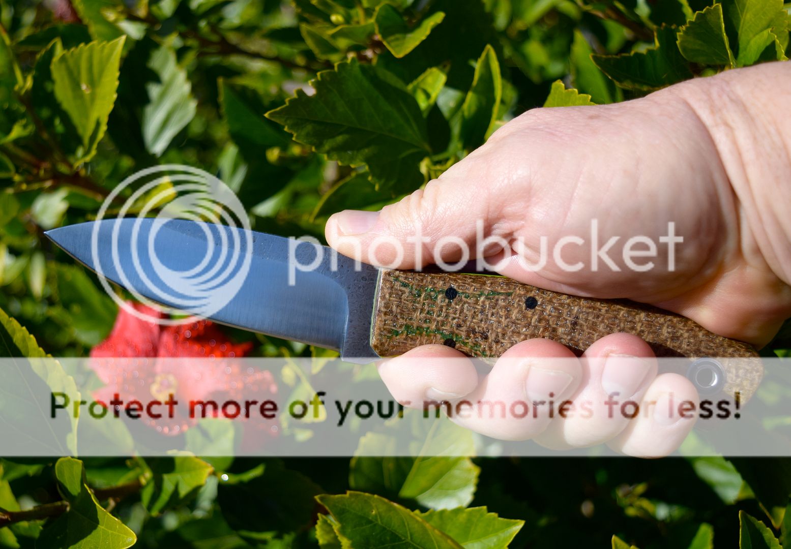

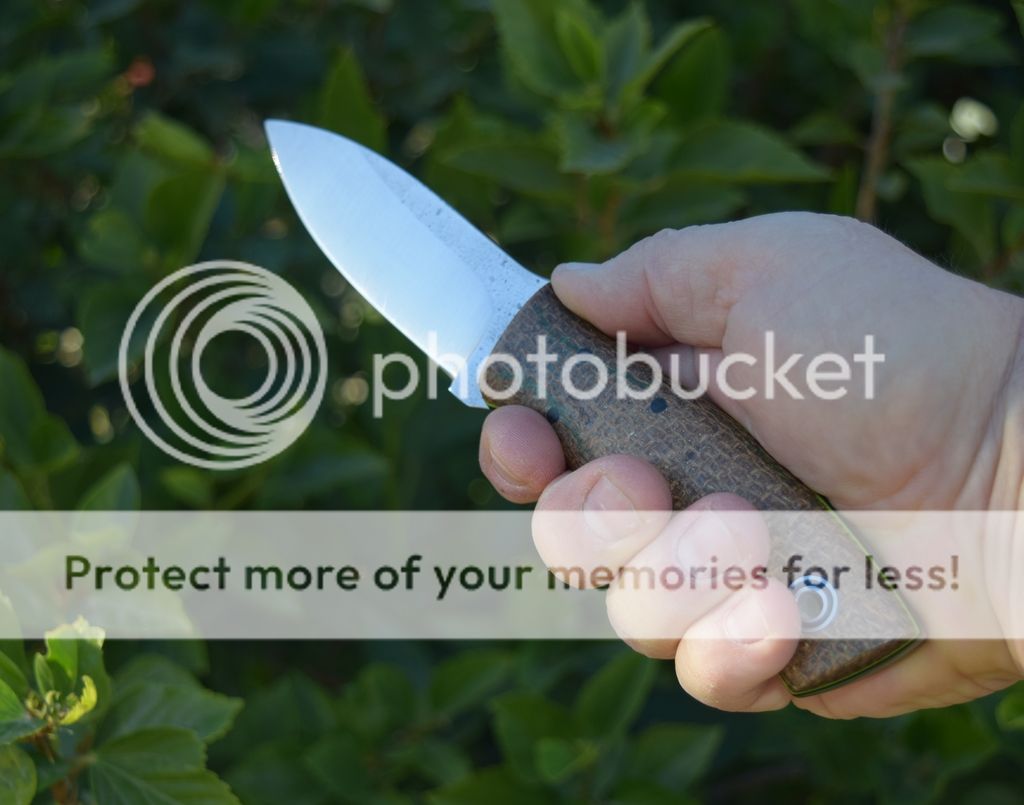

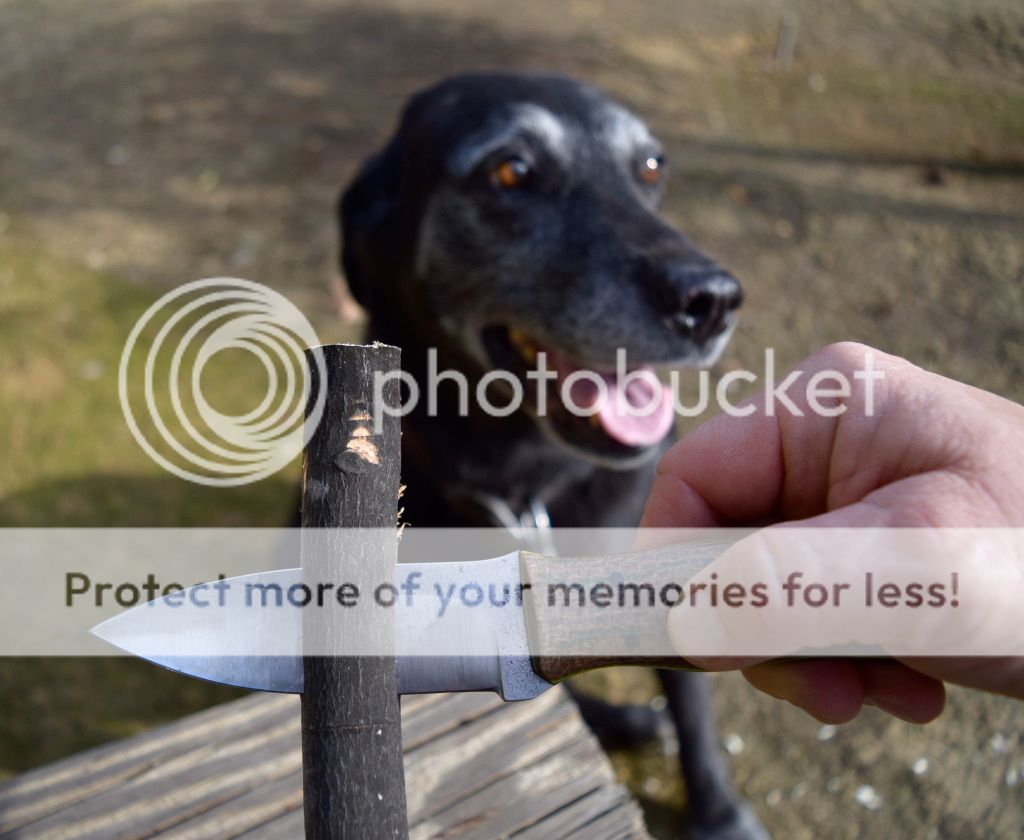

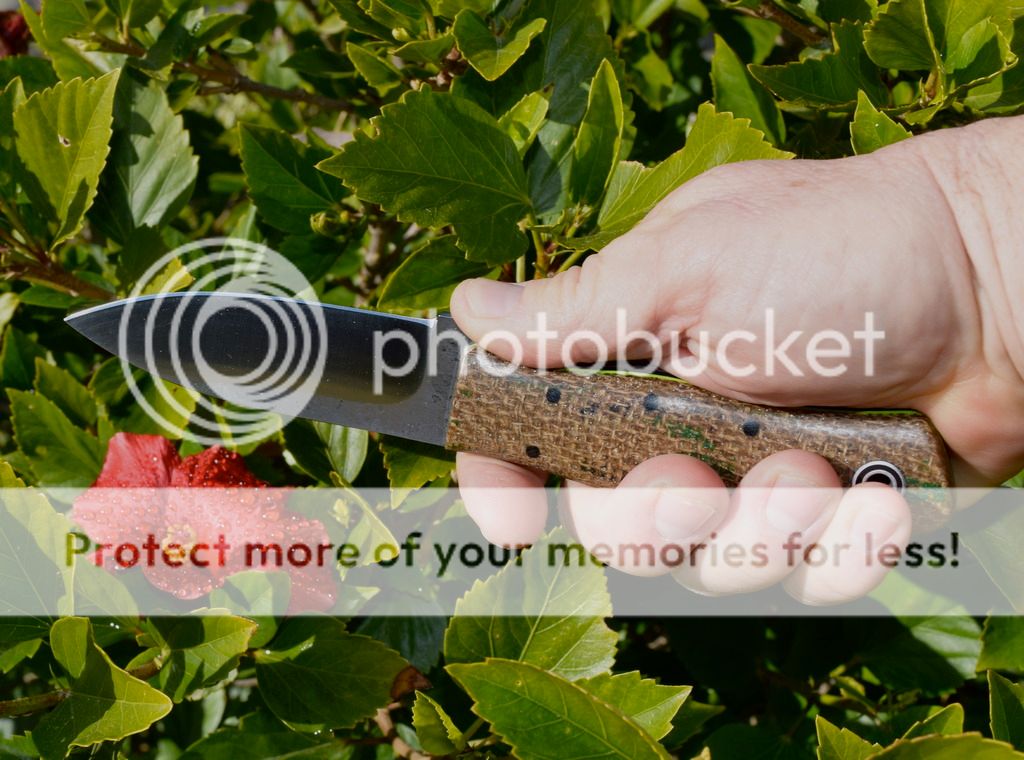

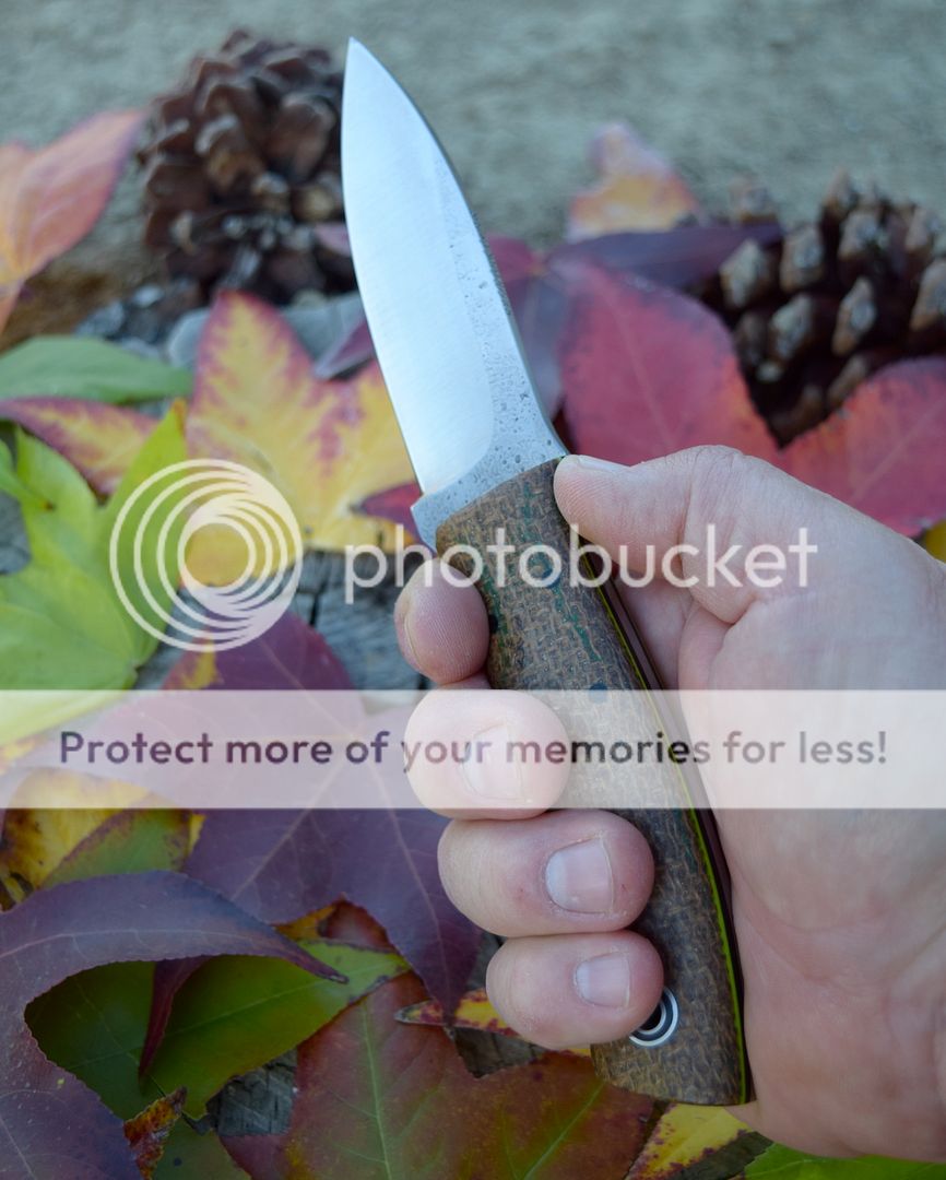

From a user’s perspective, there are several design features of the Sneaky Pete that I really like.

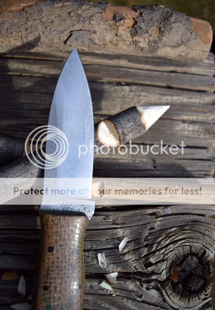

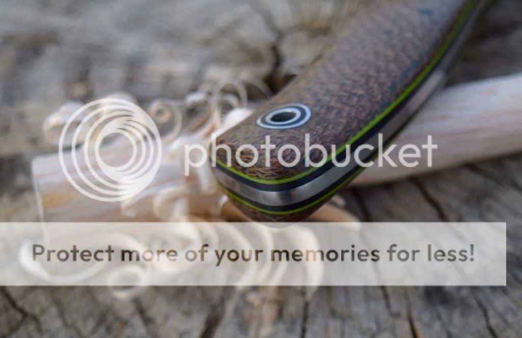

The great torque control from the tall oval handle is very much appreciated when whittling, notching, or splitting wood for kindling.

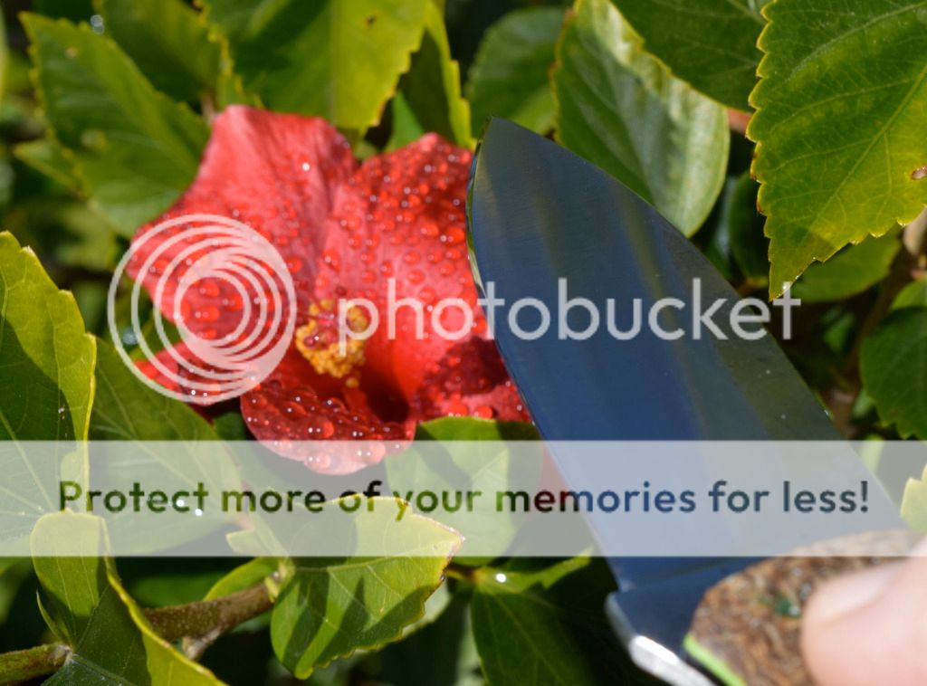

The spearpoint blade with a perfectly centered tip is excellent for drilling.

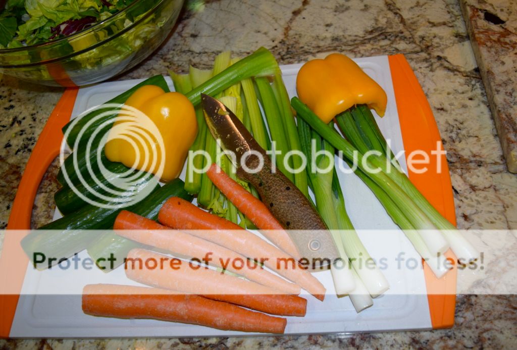

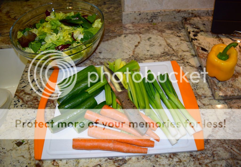

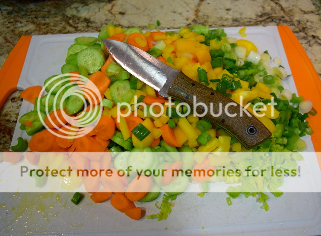

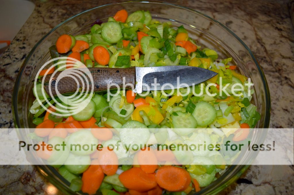

The handle shape works very well in the kitchen also. The curve on the top of the handle that settles into your palm makes this model feel more natural to me for food prep versus some of the more straight handled models.
The centered spear point works great for coring or removing stems from things like peppers of strawberries.
The handle feels very secure in hand even when wet.

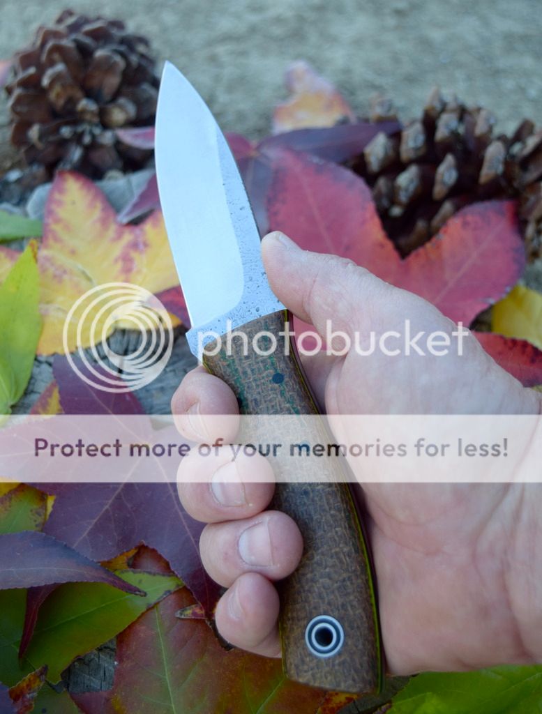

Andy’s handle description of “feels like a handshake” rings very true to me especially when I am using this knife for food prep.

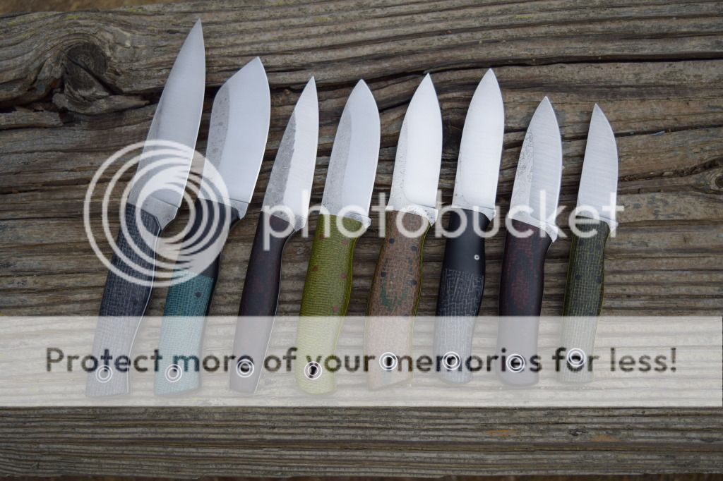

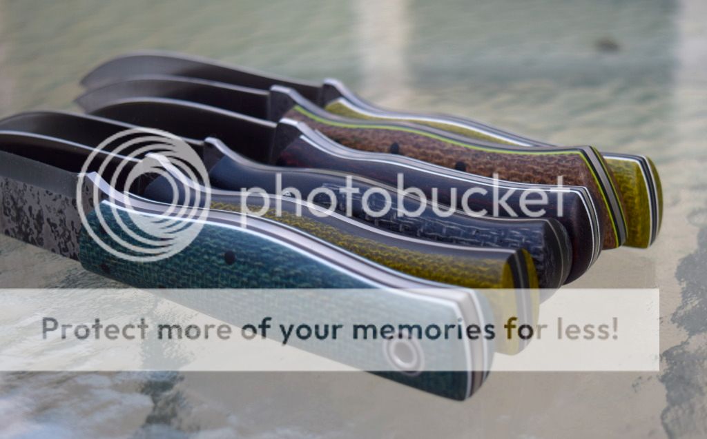

I have ten Fiddlebacks that form my primary user group, including the SP. Here are eight of the ten. The two that are missing from this photo are the Leuku and Hiking Buddy.
L to R: Woodsman, Camp Nessmuk, Gaucho, Bushcrafter, Sneaky Pete, Arete, Monarch & Patch.
Within this group, some of these knives are used frequently, others pretty regularly, and one not as much. The Sneaky Pete has been the “not as much” knife for me. Read on and I will explain why...

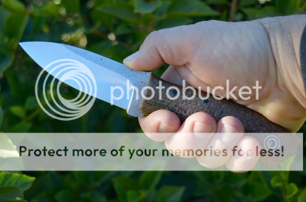

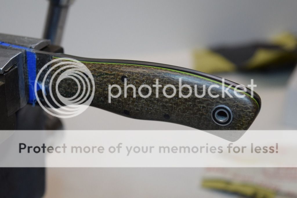

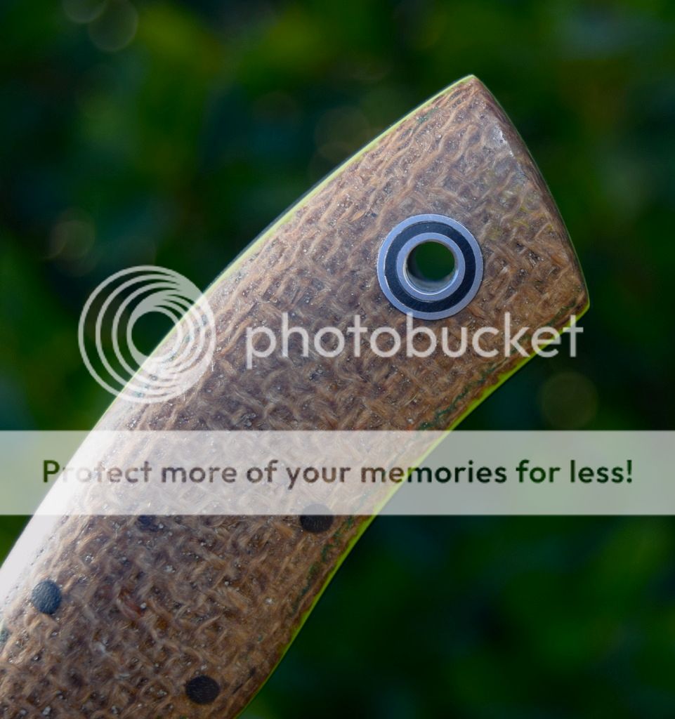

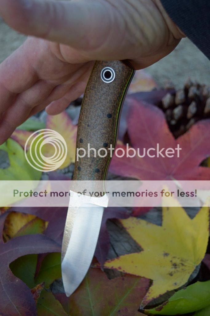

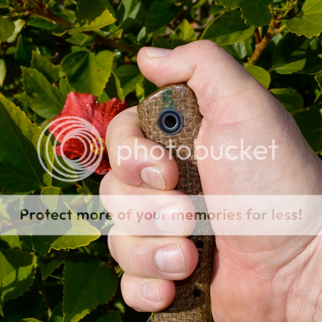

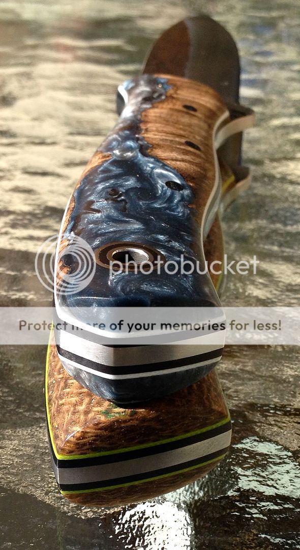

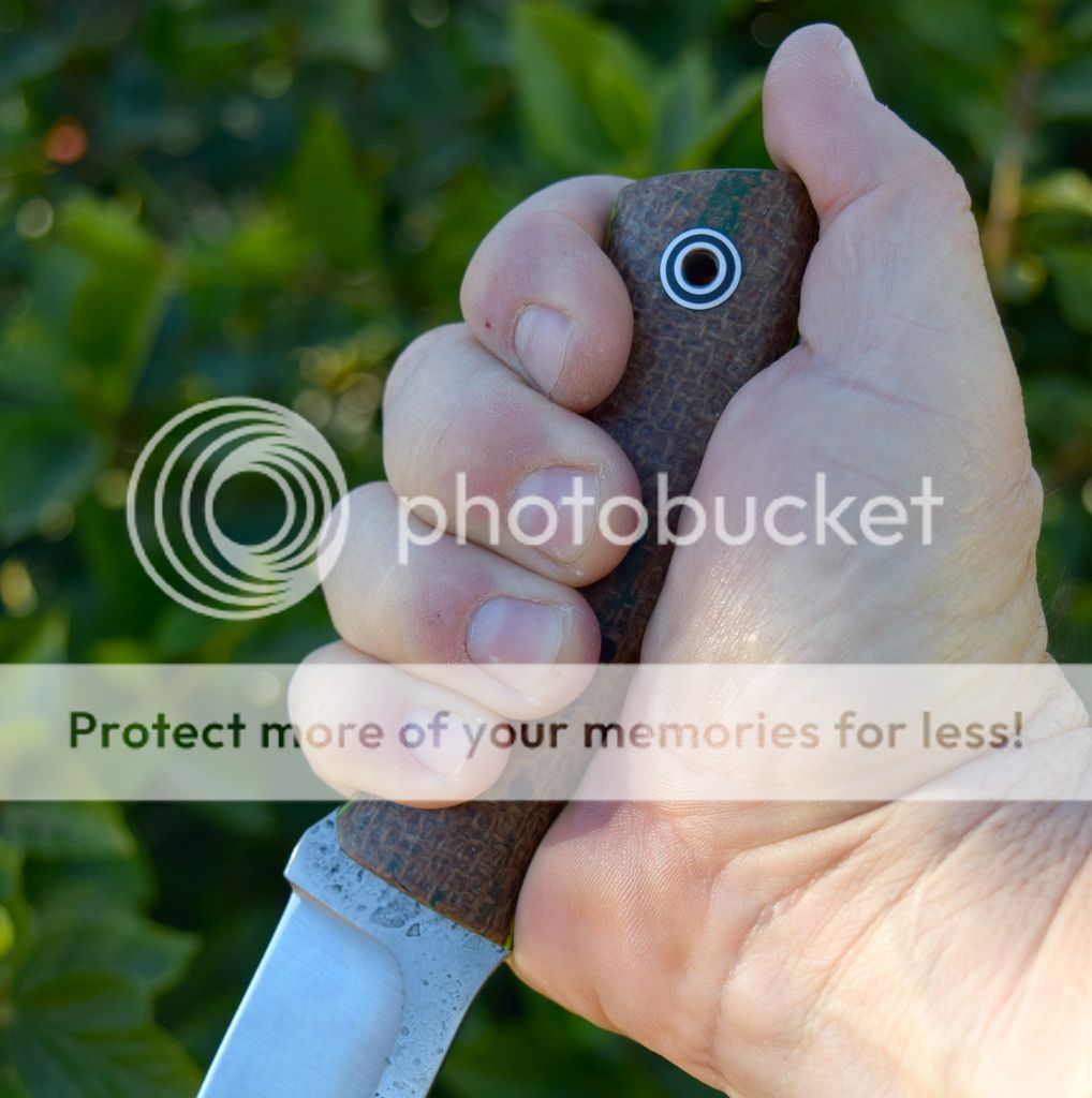

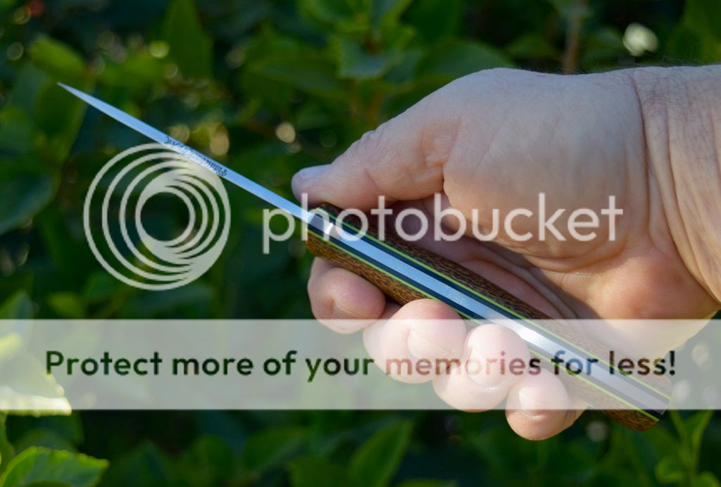

Here is a spine shot showing the pointed top of the ramp...
The sharp point of the ramp is right under the pad of my thumb.* This is the spot where I would normally press down for leverage while making certain cuts...
Moving the tip of my thumb behind the ramp apex does not allow as much leverage as using the pad of my thumb.* If I slide my hand further back on the handle to fix that, the rear point of the handle becomes an issue by poking into my palm.
Moving my thumb in front of the ramp provides a little better leverage, but the ramp apex is still poking the pad of my thumb.

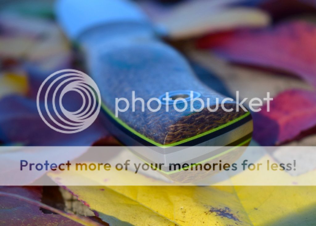

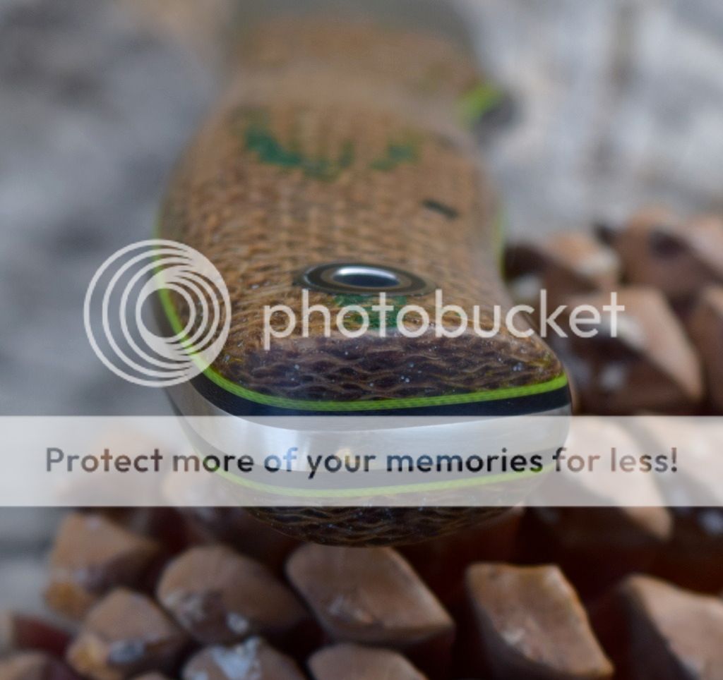

The pointed corners on the end of the handle are uncomfortable pressure points in certain grip applications.
To be fair to Andy, I want to emphasize that my knife was a 1st year production model and the July 2014 handle re-design that added a large chamfer to the top of the butt corrected some of my concerns. The two angled flats are certainly an improvement, although I would have preferred a curved butt as a better option. Maybe not as sexy as the two flats, but more comfortable in any grip.

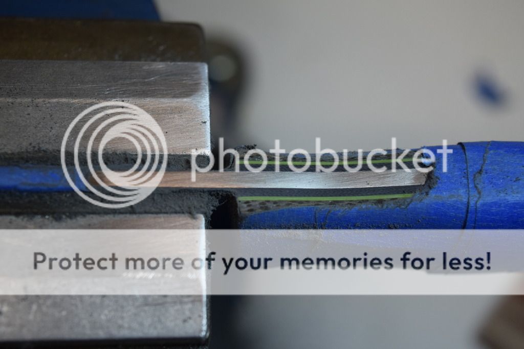

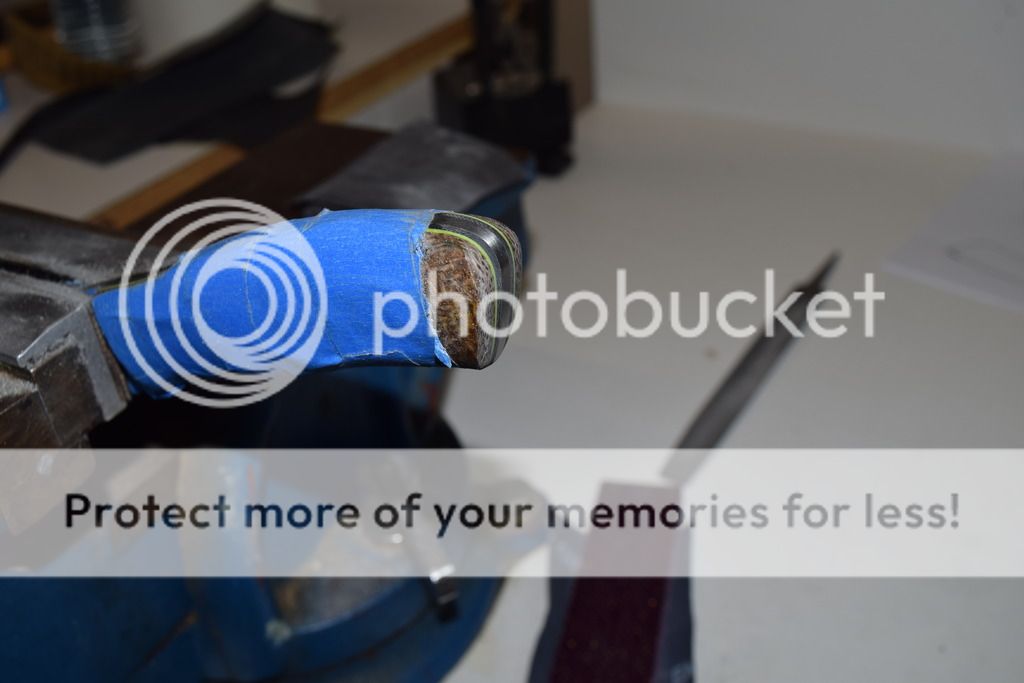

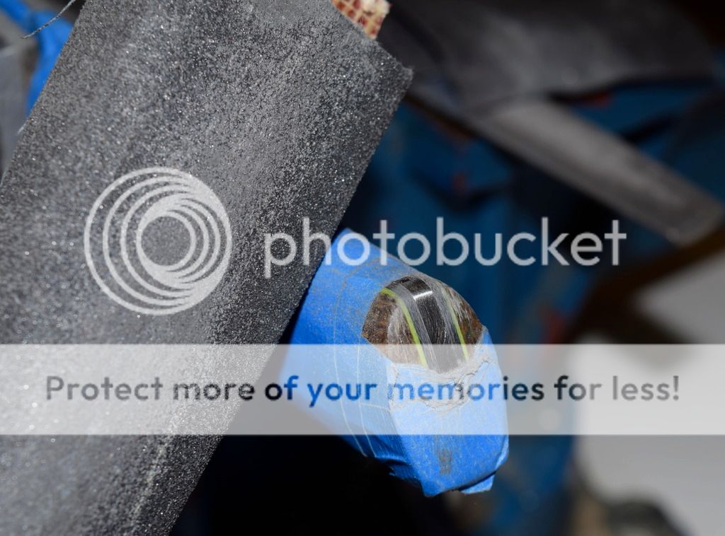

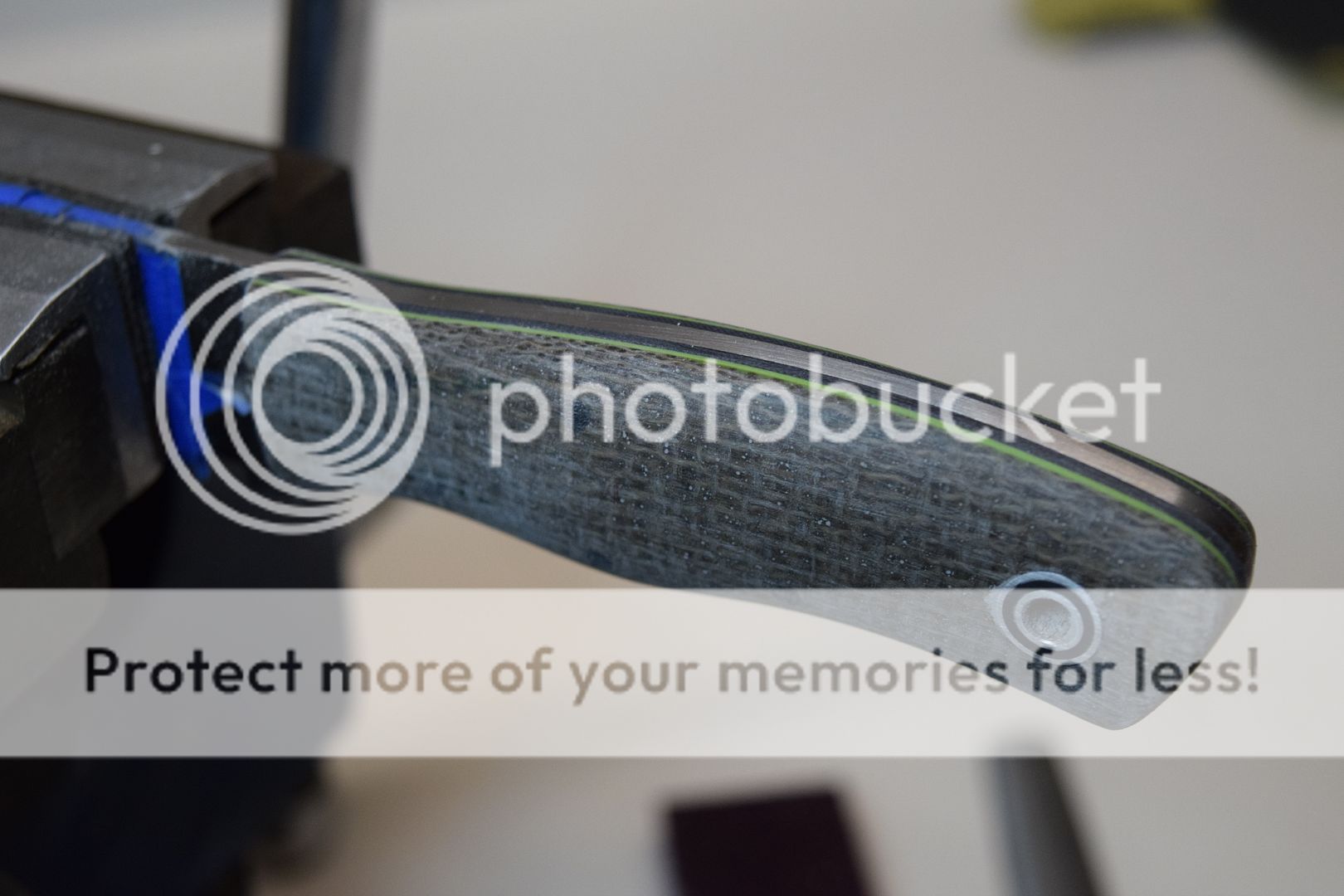

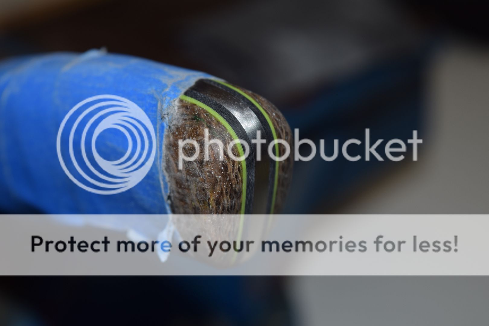

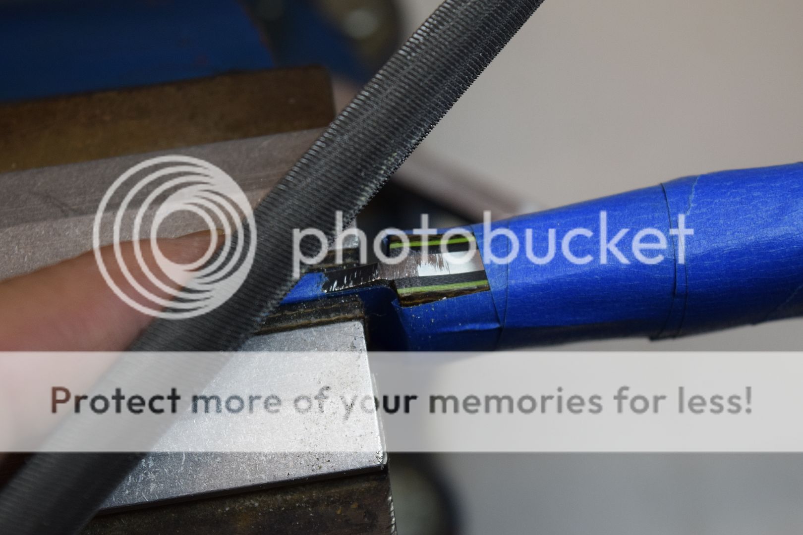

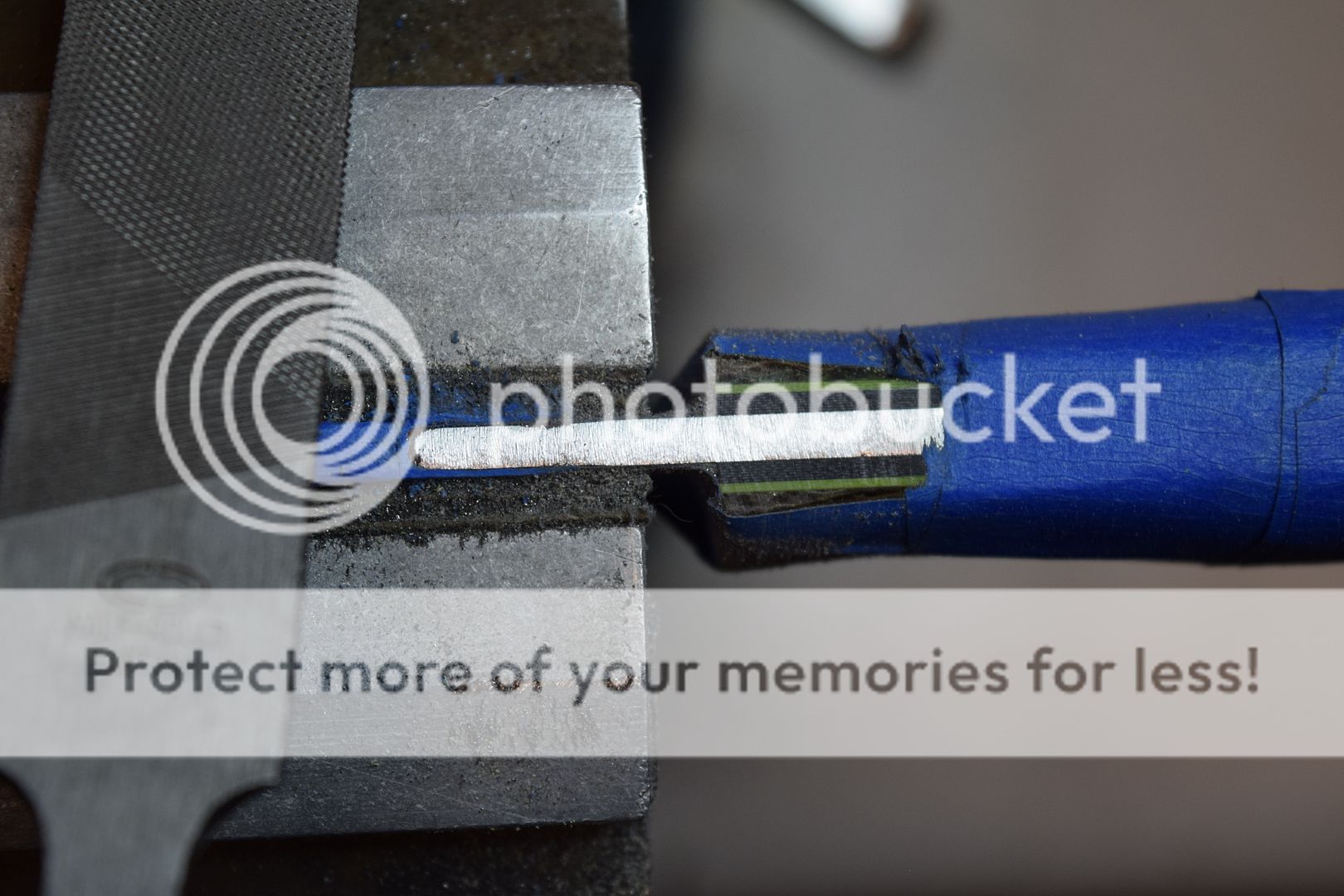

My modification plan was to remove the ramp and top corner on the handle. I also wanted to form a curved butt and soften the sharp corner on the bottom of the handle.
Even though I work as a quality manager in a well equipped aerospace machine shop with a lot of precision grinding equipment at my disposal, I decided to do the modifications the old fashioned way with files, emory cloth and sandpaper. I did it this way for several reasons. First, it doesn’t generate heat that could ruin the temper of the steel. Second, it is easier to control and monitor the results when you are slowly removing material. The last reason is that I still find it more enjoyable to work with hand tools whenever possible.

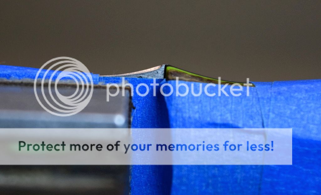

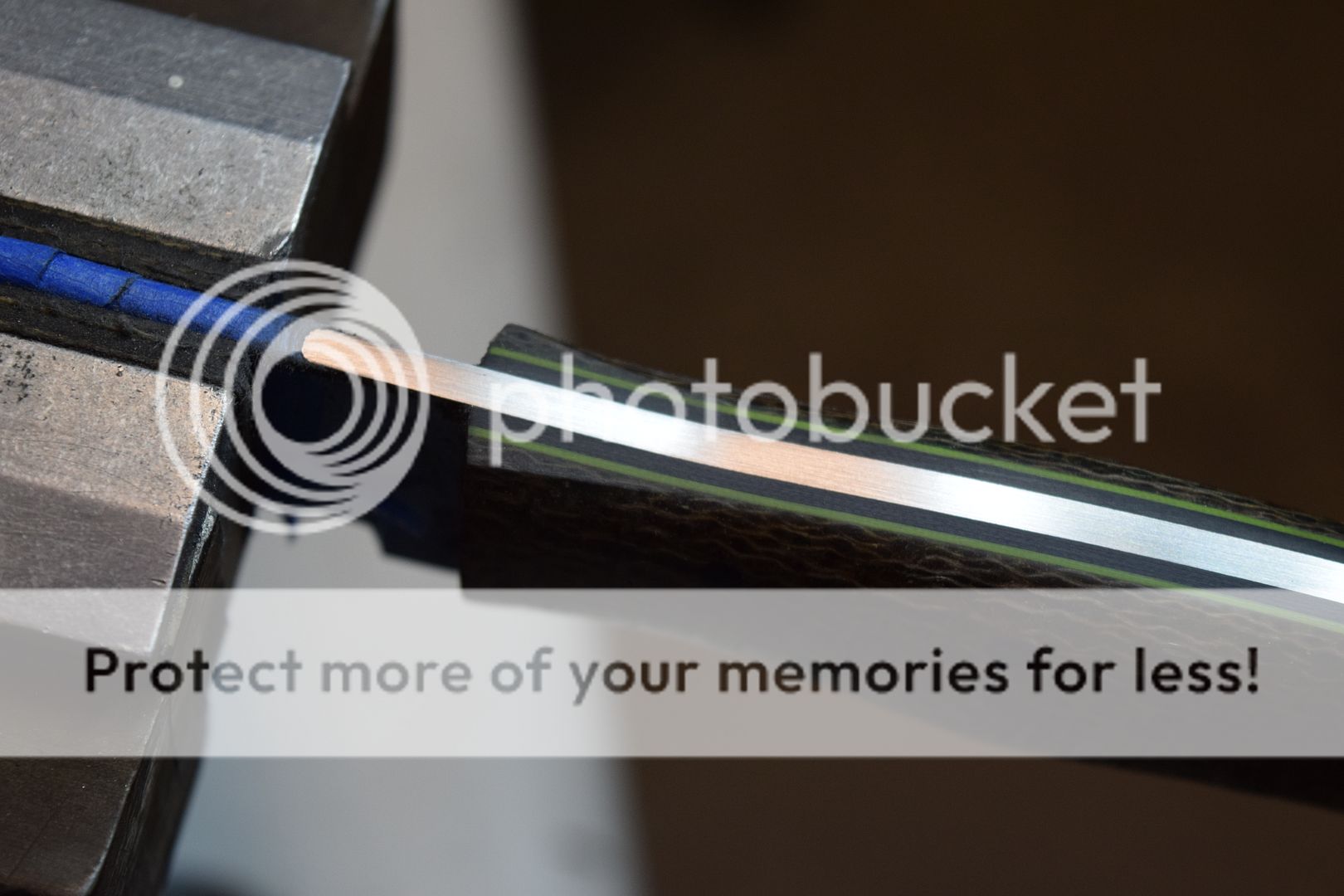

Here we go. I wrapped the blade and handle areas that were not being touched in blue painters tape to protect the finishes. The knife was held in rubber-faced aluminum vise jaw inserts.
This is the ramp area to be removed...

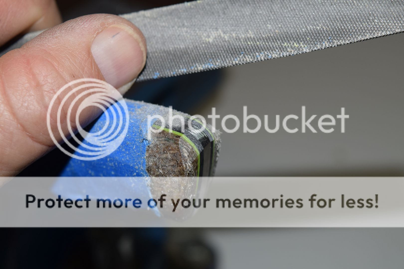

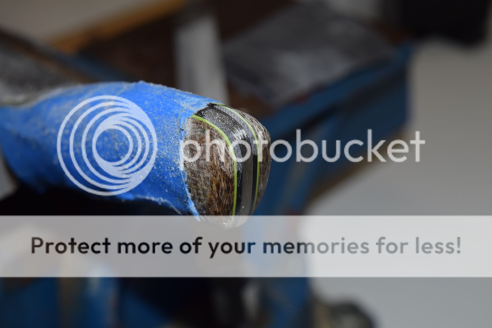

The metal on metal noise of the first few file cuts reminded me of the feeling I get sitting in the dentist chair and wondering if the novacane is going to work at the second the drill first touches a tooth. It also drives home the reality that I am taking a file to my $300 +/- knife and there is no turning back now.
Bye-bye ramp...
Starting to blend it out...
I used only medium emory cloth to round off the bottom corner of the butt because I didn’t need to remove a lot of material to create a softer radius.
Next is the top corner of the butt. Back to the file for this area.

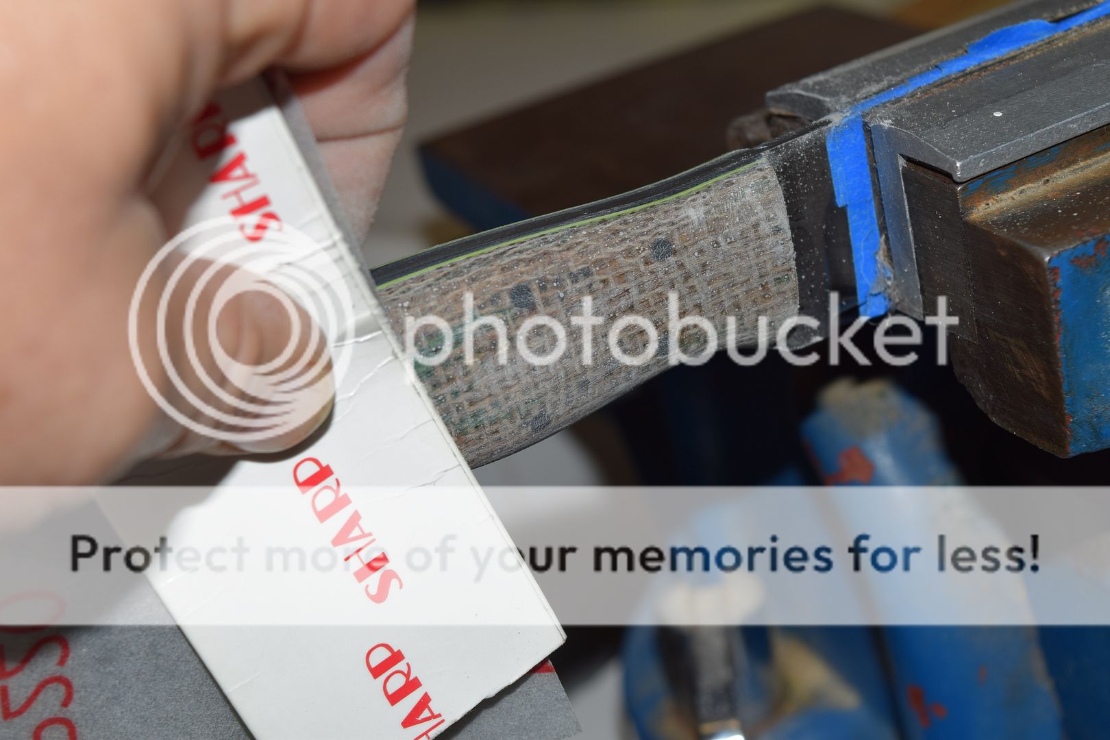

On to some hand sanding to remove the file marks and progress to nice smooth surfaces.
Notice the flats created on the handle scales adjacent to where the ramp was removed. These were reshaped later with sandpaper to blend with the existing curves on the front.
Might as well do a full Spa sanding while I am at it. The cardboard edge protector proved to be an adequate backer for the sandpaper to keep the form of the handle right.
More sanding and it is starting to look like a finished handle again.

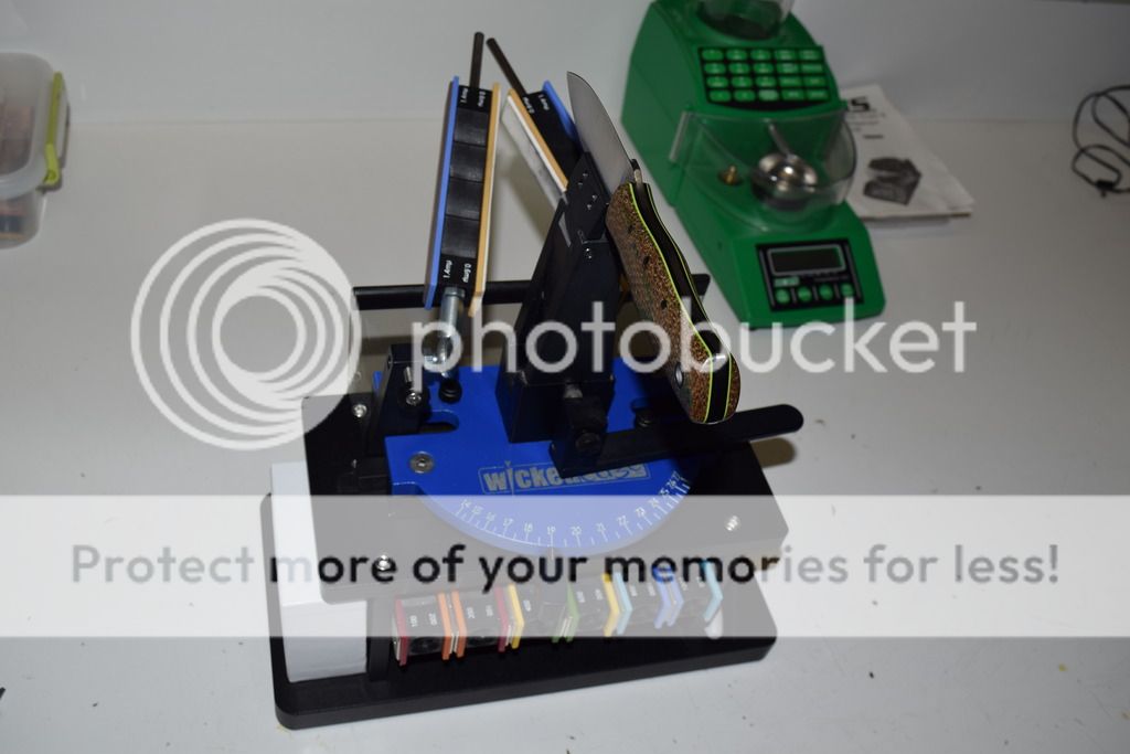

Time for a little Wicked Edge sharpening work. Since I am new to using this system, I sought out advice from a more experienced Fiddleback forum member who uses this sharpening system. I asked Walt (“McVeyMac”) what angle he recommends for O1. He said 18-20 degrees per side, so I split the difference and went with 19 DPS.

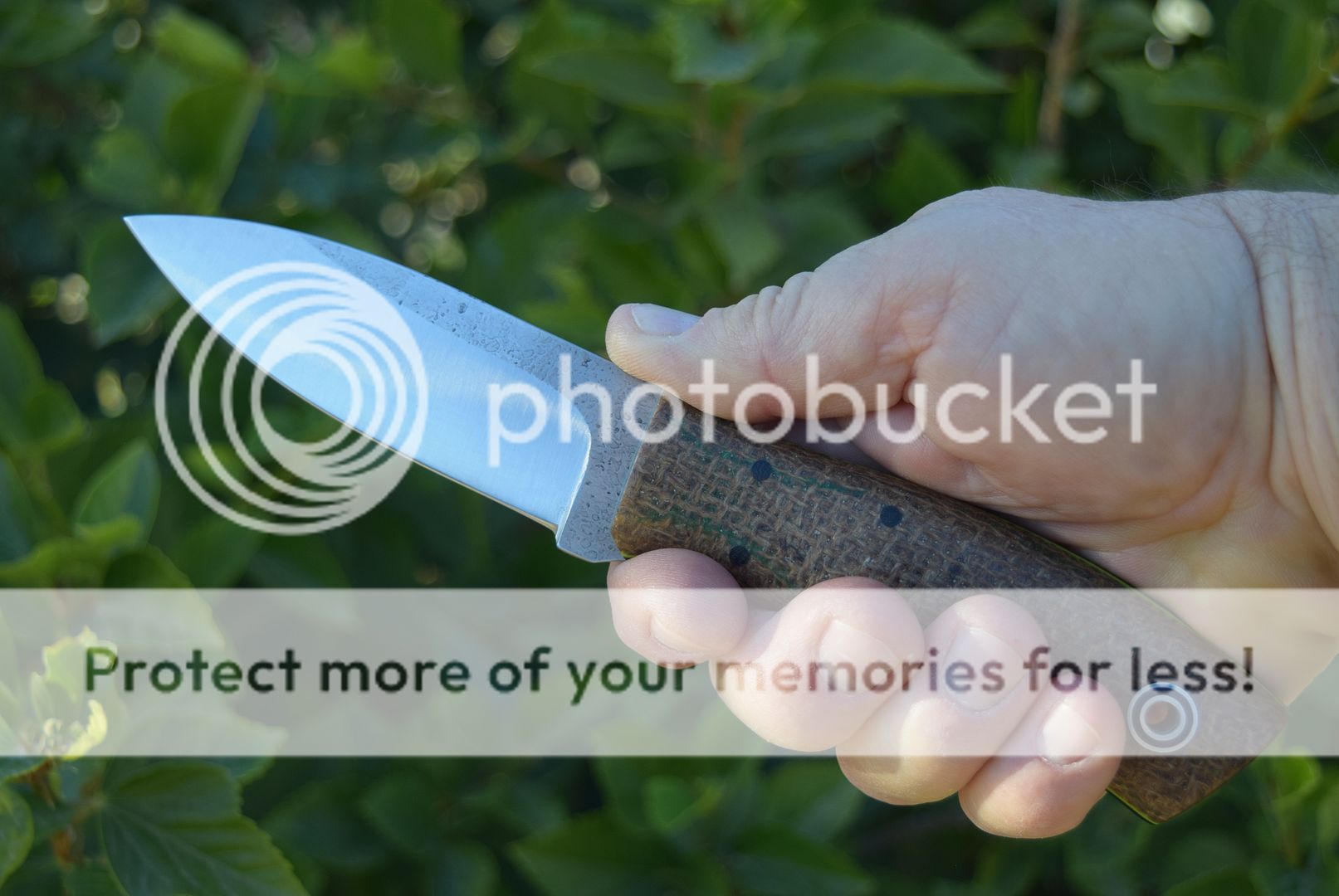

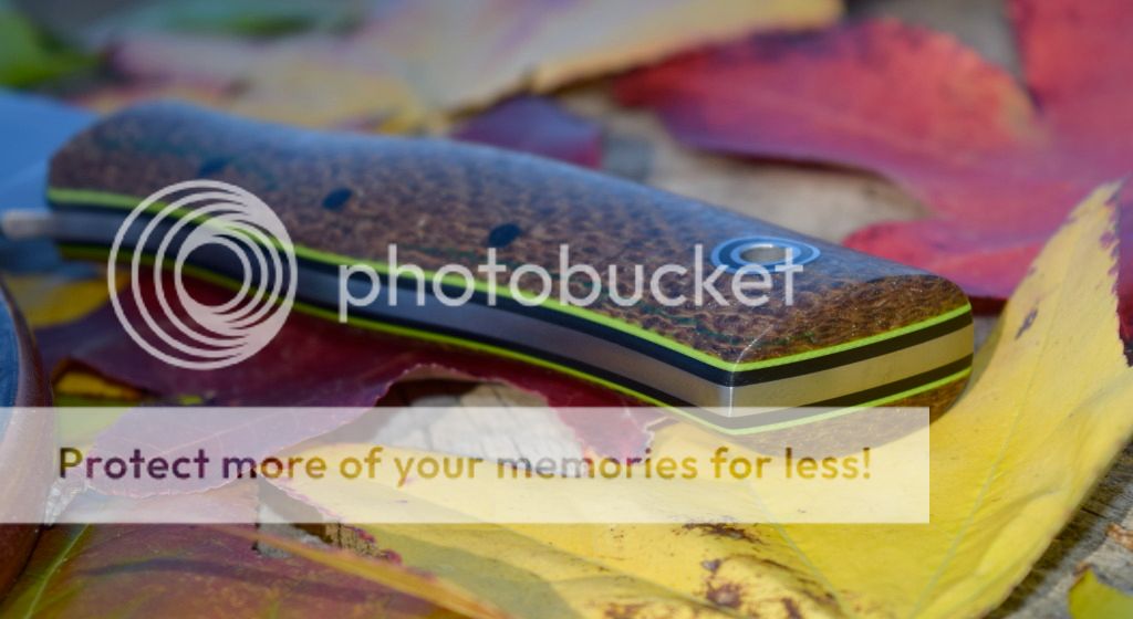

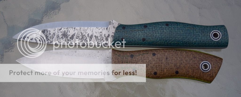

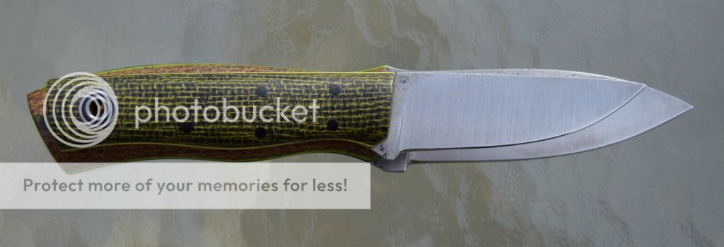

Here are some before and after photos to show the transformation.
Before:
After:

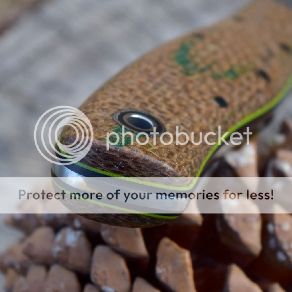

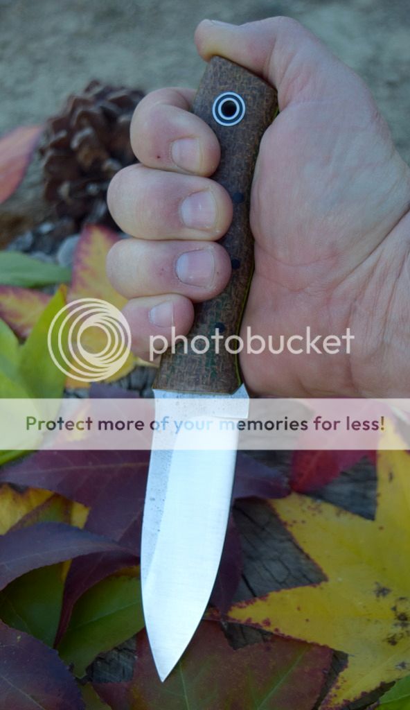

The curved butt of the handle is very easy on the hand now with no pressure points to work around...
No more pointed ramp to poke me and limit my thumb positions and leverage on push cuts.
And a crazy nice new edge on the blade.

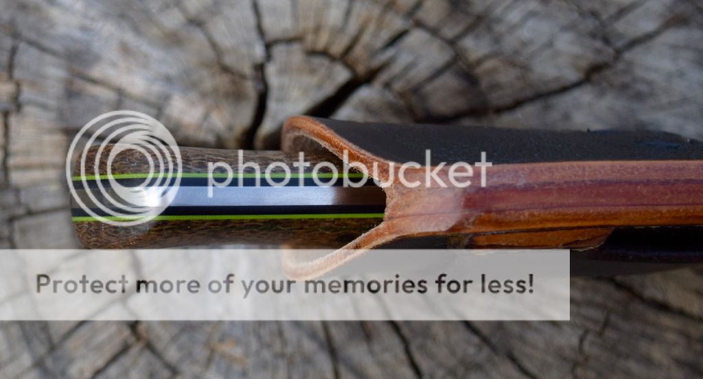

The new butt shape is very comfortable riding in one of Bud’s JouFuu high ride ambidextrous sheaths.
I like how flat the SP rides compared to knives with thicker handles.

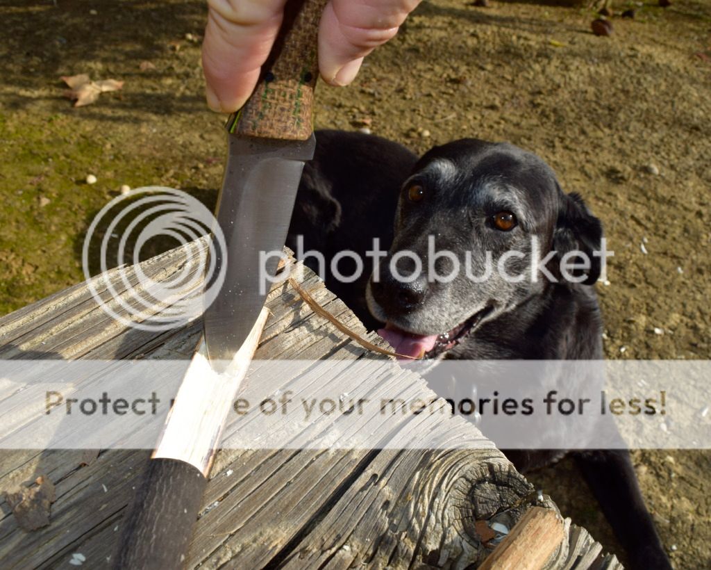

Of course J-Dog had to weigh in and inspect my work on the final product.
Ahhh, the look of approval from my best friend. It doesn’t get any better than that. She knows that when I am happy with a field knife, it means we will get to spend more time outside together doing fun stuff. Well J-Dog, it looks like we will be doing just that.

I have two questions.
1. How do you view the handle of the Nessmuk? It seems to share some of the swoopiness of the SP and that forward hump, (which I confess I am attracted to but never handled).
2. On your process, I'm surprised you were able to remove the forward hump with a file. In my first years of retirement, I hung 20-30 hours a week in a Cali, Community College, machine tool program. We were taught, and it was demonstrated anything above about rockwell 45, (as I recall the #) was not to be machined, but taken to the grinding room. In fact, we were taught to use a file when grabbing a piece of steel of unknown heat treat. If the file slid off it was above 45 and therefore a conventional "high speed steel"/carbide end mill or file wouldn't touch it. The Forge's heavy use of belt sanders speaks to that, given how hard these blades are. What sort of file did you use?
Thanks for the comments and questions Tom.

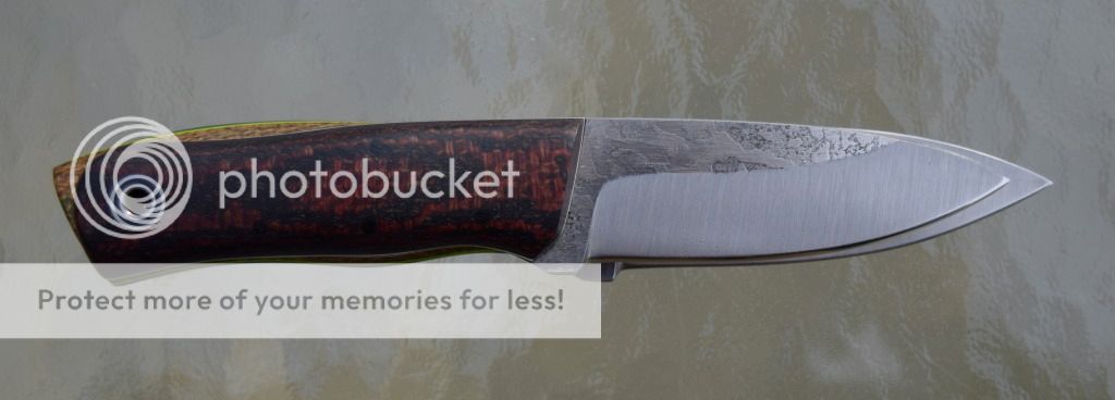

In response, here is a photo of the pommel end of two Nessmuk handles owned by my friend Phillip (M4Super90.)
I got to handle both of these last year during a visit with him last year. We shared our thoughts on this model as well as many others in a thread called “Arizona Knife Show and BBQ.” Here is the link if you care to read about it:
http://www.bladeforums.com/forums/s...zona-Knife-Show-and-BBQ?highlight=Arizona+BBQ
The bottom line is that we both strongly preferred the comfort and feel of the rounded pommel Buckeye Burl knife on the right vs. the angular shape of the Emerald burlap pommel on the left. Note that the Buckeye Burl knife is an unmodified version made in 2013 and Emerald burlap knife shows the standard pommel configuration that has remained the same since 2014.
My preference is for more soft handle characteristics and no thumb ramps on the spine. I can’t say what will work best for you, but my preference is for the larger Camp Nessmuk in tapered 5/32” steel over the lighter and smaller Nessmuk with the ramp.
