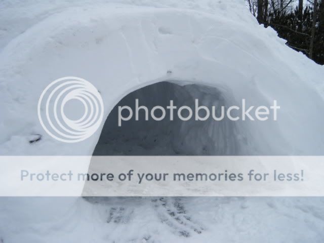

Jack Frost came again, and re-transformed my new abode into a winter wonderland. The locals say it hasn’t snowed this bad in 10 years, we must have brought it with us. The new house I live in is fantastic, but since I’ve moved in (less than a month now) with the new wife (mental note: Never introduce your wife as “your first wife”), I have not been able to crash outside yet. With the 18 inches of snow freshly bedded down Friday night, I had the urge to go outside and “play”. I decided to try out snow cave construction skills. I have not built and slept in a Snow cave for about 10 years, yet I’ve learned a lot since then about the intricacies of the white crystalline boogers that pour from the sky.

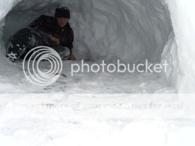

The first step was piling up the snow. Luckily, I had the fortunate happenstance of a whole driveway full. So while I busily scraped the drive way, the better half though I was diligently working. Piling up snow, lightly packing, piling up again, I worked until I had a roughly 6 foot dome. I let the snow set up and sit for roughly 2 hours, then went to digging it out. Now I tried to plan where I wanted to enter properly, and about where the tip of the shelter would be. Tunneling like a rabbit, with a combination of combing the inside with my waterproof gloves, I hollowed out a shelter 6 feet wide and about 3 and ½ feet height. It is a large area to heat up but I wanted to be able to fit more than person in there. I packed snow on the ground of about a foot, and used the cold steel trail hawk (thanks Sergeant Josh!) to chisel out any ice that was on the ground. I poked three breathing holes about the diameter of a tennis ball, and one for the candle on the far side and the others for me. A dome shape with high walls is necessary to alleviate dripping while the snow melts, when you sleep. You are in a snow shelter already, You want to be as comfy as possible.
I brought a thermometer in with me. I used my Big Agnes pad, with a Advanced medical survival cloth (shiny side up) to reflect heat in, and cozied up in my 0 degree bag, on a snow platform a little higher than the rest of the front of the cave (to create a heat sink)
I brought a thermometer in with an alarm to get temperature readings at night. Inside the Snow cave, it stayed about 27 degrees at the points where I checked it, into to the coldest portions of the night. The temperature outside at the coldest portion of the night was 7 degrees F.
When the snow starts melting and I am finally done with Frankensteining it, I'll cut in in half so you can see the shelving and setup.

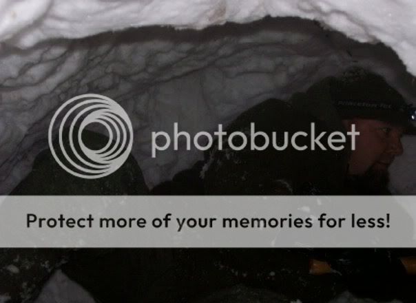

It is almost impossible to photograph the inside of a snow shelter correctly, especially with all your gear in it.

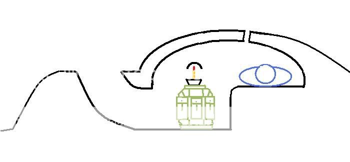

The most important thing in being warm in a snow shelter is that the top of the door being below where you want your warmth. Usually that is the level you sleep at but in really cold conditions (-30f or colder) it is nice to have the air warmer at the level your feet are.
The vent size used is important too, anything bigger than a golf ball and the snow shelter cools down.
The next biggest difference in warmth is made by stopping the air exchange through the door. This exchange is most pronounced in gusty winds. Even if your door is facing away from the wind, changing wind speeds change the barometric pressure outside the snow shelter in relation to inside and this pumps the air in and out.
A long tunnel would make this exchange slower but so does a door and it is very convenient to have a short tunnel for going in and out of the shelter.
A tunnel with a door would be the warmest.
especially if your bed is elevated above that level just a little bit. It creates a cold well for the cold air.

One of the biggest lessons I learned from years of making snow shelters is not to overheat them. 1 or 2 candles MAXIMUM..... otherwise the air becomes damp, you become damp and the cold works its way right through to your bones. Snow shelters just take the edge off the cold and make it bearable. Control the air exchange, create a coldwell, insulate yourself from the snow and you are all set.
Rick
Have you ever set the heat source higher than you were?
Not totally above my level but higher in the shelter. It's best to have the heatsource above the top of the door and even with the sleeping area.
Here is a quick drawing of the best design I've done so far... I've only done 8 that I can recall... and only 3 with good results... he he. This one is a keeper.

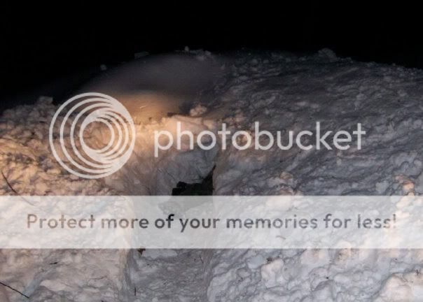

Digging in (proir to backfilling the entrance "tube")..
Still digging.... Joe is right... its tough to get a pic inside such a confined area...
