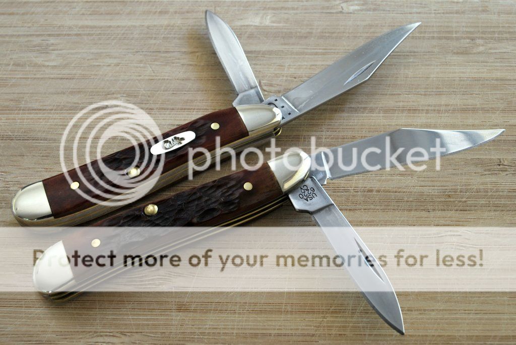

Got pics?
No before shots, but here's a decent-ish (color tuning is *hard*) shot of the result:
peanutjpg_zps4cbbcc39.jpg~original
The mark side was pretty good to start -- it just got a little browner. It was the pile side that was a mess, especially on that last stretch between the pins and the bolsters. That really came out quite a bit better. It's just one knife -- both sides appear at once through the magic of photoshop (the magic of GiMP, technically, but no less annoying to work with.)
--Mark
That turned out really well, Mark! Definitely a unique color of deep rich Chestnut. And you did all of that with just tea?
Thanks! Just tea, yes, but fairly strong -- 3 bags of black tea for three cups of simmering water, and the tea had definitely been boiled by the end. This would have been a viciously bitter cuppa.
Looking at it on my laptop (which has a terrible display) I'm not sure I got the color right in the photo -- it looked better on my desktop display, but then, everything does. (Be interesting to check it on my monitor at work tomorrow for a 3rd vote.) In real life it kept the mild reddish tone that the chestnut bone has when it's done right, just with a brown hue in the places where the dye was too weak -- this, compared to the very reddish color it had to start with.
