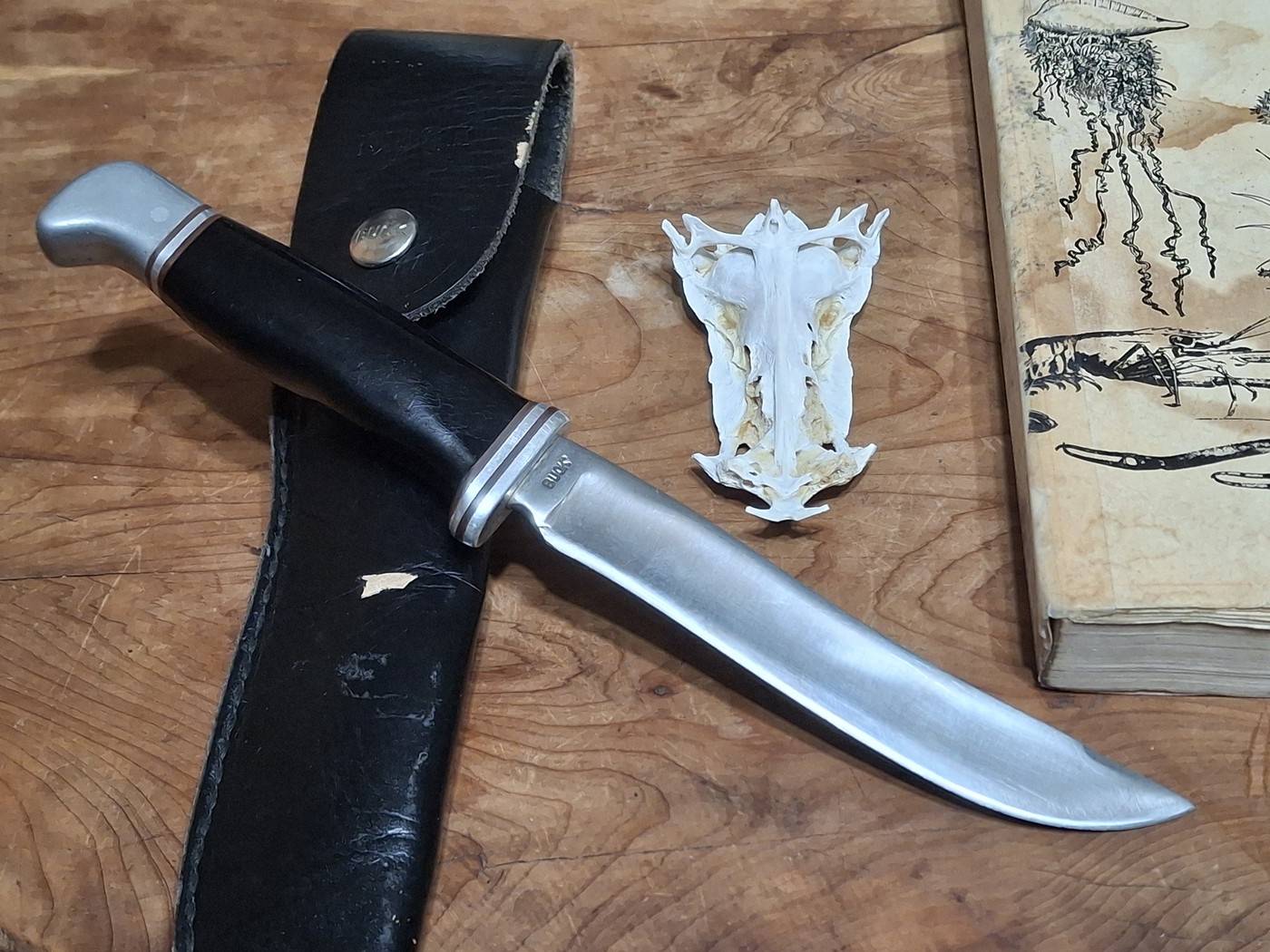

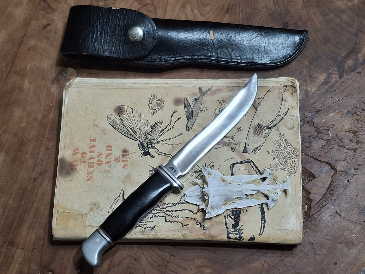

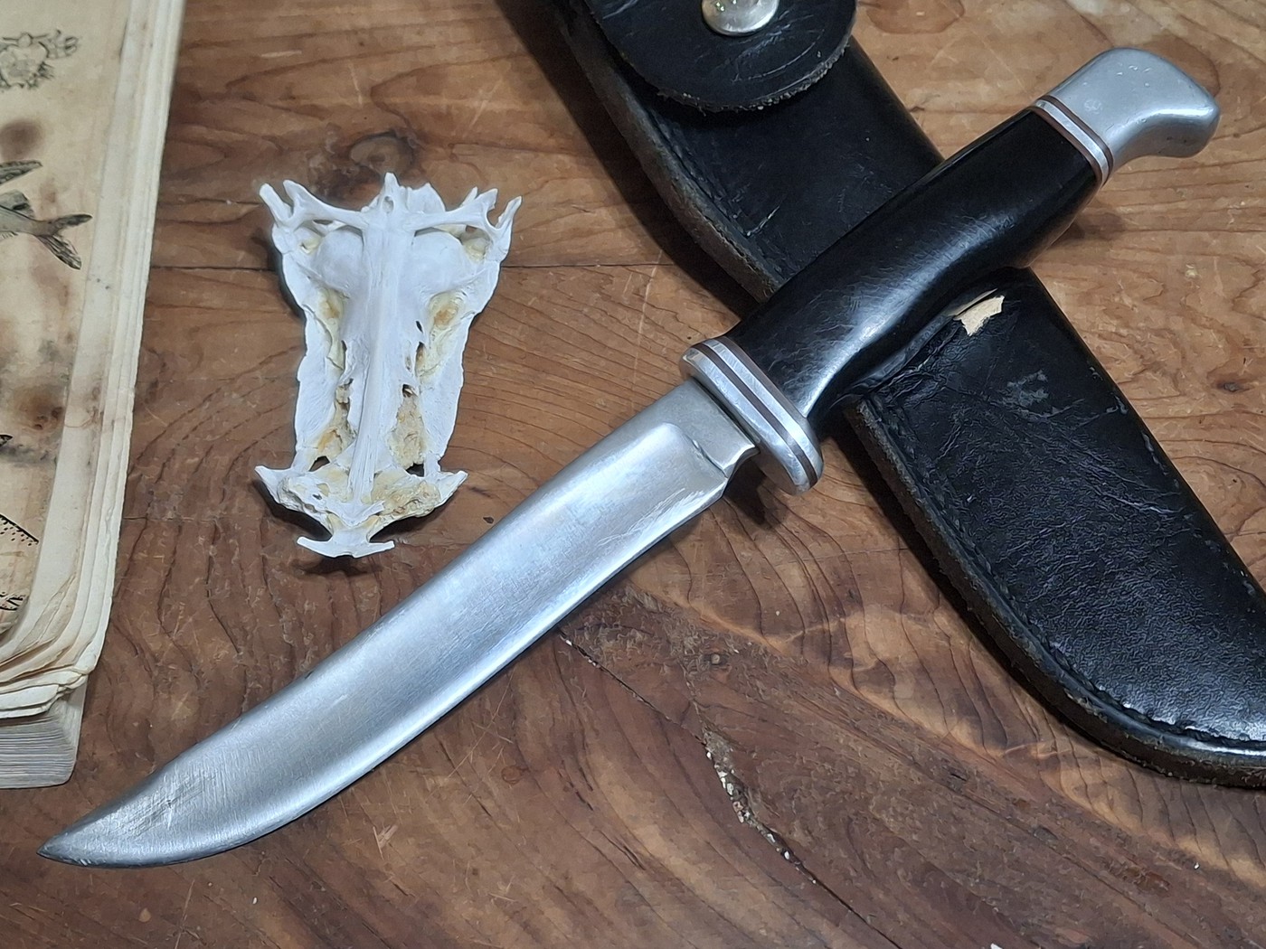

When my Dad started training me in how to live off the land in Tamps Florida back in the recession of the 70s, the first serious knife he bought me was a Buck 105, forged of 440C. That knife swam in the bay with me, did food prep, did fire prep, and made gigs for me to spear fish I had trapped in tidal pools. Overall it performed as well as any knife I have ever had. So when I found this one in a resale shop for $50 I just couldn't leave it there.
It has a few use scratches, especially near the tip, but had never been sharpened. I'm working on sort of a retro review of it based on my experiences with it back then and some uses today. I carry it sometimes, just to remind myself from whence I came.
