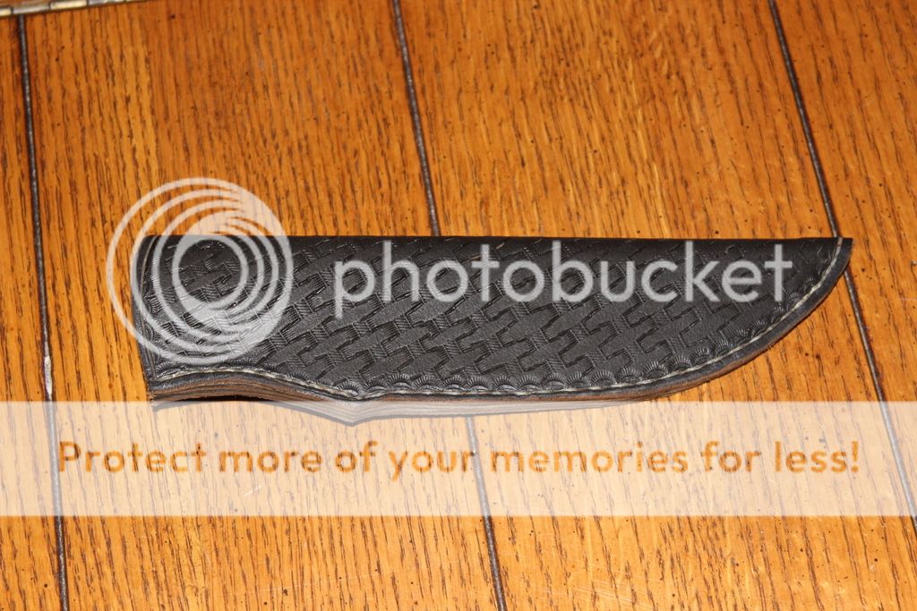

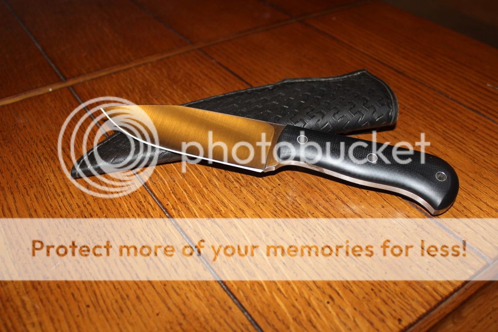

I have been wanting to do this for a long time, just like making knives, and I swore this would be the year I finally got around to it. The knives are coming along slowly at the moment, between work and nasty weather every afternoon here. I decided to order Chuck Burrows' video and I get all the tools together so I could make my first sheath. I did some searching on here and got most of what I needed ahead of time. I watched the video twice and then spent a little time the last couple of night making my first sheath.
I am happy with my first attempt. I made several mistakes, as expected, but it turned out to be functional. I used scrap leather from Michael's for this, so the leather is pretty crappy. I have since picked up a nice piece of double shoulder to work with for my next project. I think I have enough leather to make several more sheaths now. I am trying to decide which knife I want to tackle next. I have a couple big bowies that could use some new pants. Thinking I need to pick up a couple sam brown studs to use for those.
The funny thing is, my wife has been tolerating my hobbies till now. When she saw the setup for working leather, on the dining room table, she was excited! She loves leather stuff and used to make a few things, years ago. I didn't know she liked it that much. She is working on her first sheath as well, it just isn't done yet. She loves it. I think I hit the jackpot with this one. She has been looking at tools and stamps and stuff. :D
I got ahead of myself a couple of times and made life much harder with this first one. I think the second will go a lot faster. I also didn't use enough thread to quite finish the stitching, so I had to adjust everything a bit. The overall process is a lot of fun. I was looking forward to getting home from work the last couple of nights so I could work on the sheath.
I have to say that Chuck's video is very helpful. I plan on getting Paul Long's videos in the future, in addition to the Al Stohlman books that just came in from Amazon. I have not had time for all the info to really sink in yet, but I'm loving every minute of it.
This is a Siegle belt knife that I only had Kydex for, so I figured I would make some leather for it.

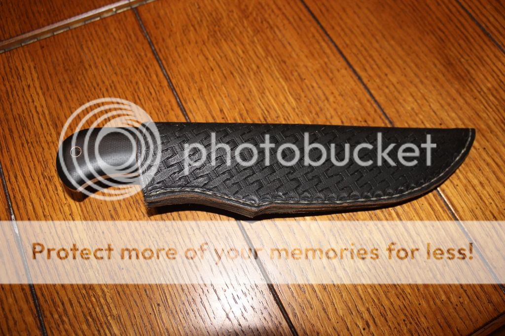

Which basket weave stamp are you using? If it's a Tandy/Craft Tool the designation should be on the handle. It's very clean and looks great!
I like the stitching to follow the curve or angles of the loop strap, but your stitching looks good.

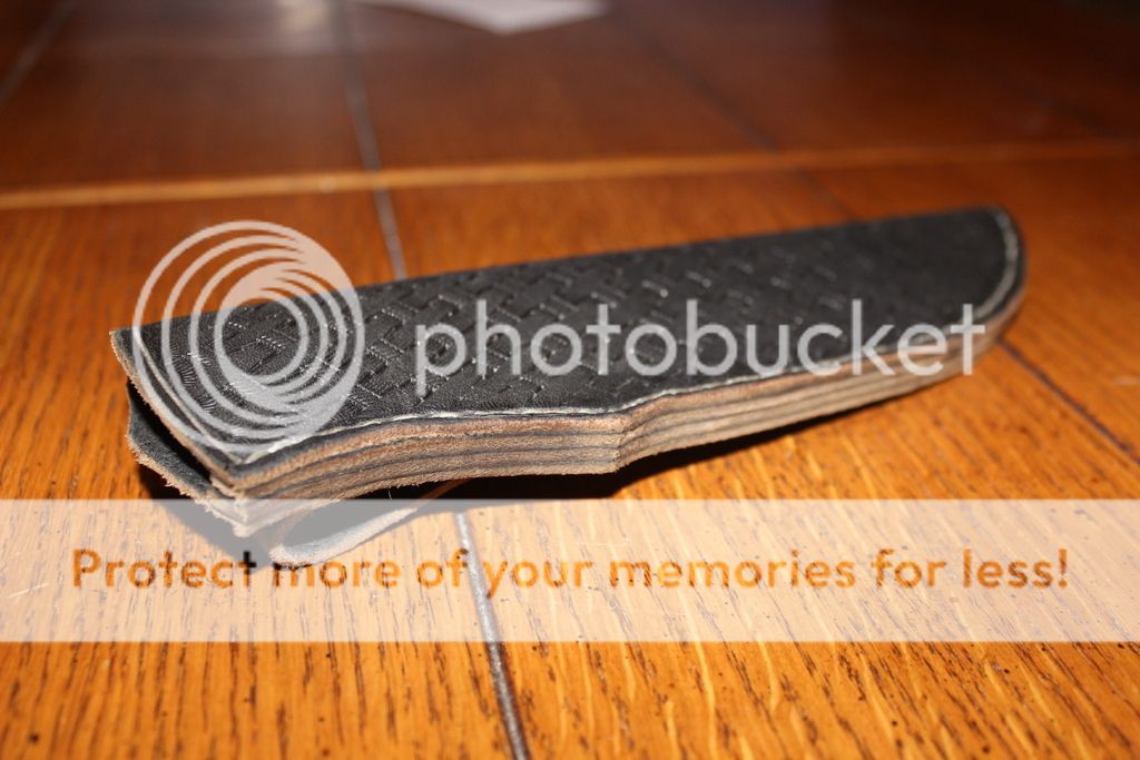

I really like that you broke up the dye by using contrasting color on the welt.

Nice job! For a first sheath its a really nice job in fact. Couple of suggestions if you are open to them.
Thanks guys, I am open to suggestions.
I already know several things I did wrong, but i had to finish it as It was Or scrap It. I got ahead of myself on a couple things and had to just work around my mistakes.

Please take my comments in the spirit in which they are intended. I applaud your initial effort, and it looks like you are on the right track. My major critical comment is that you called the sheath done before it was finished. You can still do some important finish work although it will be admittedly harder being out of sequence. You can still finish the edges with care since it is already stitched and you have limited yourself to how much can come off to obtain a flat smooth surface. The edges around the mouth and around the belt loop should have been edged and then burnished to a smooth sheen. This will be very difficult to do properly after the fact. The very good news is, that this is your first, and you went a long way around the learning curve with it. Stick with it….each one will be better than the last. Train yourself to believe, it's never "good enough" until it's perfect, and just for the record I'm still trying to get my FIRST perfect sheath. I've had a few 97%, 98% but haven't had that 100% yet;)
Paul
Good advice from Paul. I suspect that if you are making knives, you probably have a belt grinder? If so, try a belt to even up your edging. Just watch for heat build up. Burns go deep. If you don't have an edge beveler you can round the edges by hand with sandpaper.
Gum tragacanth is nice for laying the fiber down on exposed edges, but saddle soap, beeswax, or even a little water + high grit sandpaper can get it smooth. Try the paper in one direction. You can use a piece of canvas, wood or a bone folder, hard plastic, or an antler to burnish. Basically anything that'll generate a bit of friction heat will help the nap lay down.

I have most of the basic tools now, which are a mix of Crafttools, Realeather crafts, and some cheaper China stuff. I used the Realleather x513 basket weave on this one.

Thanks, I believe that's the same stamp I use (it's a Tandy stamp by the designation, just re branded as a lot of their tools seem to be), but mine isn't so crisp. I'm pushing a hand made basket weave stamp to the top of my list.

Looks like your off to a good start. Basket weave stamps are not something I usually have the guys start off with, they require a lot of patience and practice to get lined up. The first few are where you learn what not to do. My advice is usually to slooooow down and visualize before doing, enjoy the process and don't worry about the finish line. I would bring in that stitch line a little to avoid having speed bumps on the outer edge when making holes. My welts are 5/8 for single stitch runs and 3/4 for dual runs. Everything gets brought down on a belt sander, use a new belt, low grit to avoid burns.

Being perfectly honest, your stamping is pretty good. You must have taken care to do a good job. Don't speed up just because you've done it a lot. It's easy to back pedal on the quality that way. If anything, spend more time doing it. I am slower now than when I started, but everyone's different.
When you use your groover for your stitching lines, follow those up with a parallel groove about 1/4" inside the stitch groove. This is the line you'll want to use at the edge of your camo stamping. That gives you a better separation between your stitching and decoration. Looks more professional in my humble opinion.
