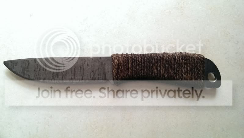

I am making a knife for a KiTH on another forum and wanted to try something different. I had never forced a patina before and decided to try some mustard (French's spicy brown to be exact) and this is how it turned out -
I'm pretty happy with it :) I just spread a thin layer on and used a toothpick to make some stripes (the areas where the mustard in thinner gets darker). Anyways I hope you like it

I really like the look of that. Actually I like the whole knife. Can I ask the spec's? It looks like a great user and Im sure it will make the recipient very happy.

Specs are -
1/8" 1084 carbon steel
4" blade
4" Jute wrapped handle, soaked with epoxy
HT'd in my little forge, quenched in a brine solution, tempered @ 400
Hair poppin' sharp :)

Very neat. He durable is a finish like this, say in the kitchen?
I'm not really sure of the durability in the kitchen, but I was just hacking through some 1x2 pine and it still looks the same.
I only left the mustard on for about 15-20 minutes. It dried and I rinsed it and wiped it off with a rag.
Looks great. I have been playing around with forced patinas. My experience with mustard has been the thinner you spread it, the better. I like the plain old yellow mustard because of its even consistency.

I have a couple Opinel brand paring knives that have a patina because of kitchen use. If anything it will just get darker.
Mustard is neat because it darkens most at the edge of the lines/drops and only a little in the center...I think due to the largest reaction with air where the mustard is thinnest.
Try taking some paper towels and soak them in vinegar, then twist them up. Lay these twists across the blade and let them sit for a while...at least 30 mins to an hour or more...longer = darker. The result is a very cool pattern. That is what I did for my BK9 after initial darkening with vinegar soak.
