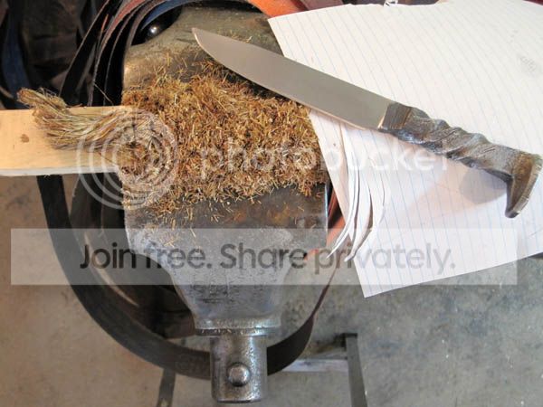

After quenching a railroad spike knife I was able to easily make 50 cuts of 1/2" hemp rope, and still slice paper (though with a little drag)

I also stand by my personal results, which started out with a lot of skepticism of others claims.
