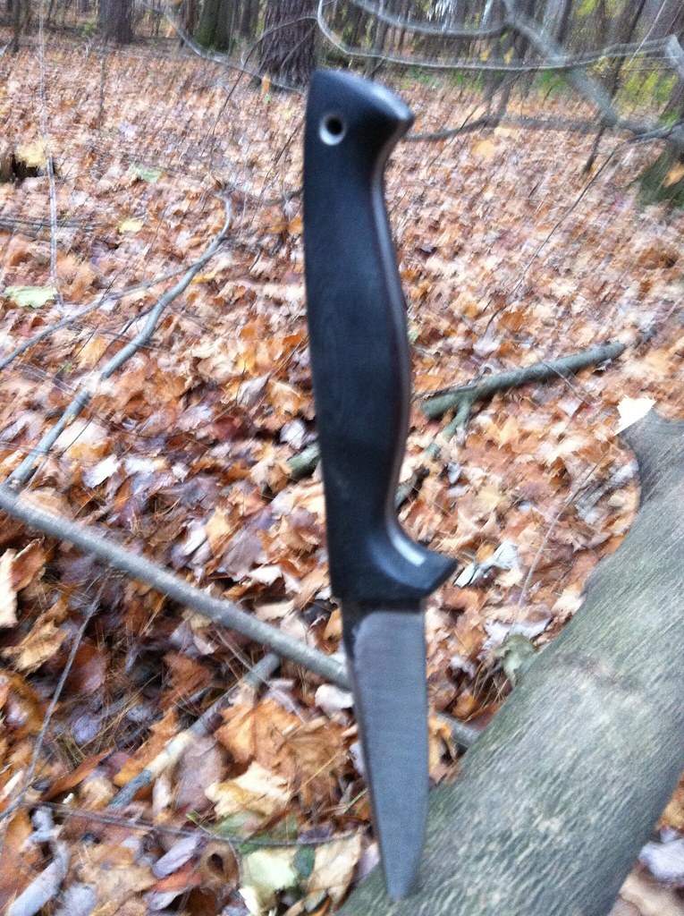

Handle:
The handle also fits my hand really well. I have large hands and sometimes it is hard to find one that has enough width. Some of the people coming around the house thought it was a little thick but like I said I like it for me. I really like how Dan does his handles with a feature that comes down on either end of your hand. That really seems to help making the knife feel secure in the hand.
I really like how the micarta guard looks and is attached. This guard has two pins and epoxy to keep it very secure. My other knives that I have without a guard I still am usually careful to make sure my hand does not slide up. With this guard I was never worried my hand would slide forward during trying to pierce something.
This knife handle also feels very comfortable doing food prep around the kitchen. This handle was comfortable for me to use for about an hour strait. My wife and I go backpacking and all of our knives we like to shine in the food prep area also.
There is a small hole for some paracord to be inserted. Whatever lanyard you want to put on this knife the rope will have to be fairly small. The internal diameter is only about 3/16”.

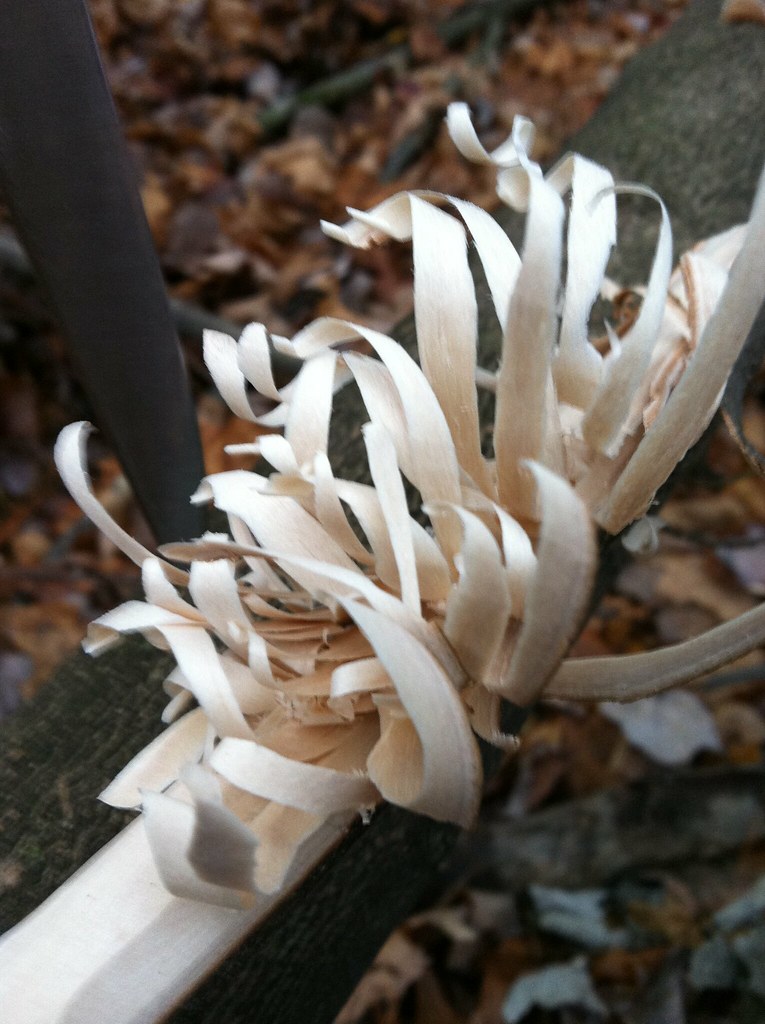

it was easy to use for fuzz sticks.

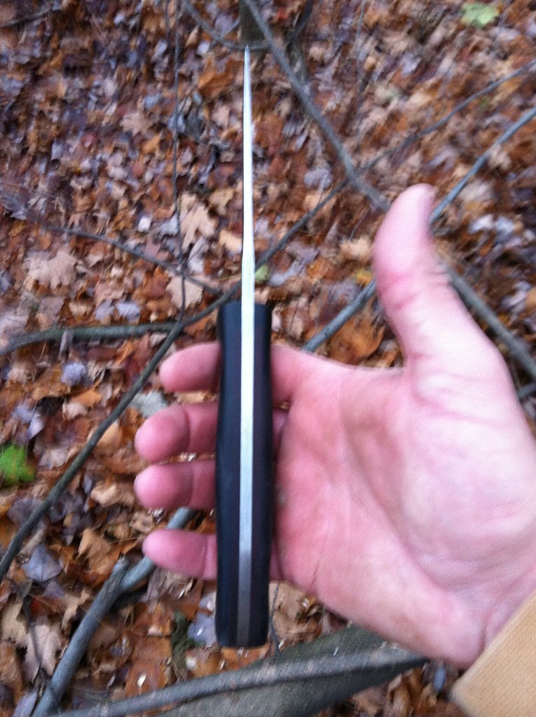

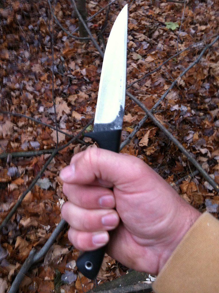

The handle. i actually liked the shape quite a bit. it just didn't fit my hand. the handle was 5" long. and the swell was right in the middle. this meant that there was a lot of excess for me (sorry for the crappy pic).
you can see what i mean with my hand closed.
i would have preferred the palm swell to be moved toward the tip. that way, my hand would be pushed toward the guard. even then, i could lose a bunch of length.
now, i know the handle is a very subjective thing... so take that all with a grain of salt. if you have large hands (or were perhaps wearing gloves), then this handle would probably work for you. i would guess it is tough for a maker to come up with one handle that pleases everybody.
