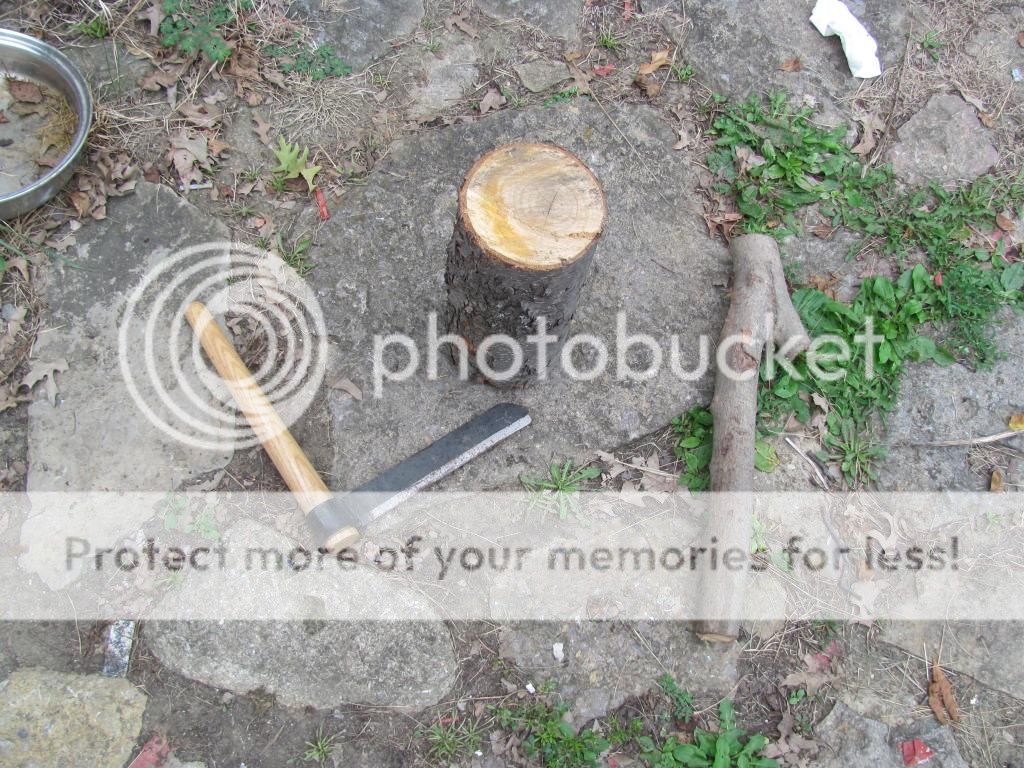

OK, I'm an old coot whose depression era father bought me one knife and one hatchet. Don't break them or lose them! All these guys beating on knives to chop down trees makes me a bit irritated. If you simply must beat on a blade get one of these, a "froe."

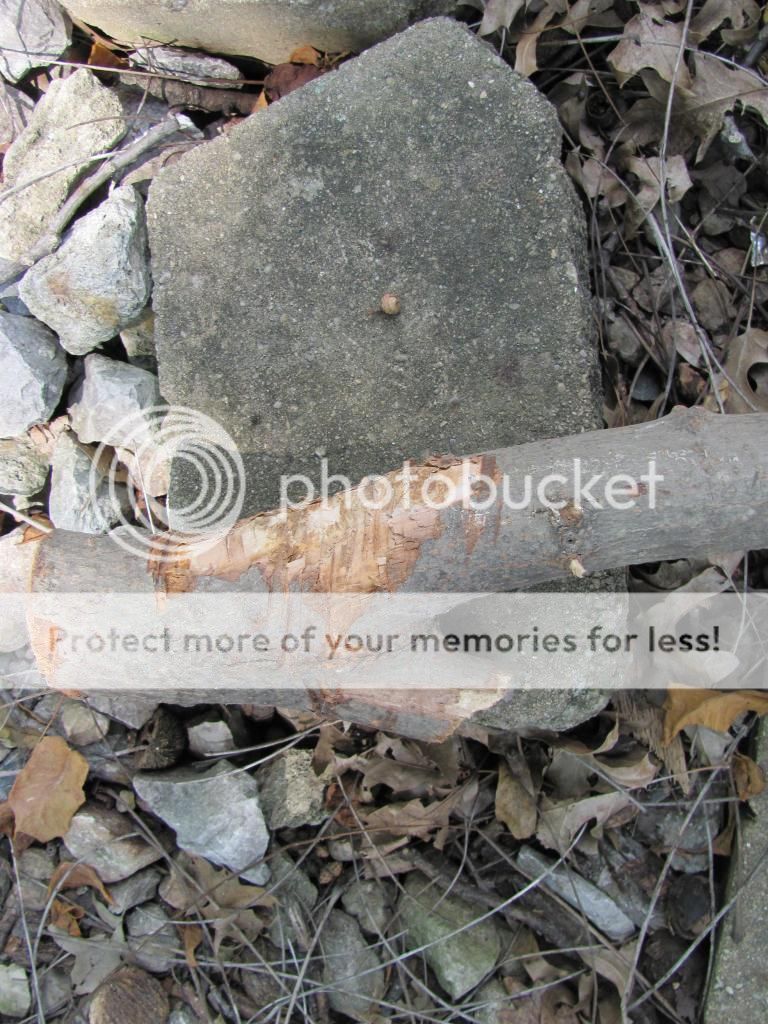

Don't use a mallet to beat it either (though Wikipedia suggests that at one point), use a "froe club", I've pictured one below. It is free and you do not want your mallet to look like this.

That froe isn't any more stout than the knives I use for such purposes, nor do I use a bigger wooden "club".

A froe is actually quite a lot thicker than most survival knives, and is ground specifically for splitting, not chopping and splitting. That being said, while not the perfect tool for batoning, large fixed blades work pretty darn well for the task.
The long handle on the froe also serves as a lever to split off a shake. You usually only need to pound it in to about the depth of the blade and then reef on the handle to split off a shake. Again, it's a specialty tool, great for making a lot of shingles.
