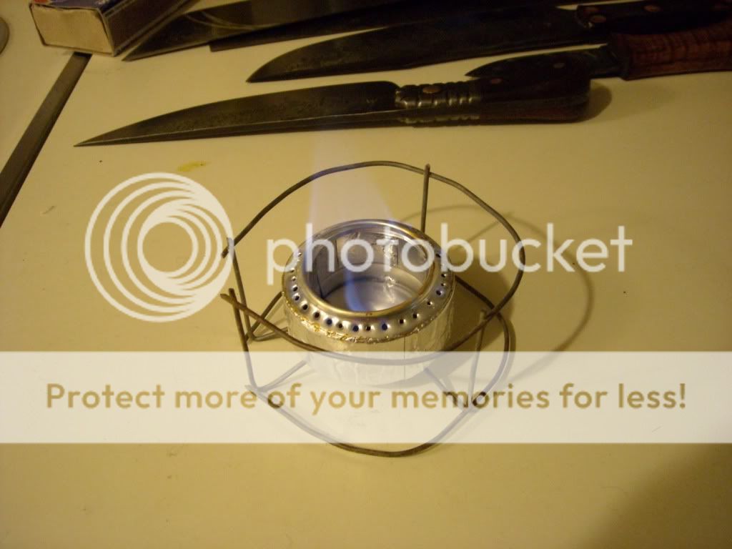

I asked about Alcohol Stove in general....
So, Brandon was nice enough to offer me one...
And since I now have one, I can take pictures, and show how they work....

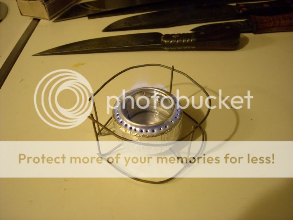

This image is of the the stove and a pot stand...
And with it lit, notice the flame is really only in the hollow center...

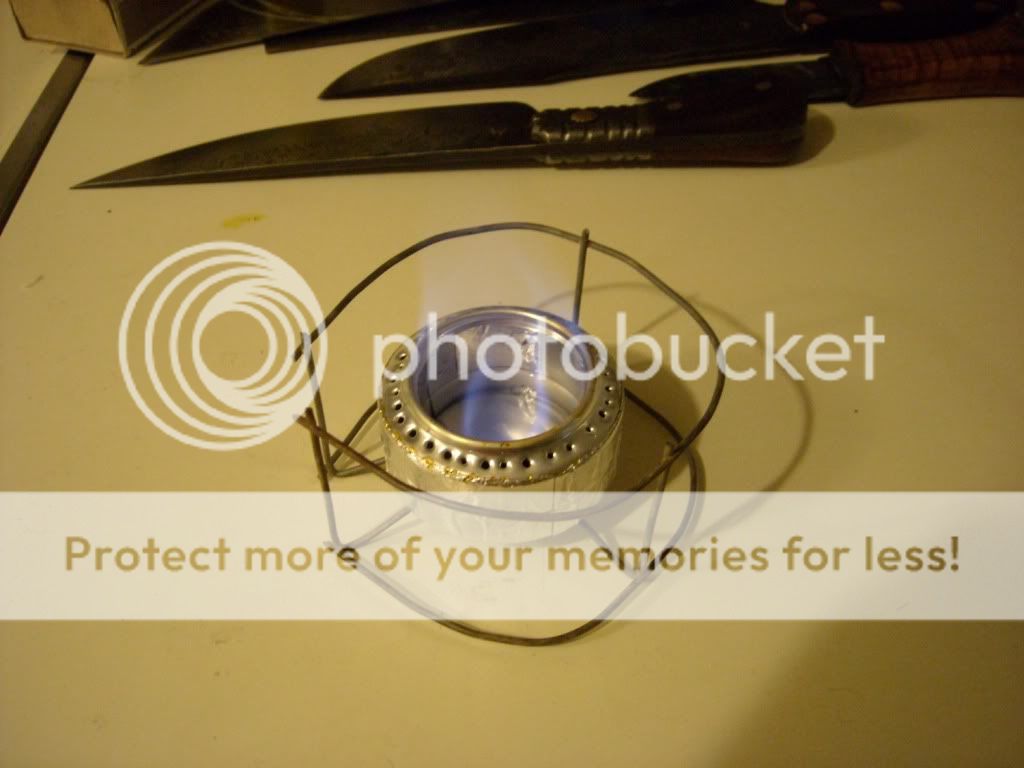

It is starting to get into it's stride, notice flame in some of the holes in the top...
And now you see the stove with the flame coming from the jets...

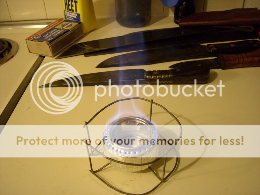

And fully engulfed...
