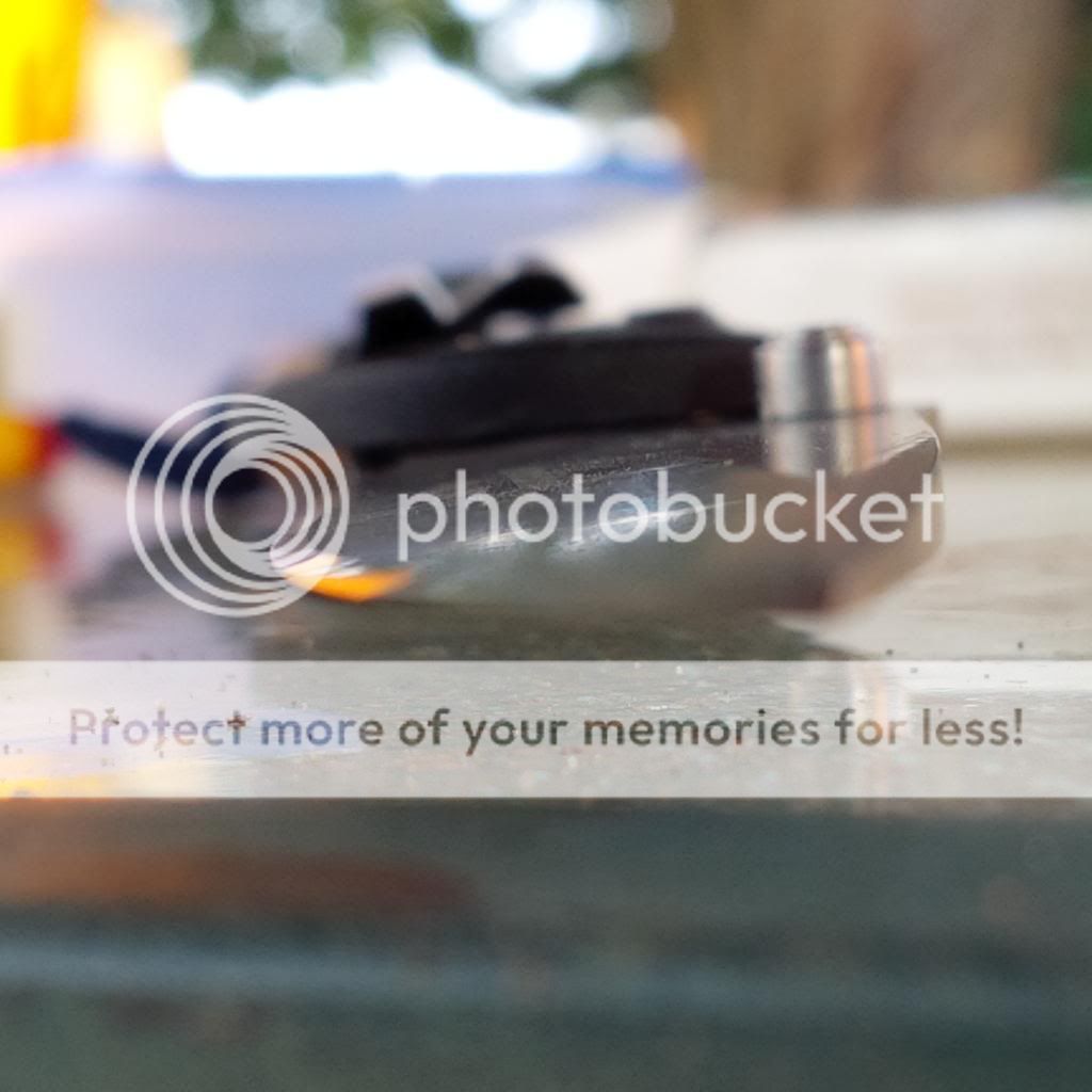

That bevel looks pretty darn wide for 22dps! I run my Lg21, Lg21Ins and Umnum at 17 and none of them has a bevel that wide... and none have any rolling issues. Lots of cardboard... several zip ties... no problem. Something is definitely amiss... I suspect Don M is correct about the wire edge. But I'd also double check your dps angle... your bevel looks much more acute than 22.
If you had a heavy burr during reprofile, then there would be a lot of weakened metal at the very edge. Sharpen it enough to remove the weakened metal (depending on how heavy the burr was during the reprofile) but without forming a burr or as small of a burr as you can get, and you shouldnt have any more problems.

This has gotten me in the past also. Now I use an app on my iPhone to check the angle I am putting on. I will set my phone against the stone to check the actual angle of the bevel on each side of my wicked edge before starting. I was amazed at how far off the difference between what the markings on the rods were and what they actually were.

Some of those apps are not very accurate (+/- 2 deg) I've found. Highly recommend an angle cube.

Ok so....After I payed closer attention to the burr and not letting it get to crazy on one side. It seems to be doing better. I also didn't polish it. I only took it to the 1k stone. I also used my chosera stones as oppose to my edge pro stones. I am almost positive that had nothing to do with it. I also used my phone to find the angel and it was 24 degrees. I thought it was about 19 from my original post.
I have cut a good amount of cord back on the wood table. I have been using it just like before and it seems to be doing fine. I also grabbed a zip tie and seem to cut it just fine. I am pretty sure that it was user error at this point. I would like to know why the guy on the video had the same problem...? I am sure he can sharpen way better than I can.

24 per side ?
That is a very thick edge if so, and yours looks to be much less than that in your first pic where you said it was 22. I would've guessed it to be around 15 dps in those pics.

Yes 24 per side that's what the phone said...
