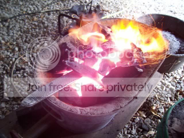

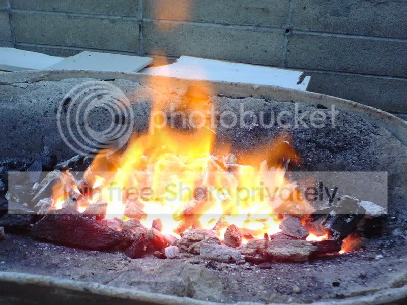

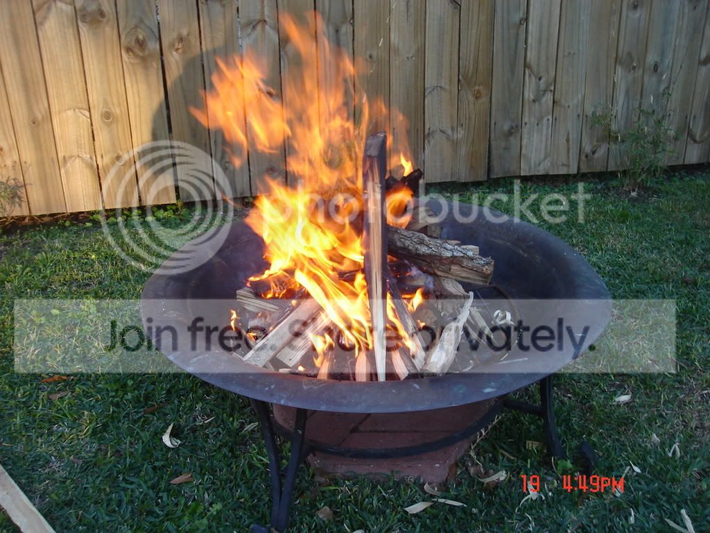

softening files in fire
Mar 10, 2008
886

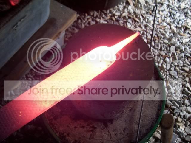

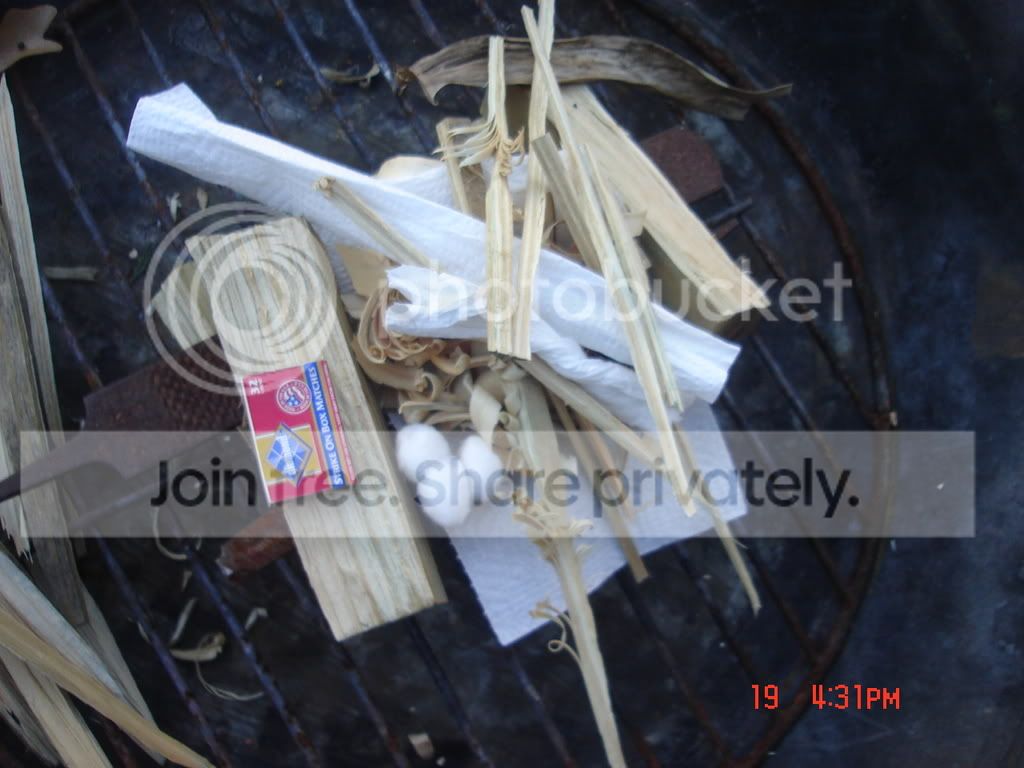

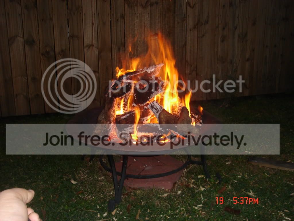

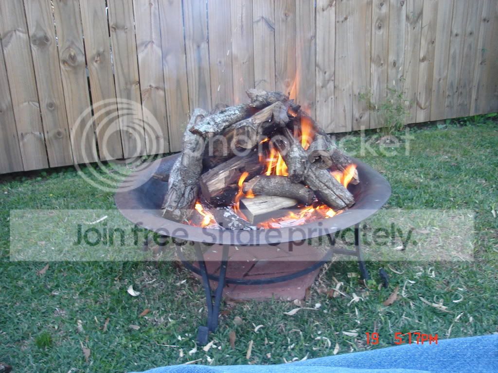

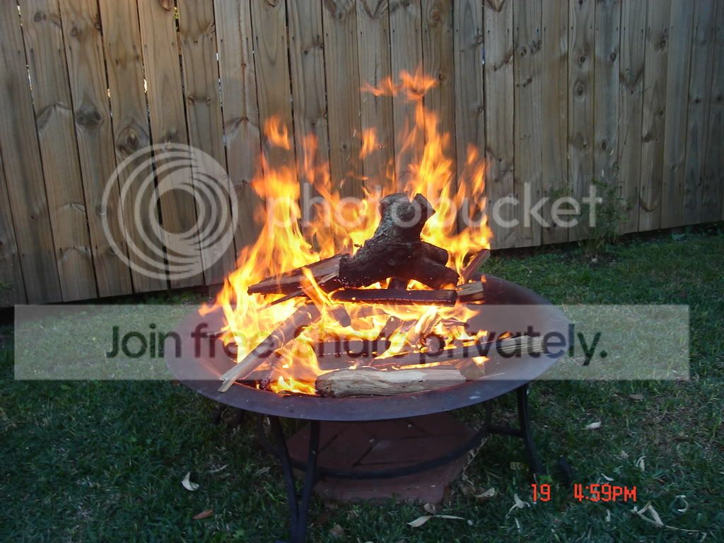

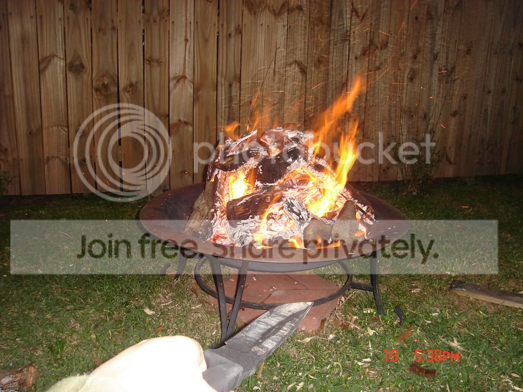

here are some pics i took when i was getting all the fuel for my fire to soften
my files aka my feture knives
i hope you enjoyed the pics

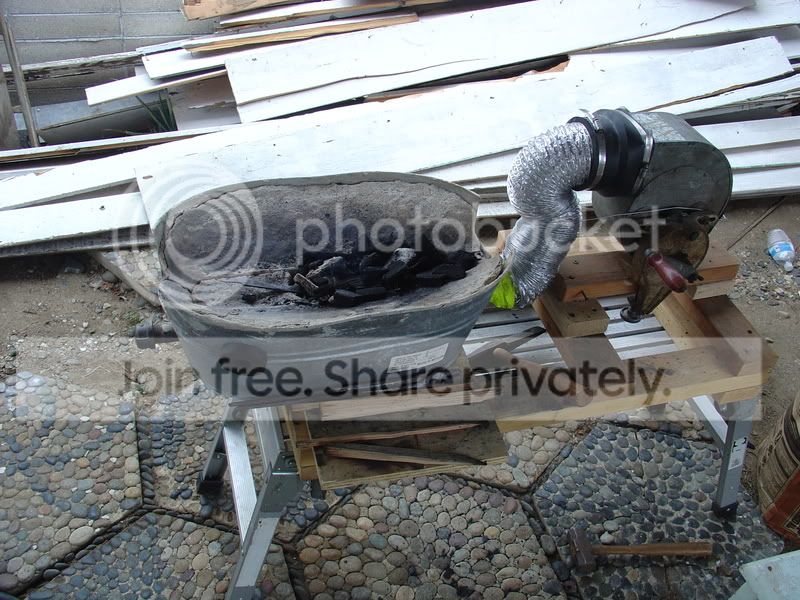

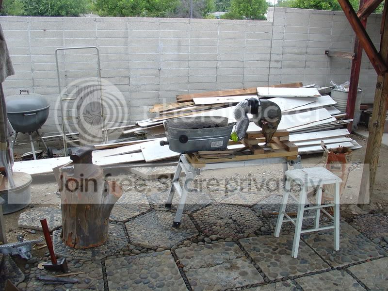

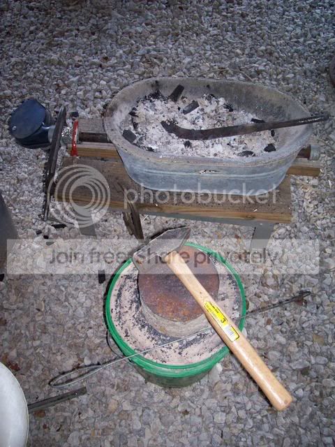

I realize that perhaps the fire-making is part of the fun, but if you wanted to, it isn't hard to get set up a little more professionally.
Here is a pic of my forge, made from an oval basin, some refractory cement, and some iron pipe. It has a blower attached which is electric.
A forge like this allows you to generate more heat, more reliably than annealing in your grill.

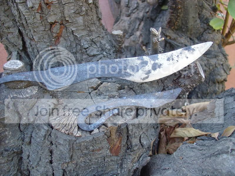

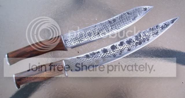

A good set up allows you to make knives like these, which I made from files like you have.
Let me know if you want more info about how to get set up.

OK. This forge is not my design. I got it from here - http://64.176.180.203/washtubforge.htm
I used Tim's design and watched his DVD to get an idea how to use it. I have no commercial or social connection with Mr. Lively, I just learned a lot from his resources.
The only variation to his design I used is an electric blower instead of a hand operated one. The forge is pretty easy to make and the components are available to just about anybody.

Same here, I bought Tim's DVD and built mine from his design. I found his DVD to be a fantastic resource for knowledge and basic how-to. I used a mixture of sand, wood ash, and clay for the "adobe" lining and it works fantastic. I used a dryer hose as to connect my blower to the forge, I recommend against it. It works well enought, and I had it laying around...but it does not last too long. I anneal my files in it and it works perfect, for smaller pieces of steel I used some of the adobe and made a plug to cut the size of the forge in half when I don't need it. Used less charcoal and makes better use of the air that way.
Is it bad to used galvanized tubs for the forge? I have heard that galvanize buckets heated up gave off toxic fumes? Maybe it doesn't get that hot with the mortar lined bucked.
I was concerned about that at first. But you're right; the cement keeps direct heat from reaching the surface of the tub. It gets hot, but not hot enough.
