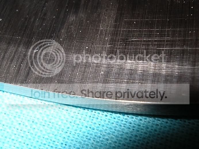

Hi guys,
I bought a Tramontina kitchen knife made of 12c27 HT to 56 RC.(according to them) I got it to use and see how I like the 12c27 for use in future knives. It is not mirror polished, but has visible grind lines from the spine to the edge.
The back of the spine was a little rough ground so I got a bit of fine abrasive paper to smooth it down. As i was sanding, my fingernail was sliding along the side of the knife, and afterward I noticed a mark that had sort of been scratched/rubbed along the length of the blade from my fingernail. I can wipe/rub this marking away byrubbing along the grind lines either.
Can anyone who has used 12c27 before advise me: is it really this soft or would you reckon its just due to my fingernail 'scratching' perpendicular to the grind lines?
Thanks
Lang
Maybe your fingernail was contaminated with some abrasive from the sanding paper. Or maybe you have diamond nails you didn't know for.;) There is no way your fingernali to scratch any kind of steel.

It is a steel i use a lot for making knives. It sound strange that you would be able to scratch the blade with only your finger nails, even in a annealed state this would be difficult. Could you post a pics for us?

Thanks for the views guys. I am thinking it could be to do with the grind lines. My unsubstantiated theory being that those grind lines are akin to millions of very thin blade edges side by side, so on a microscopic scale it would look something like corrugated iron, possibly with sharper peaks. (maybe my analogy is laughable!) The fingernail was possibly able to push over those peaks leaving a pattern?
Ok extravagant theories aside, knifemaniac, I think you probably are 100% correct... The abrasive paper wore smooth quickly, and that grit had to go somewhere... probably under my fingernail.. Thanks for the insight.
I will try post a pick but I think the marks will be too faint to show on my camera.
Does anyone know Tramontina? Brazilian... are they 'decent', and a reasonable benchmark for me to look at as a comparative?
picture shows blade grind direction and longitudinal 'scratch' marks
