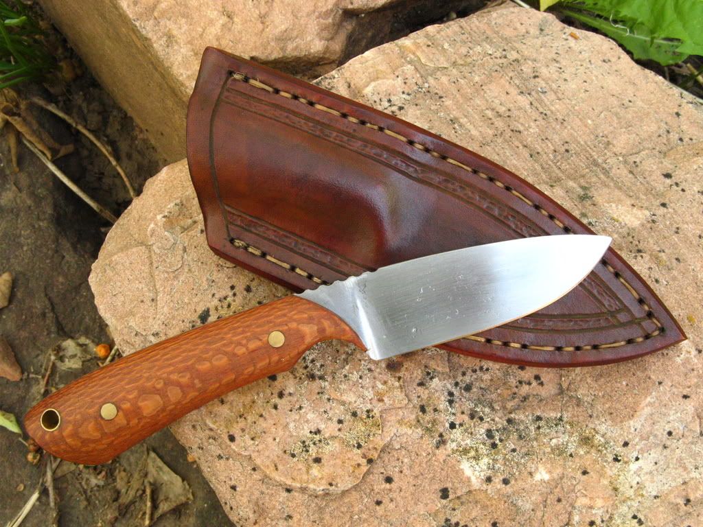

If you're looking for leather, I highly recommend Ilbruche
He made this for me, for a great price too.
