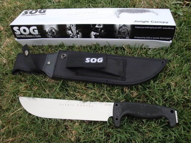

Well my SOG Jungle Canopy came in and I thought I would go ahead and give a brief review of my first impressions and share some photos.
First off the sheath seems to be well made and has some type of stiffeners in it so its not too floppy. I like the cross retention strap used. The front pocket would work good with a multi-tool or smallers knife.

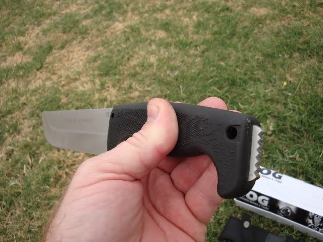

I was happy to see the full tang design with the expossed pommel. Not sure how great it would be for hammering. I also like the kraton grip. Not too sticky or to firm. Feels just right.

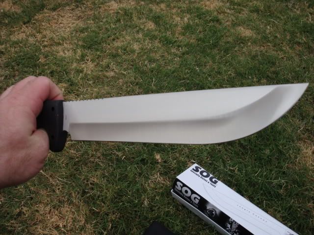

Im happy with the thickness of the blade as 3/16" seems just about right for this badboy. I also like the jimping as SOG seems to be the masters at it.
The blade design lends itself to be a nice solid chopper. At a weight of just over 19 ounces it has a nice feel with plenty of power available.

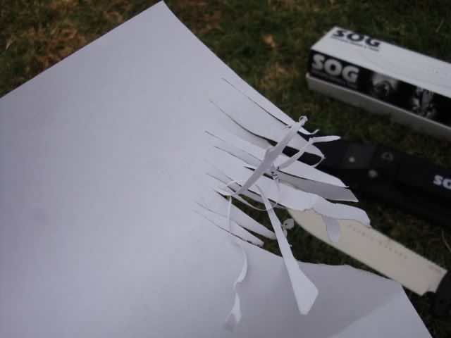

Now heres something I REALLY want to stress. I've purchased hundreds of knives the past few years. I have NEVER received a factory edge on a big blade that was SO FREAKING SHARP. This thing is scary sharp and may have a better edge then many small, thin blade pocket knives I've received. I'm not a great paper cutter but heres some quick slices with it.
Overall I am very pleased with my first impressions of this knife all the way around. I need to put it to work to give a true review but innitally I am very impressed with the Jungle Canopy for a $50 blade as I've had some $100+ blades that weren't to this quality level. I hope to give a more detailed report in the near future. For those wondering here are the specs:
Blade Length: 10"
Overall Length: 15.5"
Thickness: 3/16"
Weight: 19.4 oz.
Edge: Straight
Steel: 8Cr13MoV
HRC: 56-58
Handle: Kraton
Finish: Satin
Sheath: Nylon
