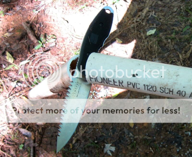

Finally, someone made a solid handled knife with a real, functioning, non-directional wood saw on the spine that has a blade wide enough to work with in normal camping and survival type tasks.
I got this knife a little while back after checking it out on the SOG website. In taking a close look at the design of the saw, the blade geometry, and the specs I was pretty sure it would work well for collecting data for a personal project I am working on. In checking it out in the field and working on a couple of posts I put in the W&SS section I learned I was right. I was also so impressed with just how well it did that I wanted to share what I learned here.
The knife I am referring to is the SOG Team Leader Survivor. It is a full tang design that is made from .16 or 5/32 inch AUS-8 stainless steel. The blade is 5 inches long and the O.A. is 10.25 inches. The handle scales are textured Zytel.
It comes in an ambidextrous leather sheath.

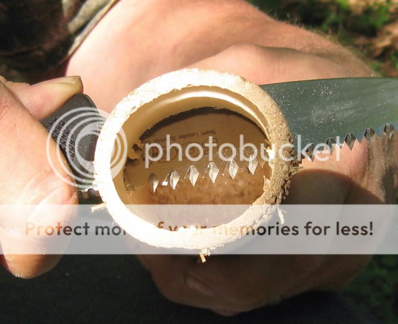

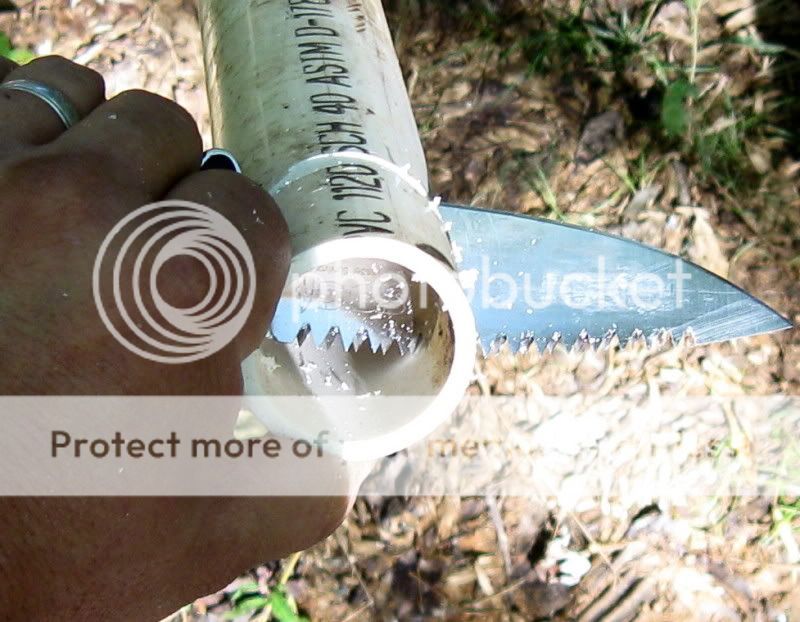

It has a 3.5 inch section of very aggressive saw on the spine which is made of two rows of viciously sharp teeth and is self cleaning in all materials I have tried it in.
The knife has a full flat grind. Because of this the knife is great for camp cooking and slices like a chef's knife. And is really good for cutting fuzzies.
This full flat grind is also a big part of why the saw functions so well. It is true that the teeth are vicious but this grind means that the widest part of the blade is the very tips of the saw teeth. Because of this there is no friction from the sides of the blade rubbing the inside of the cut...the only hard contact is where the saw actually meets the surface being cut.
The Team Leader was the only tool used to make this improvised bamboo canteen/container.
I have tried the saw on a few different materials...bamboo,Schedule 40 PVC, and even some seasoned Hickory at my brother's house showing the knife to him. I didn't have the camera for the Hickory so I guess I need to reproduce that later.
