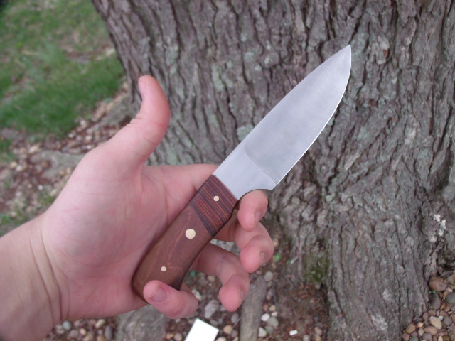

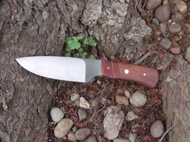

I tried something new with this one, I hope you all like it.
Steel: 1095
Thickness: 1/8"
Width: 1 3/8"
Blade Length: 4.5"
OAL: 8 3/4"

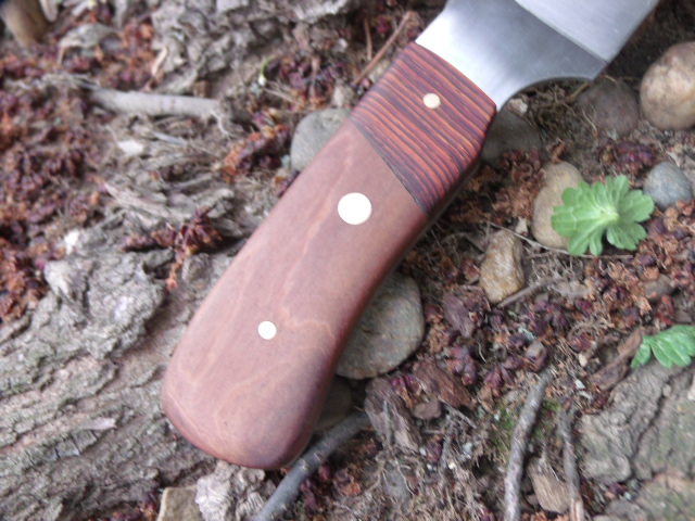

Scales: Bolivian rosewood with a cocobolo bolster, JB welded on

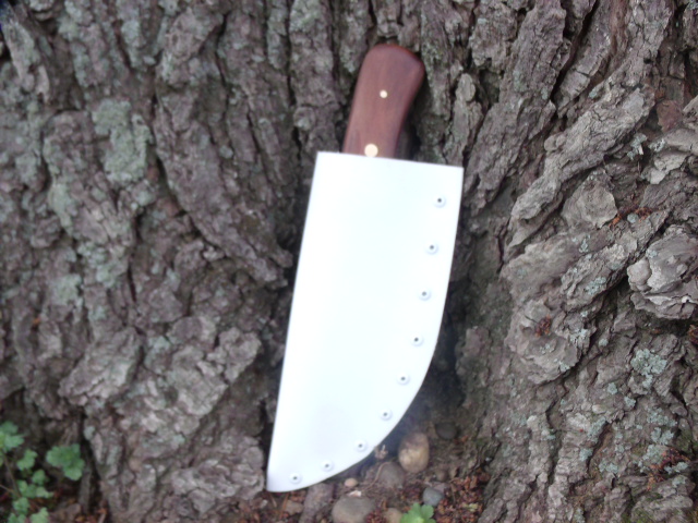

Brass pins to help with shearing forces. It's a nice, comfortable blade, well suited for camping or hunting uses. It comes with a white sheath. I'm asking SOLD shipped, paypal me at sambacurin@gmail.com
