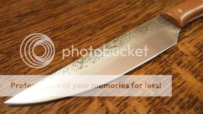

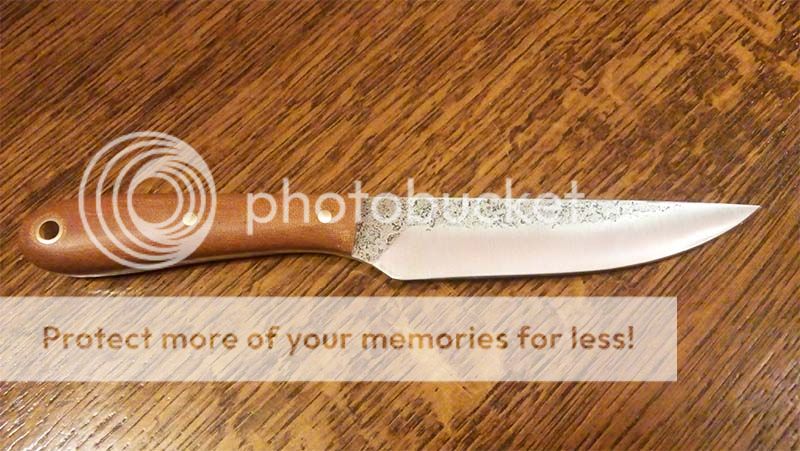

Here is another knife forged from ball bearing and heat treated as 52100.
Please note, it's made from "regular ball bearing" not the ones from M18 "Hellcat"
Flats are left raw, just soaked overnight in vinegar and wire brushed after forging.
After heat treatment, flats are brushed with scotch brite.
Bevels are made in satin finish with scotch brite.
Details:
Blade length - 115mm (4,53")
Blade width - 26mm (1,02")
Thickness at the back of the spine 2,7mm - (0,11")
Overall length - 225mm (8,86")

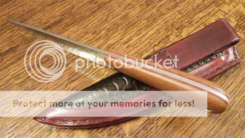

Handle material: Textolite (vintage phenolic micarta over 30 years old), red vulkanfiber liners, brass pins and lanyard tube.

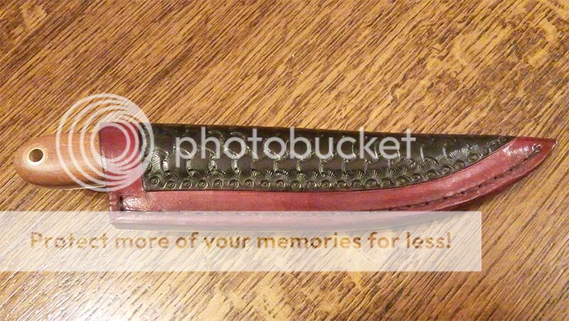

Handmade 4mm thick (0,16") two tone vegetable leather sheath
Asking SOLD, priority shipping with tracking number included
