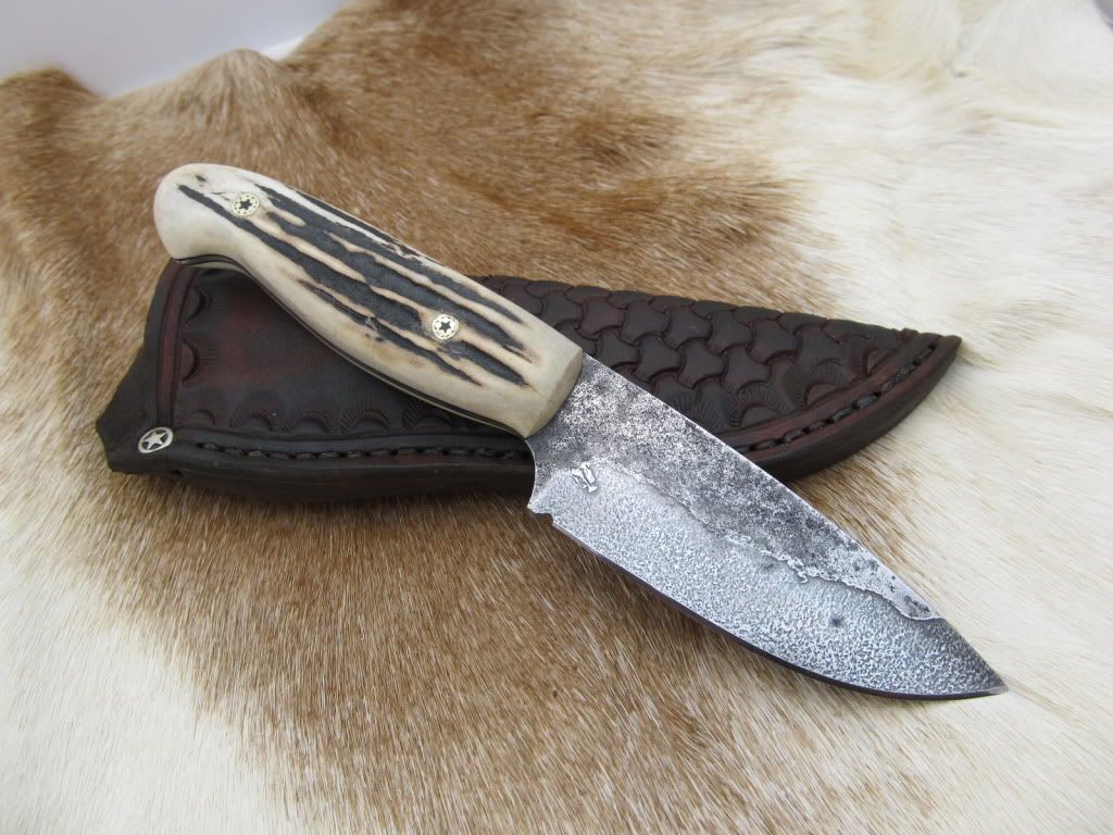

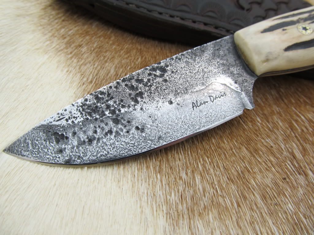

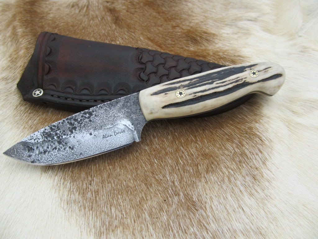

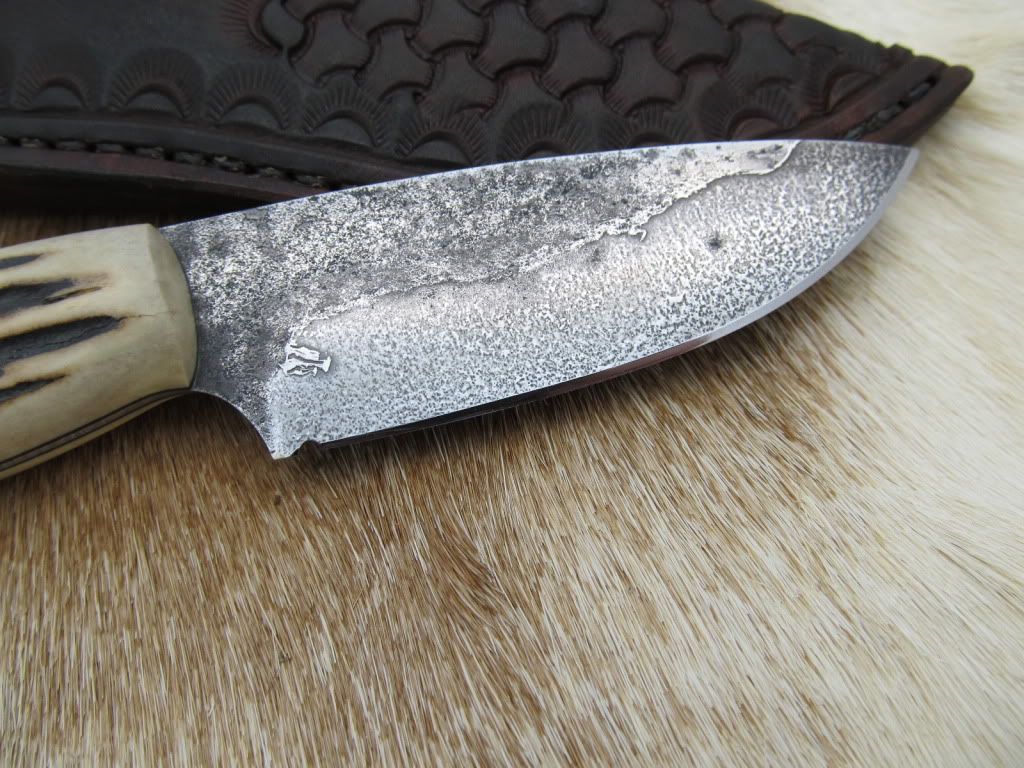

The overall length is 8", the blade is 3 7/8" from tip to scales x 1 1/4" high and is flat ground from an antique misery whip saw blade. I differentially heat treated the blade with the edge at Rc 61-62. The scales are well matched beautiful Sambar stag, with black liners and 3/16" mosaic pins. Hair splitting sharp! SOLD shipped in the US. Paypal or money order. Thanks for looking. Alan.
