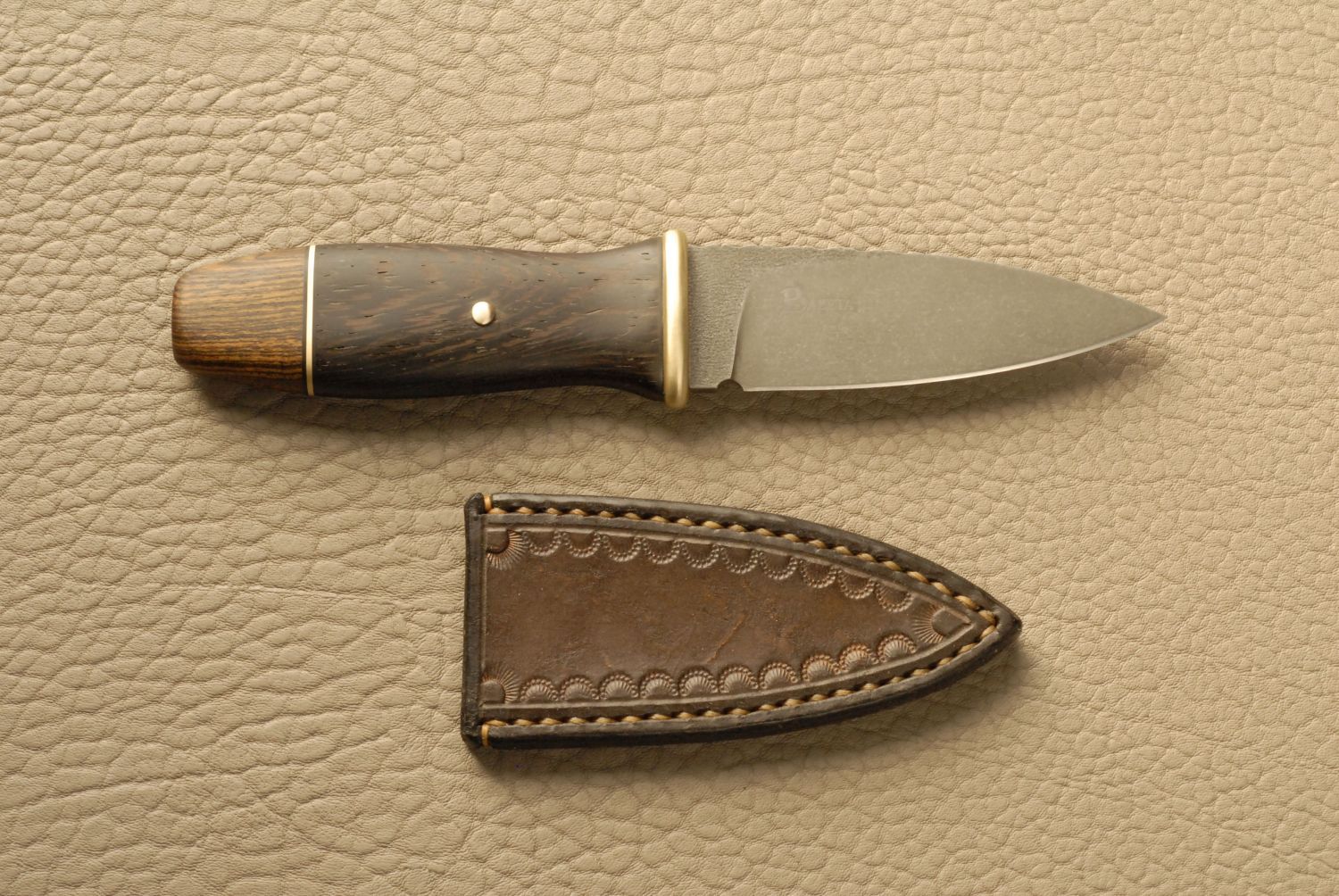

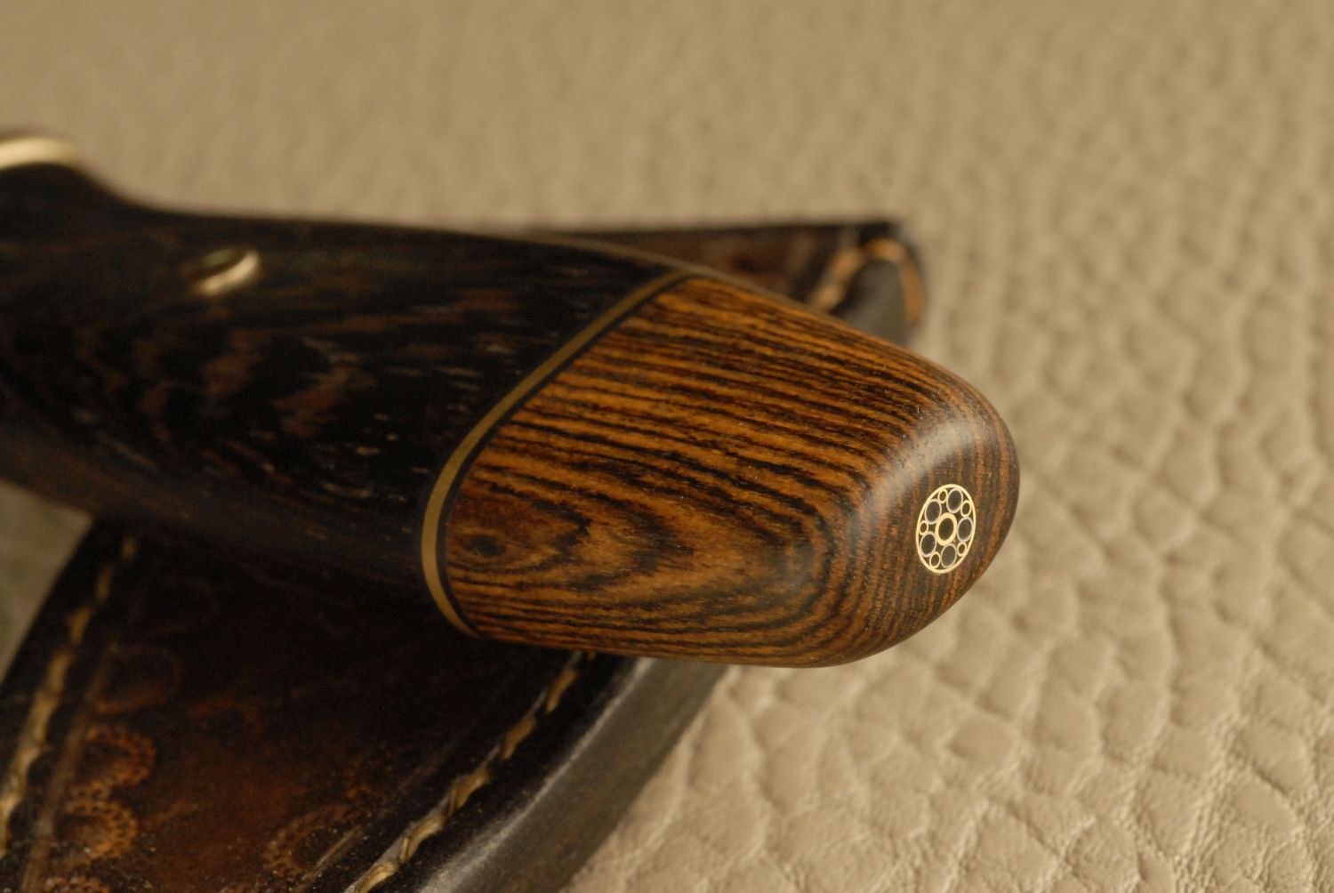

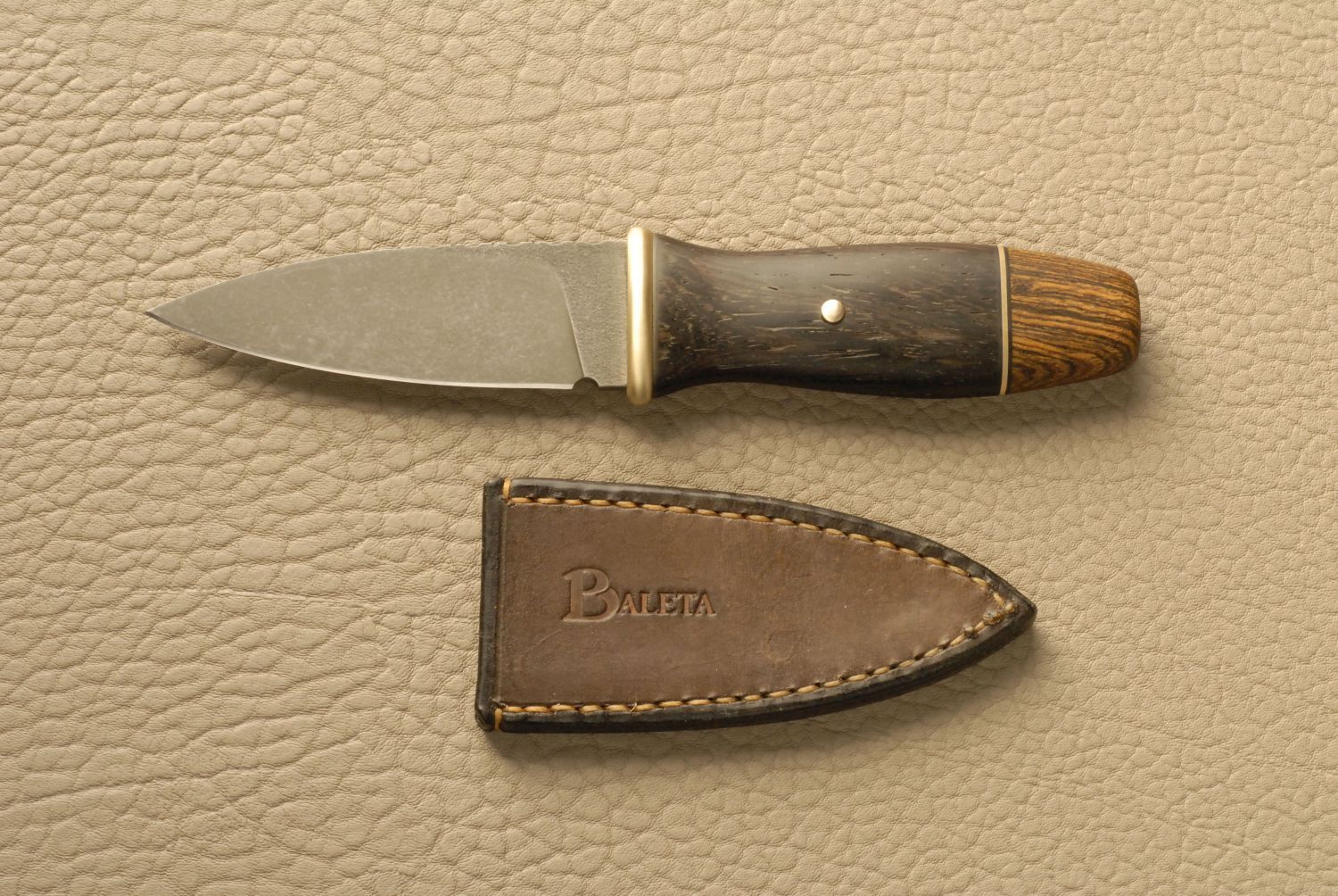

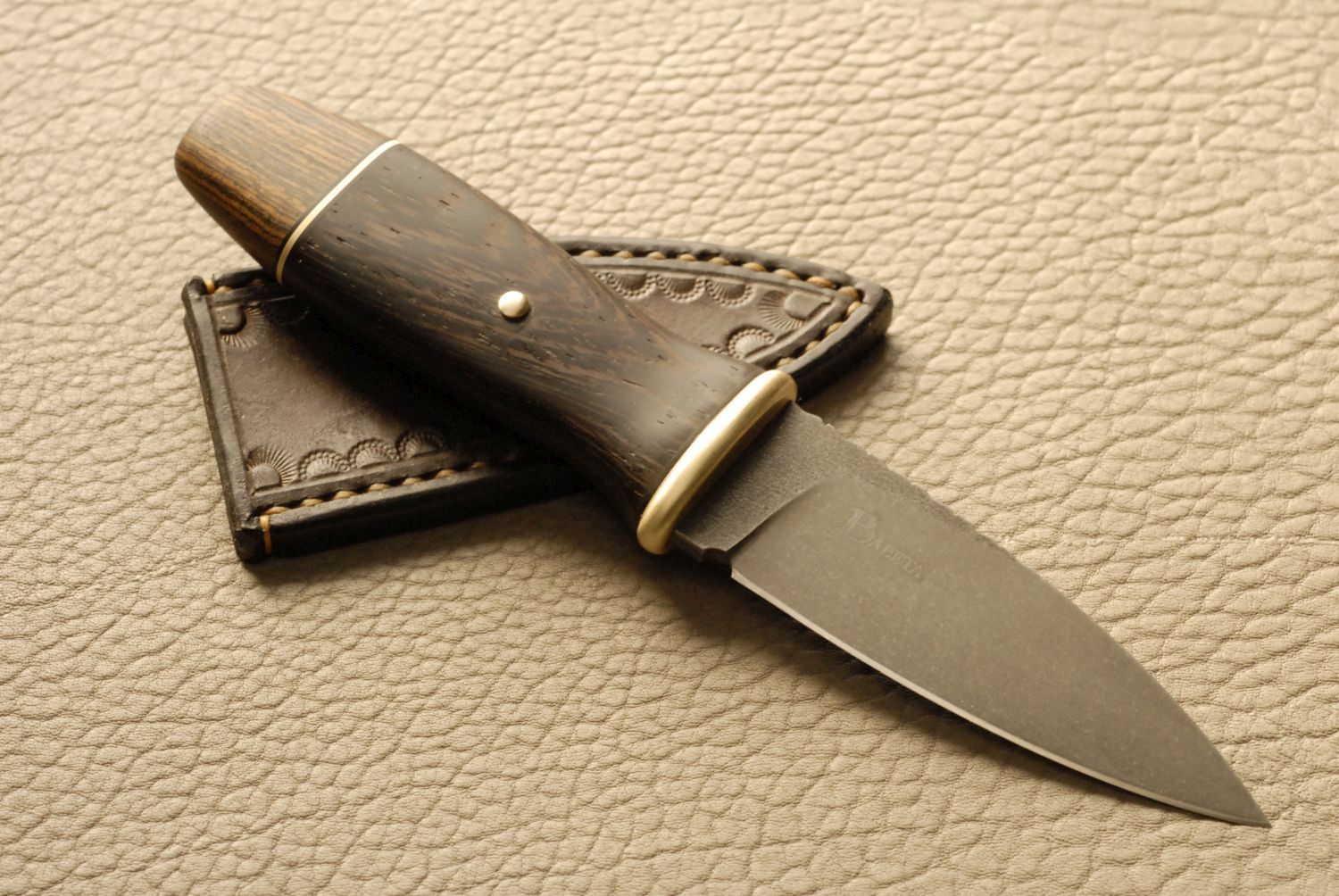

Hi Folks!
Here is my take on a traditional Scottish Sgian Dubh. Crafted in a carbon steel blade (near stainless) with a stonewash patina and a brass bolster that is solid (not a furrule), an oiled Wenge handle centre and a contrasting pommel of Bocote. The handle pin has been peined, domed and polished to a satin finish with detailed filework on the spine. The sheath is also 100% handmade with saddle stitching and embossing.
SPECIFICATIONS
  • Blade: Böhler K110 (D2 equivalent) Carbon Steel (HRC +/- 60)
  • Blade thickness: 3.5mm (0.138")
  • Blade length: 90mm (3.54")
  • Overall length: 190mm (7.5")
  • Handle material: Brass bolster, Wenge, brass and vulcanised fibre liners and a Bocote pommel
  • Fittings: Brass
  • Traditional hidden tang design. Comes with a custom fitted sheath as seen.
€ SOLD
Free shipping worldwide. Also on my website: Sgian Dubh - Brass, Wenge & Bocote
Thanks for looking!

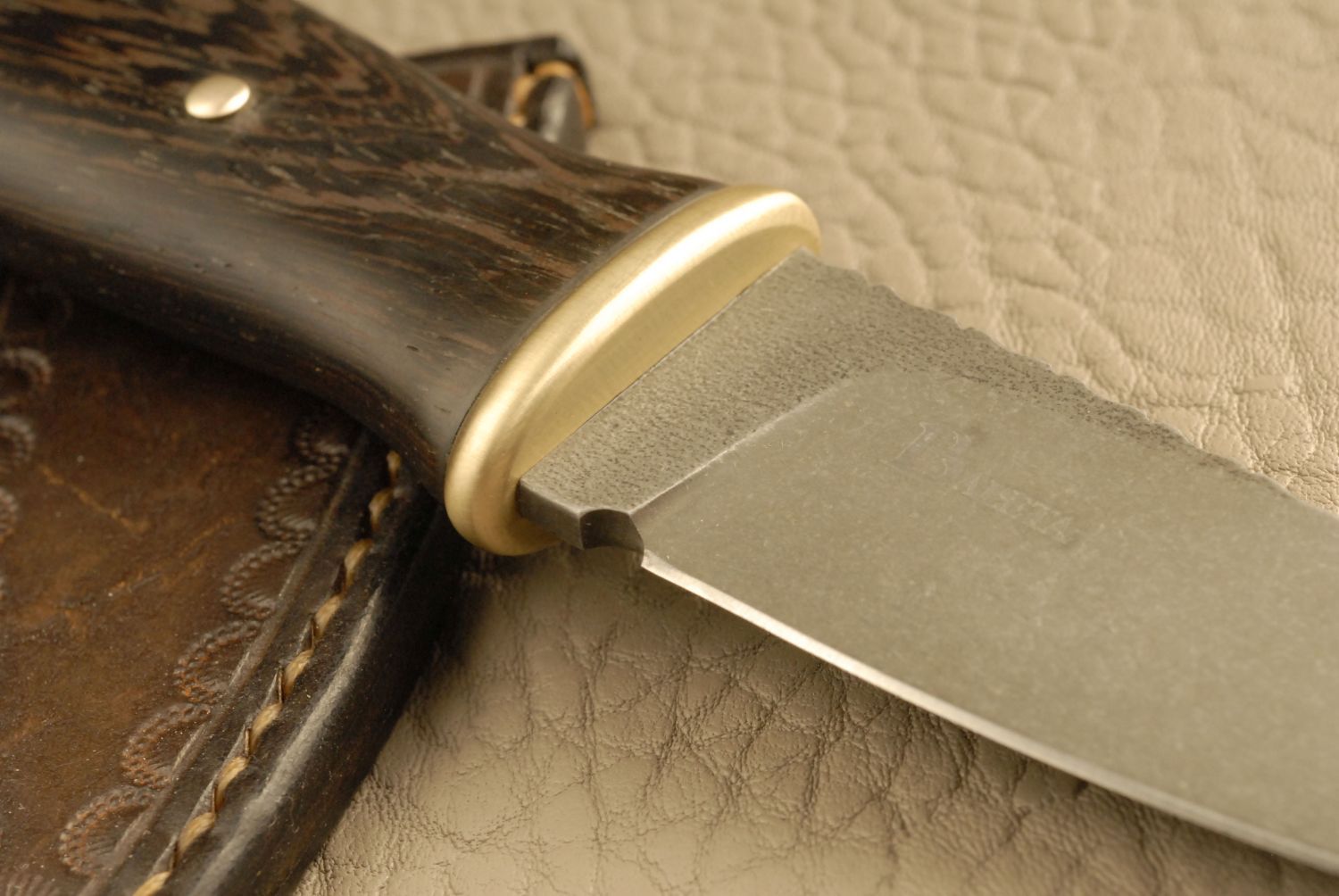

Gorgeous. How do you cut and fit the guard so tightly? How thick is that brass? I love the look of bronze, but haven't had much luck with guards.

scotchleaf scotchleaf - The brass is 5mm thick. I drill a line of small holes and then break them through to each other - making a crude slot. I then use needle files and a file guide to file the slot flat and widen it until it is nearly there. The bolster is then hammered on to get as tight a fit as possible. It takes a bit of fiddling... some work out well and don't take too long :)... some fight you all the way! :(
