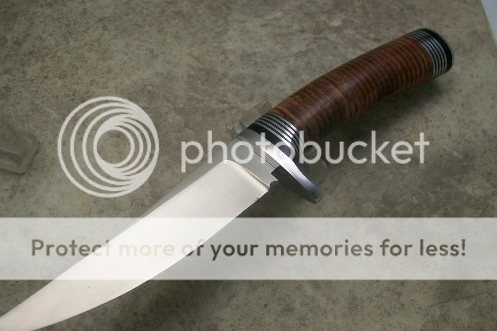

till it melts then wipe it off with a Q-tip. If the flux starts to turn brown its over. Will put up a
pic shortly . This is an ats-34 blade and 416ss guard. Ken.
That's a nice solder job, Ken!
