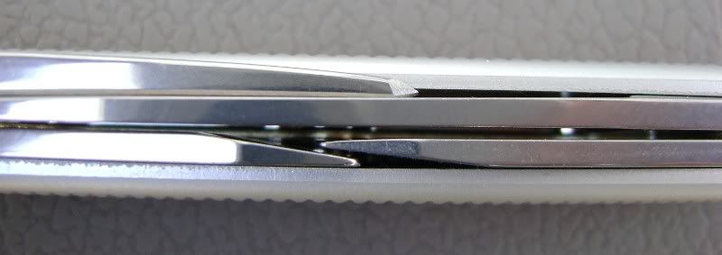

I just broke out a Wenger SI and a Vic Soldier from my collection, and compared them. The Soldier was an 03, the SI was an 04.
Using digital calipers, the thickness of the blades directly behind the cutting edges, in multiple spots, measured identically. So I doubt there's any difference in cutting efficiency. For those who care, the thickness behind the cutting edge averaged around .019" near the belly, and .021" in the center of the straight. This is thinner than many of my other modern slipjoints.
I've read that the SI has a brass liner, and the later-made Soldiers have an aluminum liner. Both knives that I compared had brass liners.
The Soldier's knife blade is obviously crinked, where the SI's is not. I doubt that the crinking would produce a functional difference, but it's there nonetheless.

Hey Buzzbait, can you tell design-wise why the Vic is crinked and the SI is not? Is the Vic blade thicker at the back than the SI so it has to be crinked?

I'm not sure why the Vic blade in crinked. I'll make an educated guess though. I'll bet that the crinking is to keep the awl from scratching the blade so easily, when opening the awl. You see, the point of the Victorinox awl is like a chisel grind, so the point of the awl would easily scratch a blade when rubbing. The Wenger awl has a v-grind at the end, to keep the awl tip from scratching the main blade. When in the closed position, the Wenger awl sits dangerously close to the main blade, where the Soldier shows a definite gap between the awl and main blade. Two methods of achieving the same goal.
Here's the Soldier:
Here's the SI:
In use, I've found the Vic method to be more effective at keeping the knife blade from being scratched, but the Wenger implementation produces a sharper and more functional awl tip.
