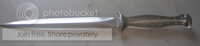

I happen to be working on a dagger milled from solid steel right now.
As you can see, I won't be leaving the handle solid steel, because it would mess up the balance of the knife.
One advantage of using CAD to design a knife is you can evaluate the effect of tapers, grind depth and pommel size on balance. After applying scales, this one will balance on the guard because that is where I wanted it to balance.

Yeah, I think it is going to be pretty cool when I get it done.
stats:
About 11 1/2" inches total length, .200" thick at the ricasso. Distal taper, tapered tang and center rib in the handle with integral guard and pommel. The blade has a pronounced center ridge due to the rather severe 2 1/2" hollow grind ("grind" is a bit of a misnomer here). Currently just under 5 ounces and will balance at the guard.
It is still pretty rough.
I work on it when I can, 30 min here and there. Our own David Wesner (our in-house veteran moldmaker and twice the metal worker I'll ever be) has been kind enough to help me with my manual stoning process. I had the chance to spend several hours on it this last weekend, I'm currently close to 20 hours total (over six just stoning) and I haven't even started scales.

Just curious- I'm not much of a machinist- but how do you clamp the knife when you machine its other side?
That is an excellent question, and not totally obvious, I'm impressed you picked up upon the need to do something.
In order to have something to clamp against, I bridged over the dagger in the finished area with a few bars before starting side two. Had I been feeling ballsy I may have just left them as you see pictured and counted on the clamping to hold them in place, but I also added a few small tack welds.
I ordered the operations to keep a web of steel around the knife until the very end, at which point everything was being held in place by little more than wishful thinking. The last few cuts were pretty light.
edit: the welds were not to the knife.
