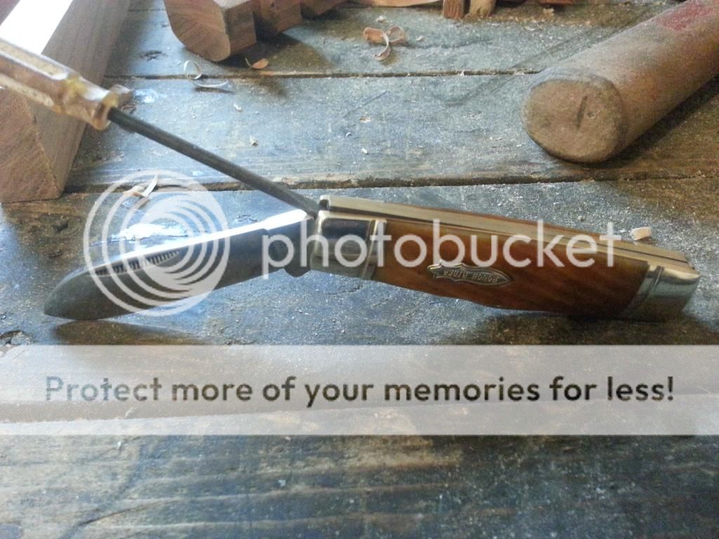

Watch your spring as you open your blade to figure out where the spring is at it's highest. When it's at this point stick a small screwdriver under the spring. Put your knife, springs up, on a table and push the handle of the knife down to put pressure on the springs. Hold the knife steady and use the screwdriver as a lever to push the springs past their normal full extension. I don't know if this helps, but here is a picture of my knife with the screwdriver inserted:
I went through this dilemma recently with a GEC 78. Got it from a 9 to about a 6/7 in the course of an afternoon. The key was . . . flexing the spring BEYOND it's maximum extension. Leaving the knife open for a while will have a similar effect, but not as quickly and not to the same extent.
In a thread on this very topic a while back, Ken Coats demonstrated that you can either add or subtraction tension from a backspring by flexing it in a special vice. That, of course, required taking the knife apart. But another forumite pointed out that you can do this without taking a knife apart: open the knife roughly 3/4 of the way and insert a small pry bar or similar tool into the space between the tang and the spring. Next, place the butt of the handle and the tip of the blade on a flat surface. Simultaneously torque the pry bar and but down on the knife; the blade will not move, but the pry bar with flex the spring. You only need to flex it an eighth or a quarter of an inch at most past its point of maximal flex to reduce the tension. More than that, and you risk snapping the spring.

I just tried this on a really stiff Rough Rider that I wasn't too worried about breaking. It made it significantly easier to open with about 5 minutes worth of work. Thank you so much for sharing this.

Thanks to everyone for your comments. Especially Stencil, Jr and Cory Hess for the description and picture of how to overstress the backspring. I'm a tinkerer at heart so I might give this a shot. Not gonna let a knife get the better of me :mad:

Cory's got it exactly right. Just go slow, don't pry too far, and don't let the screw driver/prying tool slip out. It made a world of difference for me.

Okay I tried it and it worked. But be forewarned-now both blades have side to side play. Somehow by relieving the springs creates some side to side play.
Update : The solution provided above WORKS! I tried it out. Going gently at first but gaining confidence as I went along. Torqued it just a little at a time and tested the pull repeatedly. After 10 minutes, the pull on my knife has gone from a nail tearing 8-9 to maybe a 7+. Still strong but manageable. I'll let time and usage do the rest.
You just need a quality screwdriver that's the width of the backspring and maybe cover the edge of the blade with tape to prevent mishaps. Don't overdo the torquing and check often.

Yes, I used a very small jewelers screwdriver which was the perfect size and sharp edges.. It worked perfect and I hardly torqued it. It went from about a 9 to an 7.5 . But both the blades have side to side play now whereas before they were tight as a vault
