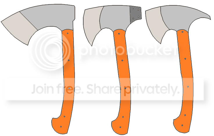

I plan on starting out with fixed blades and tomahawks, outdoors, EDC, and maybe some kitchen knives. I have been drawing knives in autocad for years and have a fairly extensive catalog.
Nothing spurs conversation like some pictures so here are a few of my tomahawk designs i actually have a the hammer pole and spike in progress being ground for my by Will Nease. They are about 12 inches over all length.

Your hawk designs need a lot of work. #1 won't work at all. The edge faces too far down. The only thing that would strike the wood would be the upper corner. #2 has a good edge face, but I don't know what that butt section with the four holes is? #3 is sort of OK, but the edge face needs to be made more straight. If you put the butt of #1 on #2 you would have a good hatchet, and if you put the butt of #3 on #2 you would have a good hawk.

Having drawn many knives in AutoCAD for years isn't the same as having years of knife design experience. Every surface and edge has a function, and there are engineering and physics reasons for the positions and shapes. You can change them any way you want in CAD, but that doesn't mean it will work. Start with basic shapes that are tried and true. After a lot of experience you can try and tweak them, but you will probably have found that the old shapes are that way for a reason.

The first hawk was an idea of a spontoon hawk hybrid the other 2 i've made mock ups of and they seemed functional the holes in the hammer pole are for optional hammer bits i made so you have a 3/4 wide face instead of 1/4.
Im aware that drawing something in cad is not all one needs to design a knife. I use it to draw than i use the drawing to make a mock up using material of the same dimensions than i tweak it until i have something i like and thats comfortable.
