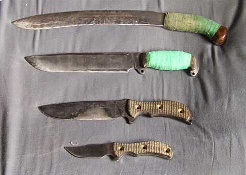

some batoning with the Zubeng bowie
Interesting. How much did the blade cost if you do not mind stating
Nothing, it is an evaluation piece. I reground the edge again today and too another 1-2 degrees off of it. It is now almost identical in cross section at the edge to my SHBM.

Is the Rattweiler close to it in geometry? Would be an interesting comparison.
I can start a passaround on these in about a month. I can include the Ratweiler and MEUK as references.

590 grams with static and dynamic balance points of 4.5/10.5 cm in front of the index finger in the grip. 25 cm long blade, overall length is 38 cm. 5.0 cm wide blade with a full flat grind which tapers to an edge which was origionally 0.055" thick with a light convex grind of 13/15 degrees at the apex.
-Cliff
thanks, very similar in overall dimensions to the SHBM/BM-E and similar in size to the typical Blade competition blades. Just under 15 inches in OAL.
From the weight and dimensions I take it that it is about 1/4 inch thick? With the wide blade the edge geometry should be really good. I have the same edge on my SHBM.
About 0.255 through the handle with a light distal taper, most of the blade is 0.225 or so.
Yes, I'd trim it down a little, about 0.035" I think makes an edge very robust, but this doesn't tend to make a large difference on cutting ability but does increase sharpening efficiency. I'd like to take the primary down on this to that extent but quite frankly that is way too much work for a 1" belt sander unless you have Thom's patience as he would likely even attempt it with a benchstone. But then again he has cats and anyone who has cats has the patience of Job anyway.
