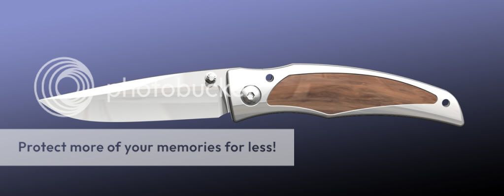

I usually do everything in 3D CAD before making it because of my process. This helps with the design and also helps me figure out how to make it and simplifies fixturing etc.
This was done in Pro/ENGINEER with ISDX:
Slick programs like Rhino and Alias can help with the design process. I find other 3D CAD programs like AutoCAD too chunky to use on stuff like that and a hindrance. I feel that a good 2D tool like Illustrator or some of the programs mentioned earlier in the thread would serve most people well.
Unless you're going for a clunky, military, tactical look, I'd stay away from too many straight lines and constant radius curves and try the spline tools.
Looks good! Clean surfaces, good geometry, and the inlay is great.
Thanks William. I've done a little bit of product design here and there (medical mostly, not consumer), but have settled into a pretty good groove working in my little shop. Knives are a lot of fun. I think it is good that you're assembling a shop so you can make some of the things you design and then use them. Very rewarding and a valuable experience.
