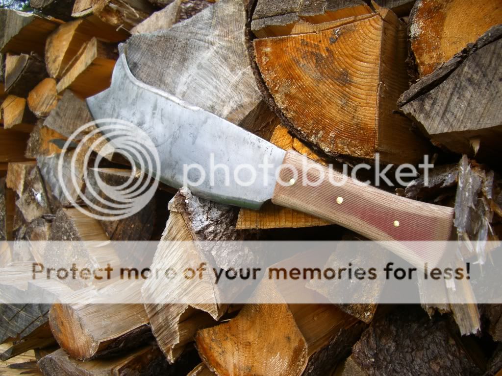

I finally got the chance to get out and take some better pictures of my prototype submissions to Condor. For those still unfamiliar with them (I know--not many of you!) the Baryonyx is a broad chopper designed with North American temperate zones specifically in mind, and is configured to handle everything from grasses and brambles all the way up to full blown trees. The Oberst is a sword/machete hybrid based on the Swiss baselard sword and is designed for a combined role of utility and defense (and fun!) They're up for consideration for Condor's 2013 line, so if you're interested in seeing production versions a little consumer pressure never hurts. :p
The Baryonyx:

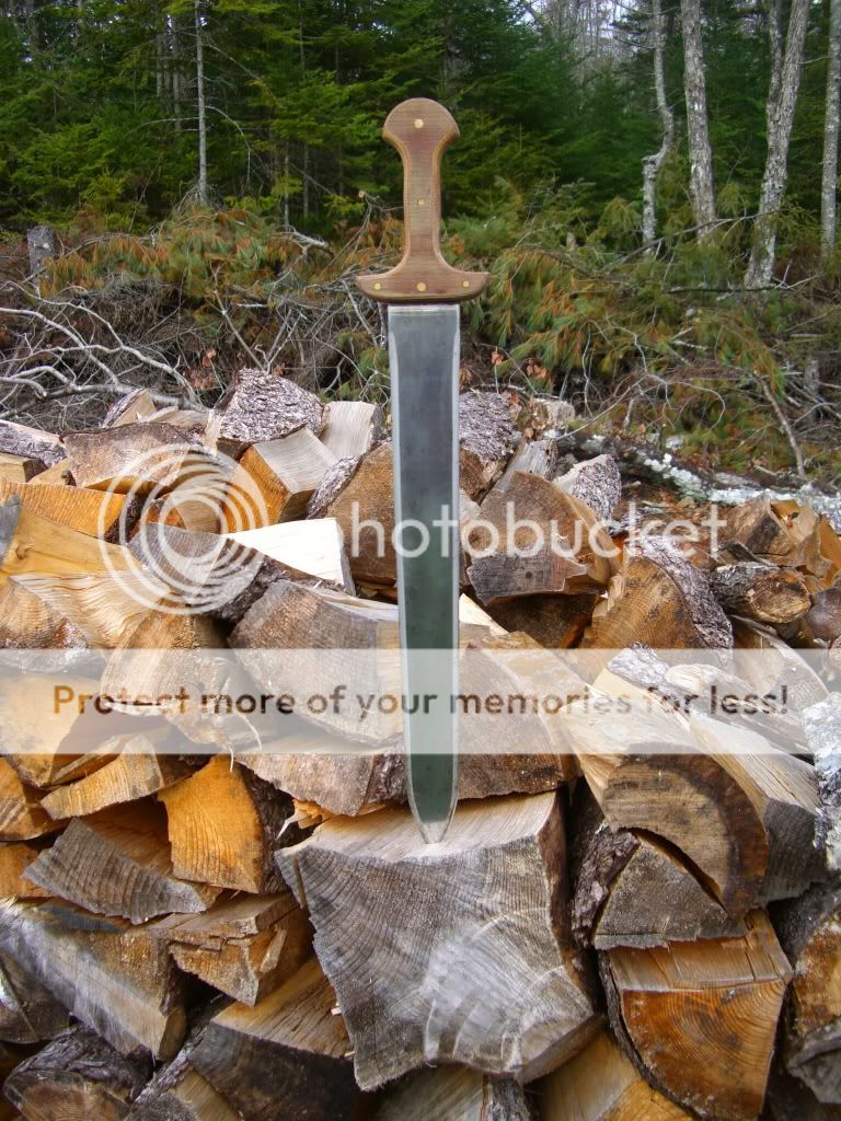

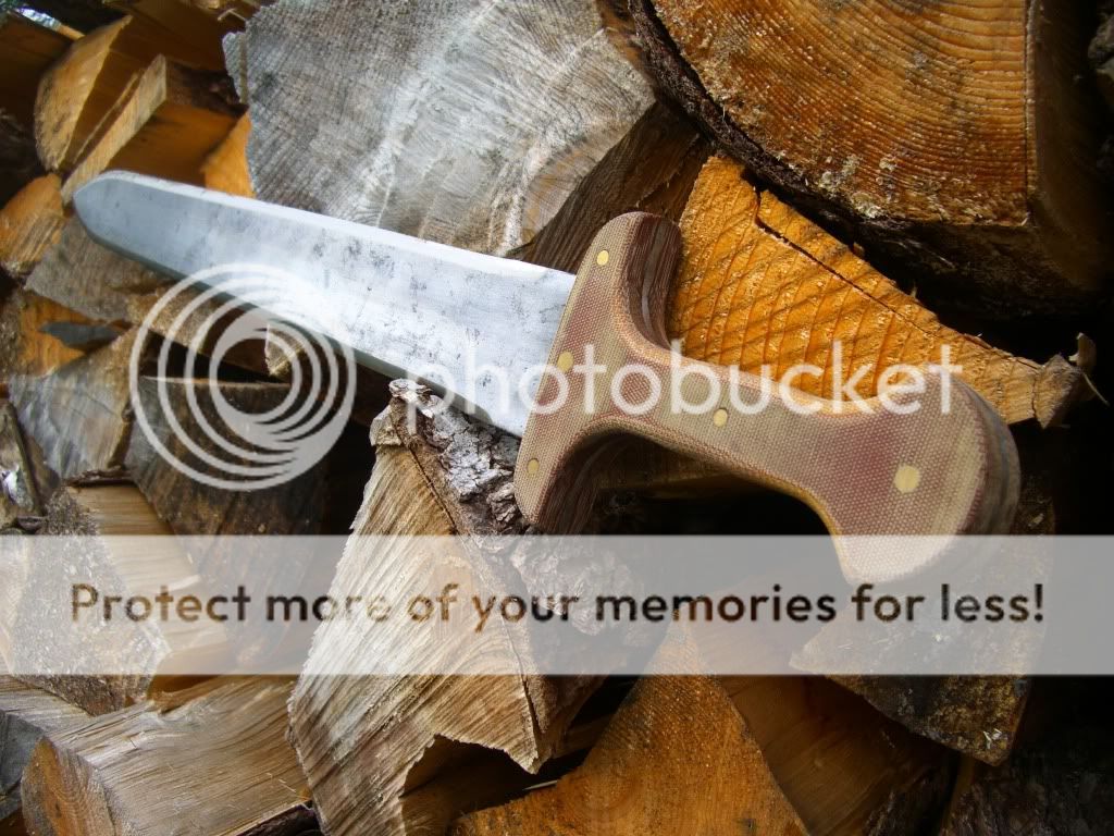

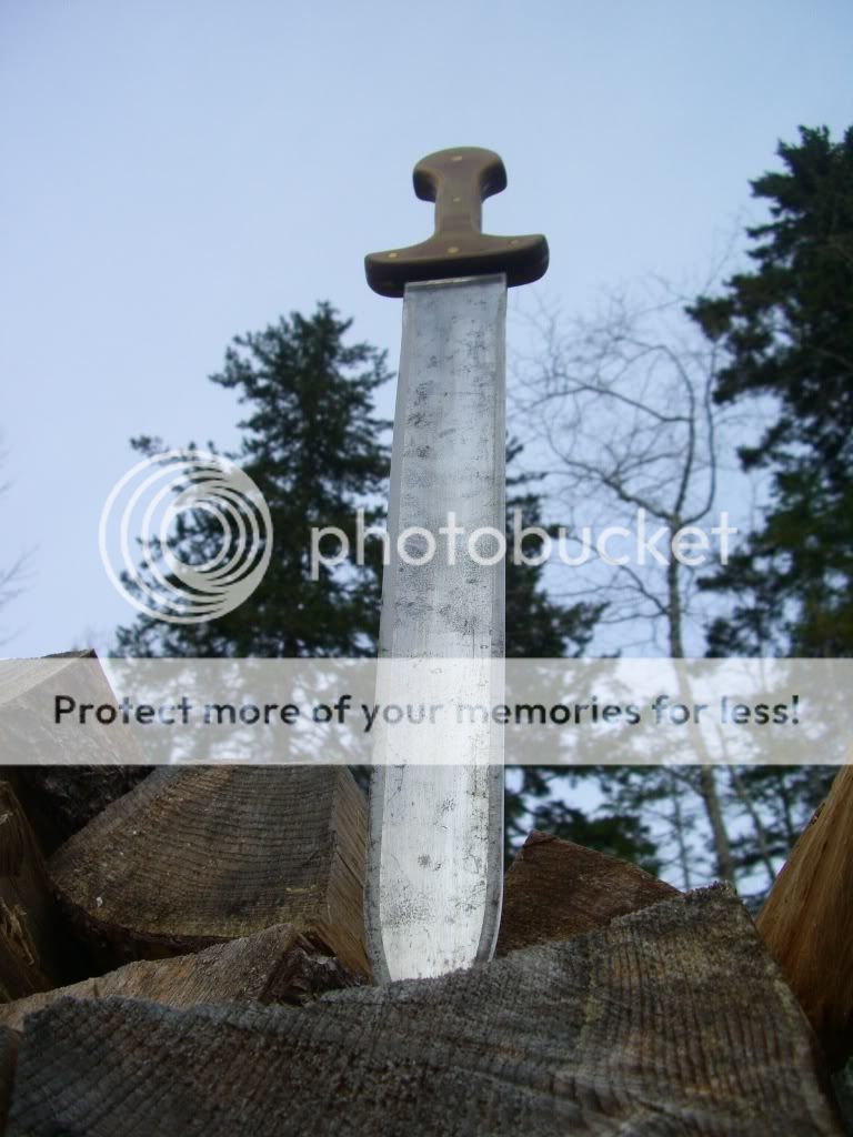

The Oberst

Thanks, man! Here are the videos. No dialogue and the clips are short, but they show off what they can do! Most of them are of the Baryonyx in action as it has the most interesting performance characteristics. The Oberst is pretty straightforward--it's shaped like a sword but chops like a medium/light machete.
The Baryonyx:
Splitting (twisted grain)

The Oberst
Sorry for the poor viewing angle--there wasn't any convenient place to set the camera and my help had run off so I had to chop with one hand and film with the other. YouTube's stabilization feature removed most of the "Cloverfield" effect though. :p

I like the looks and utility of the Baryonyx, what does that thing weigh in at / how thick is the steel / distal tapered? I'm wondering if it had a distal taper - weigh in at 22-24 oz would it still perform well? At 1.25 to 1.5 lbs I'd be interested - much heavier than that and I'm not sure it would get a lot of use.
Below is an image detailing the stats of the prototype.
HOWEVER a production version would be in 2mm thickness and have a polypropylene handle (as seen on the Bush Knife). 2mm rather than 3mm (1/8") stock means that the weight in steel will be reduced by a full third, and a polypropylene handle would weigh a lot less than a micarta one. After those reductions it should be just under the 1.5 lb. mark. The whole idea with this design was to concentrate mass behind the cutting edge rather than to the sides, so the reduction in thickness shouldn't negatively impact the chopping power significantly, but would make it a much handier piece. :):thumbup:

This isn't a criticism but did you think about putting a flared round butt on the Baryonyx? I'm sure you find it stable in the hand as is, but I thought maybe it would give a surer grip.
Thanks for the kind words! It drew heavy inspiration from English billhooks, so you've got a good eye!
The handle as-is is an hourglass shape, so it does flare slightly at the butt of the handle. This is even more pronounced on the polypropylene handle, if it makes it into the line in 2013, as the poly handle flares in thickness as well as width. :)

The wannabe gladiator in me is finding your oberst harder and harder to resist...would even be practical here in the jungles of Guam. May be the way to appease me while trying to find a Busse gladius for a reasonable price.
