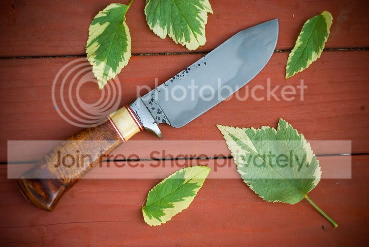

this is great. thanks for sharing. I have a question I will throw out there about ashi. I just clay quenched an Aldo 1084 blade and got a great wavy pattern that etched well. And until I read this post, I was about to consider the job done. On 1084 (only a moderate shallow hardening steel) is it worth the effort to try bringing out ashi???
This isn't the blade I'm working on, but it's the same steel and same treatment:

Mossanimal, GREAT knife! I really like the shape and combination of materials! :)
As far as the ashi... or any fancy whispy stuff.... it's hard to get it on 1084. You can get a very vibrant, pretty white line with quite a bit of activity in it, but it's really hard to get stuff like ashi. I mean to even get them there in the first place. Can't bring them out with polishing if they're not in the steel to begin with.
I sure won't say it can't be done!!! I just know from personal experience that IN MY SHOP... a very active hamon is much easier to achieve with 1095, W1, or W2.
