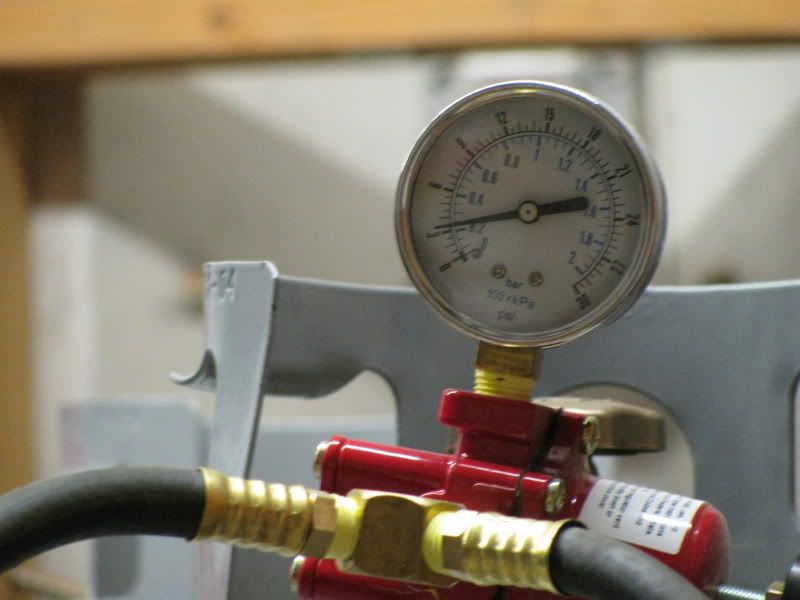

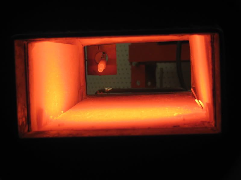

Hey guys,
I just installed a K-type thermocouple to my new habanero chile forge. I wanted to be able to really dial in my forge temps. The results I got blew me away.
The thermocouple was complete unit I got from the pottery supply place that Ed C. has mentioned a few times I believe bailey pottery. I will have to take it into work on thursday to see if the I/C techs can verify if it is reading correctly or if it is off a litte on the temps.
With one burner, a little over 3psi of propane, I averaged 1733 degrees. I couldn't get it any lower. With two burners it average about 1954 degrees. That's way to hot for what I got it for. I have a forced air forge for welding and wanted this one for just lower temperature forging of 1084 and 5160. Tomorrow I'll be headed to the welding store to get some smaller mig tips to see if I can't get the temp lower and use less propane.
You'll notice the thermocouple was away from the hot spot caused by the square chamber as well. With both burners running there is almost no hot spot, but I was running one to get the temp to come down.
I have the sick feeling that everything I have done this year is about to get thrown away.
