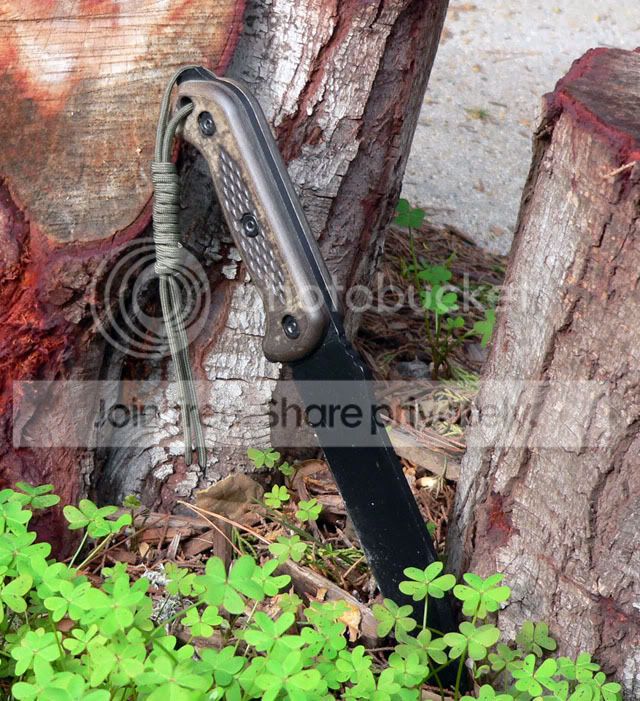

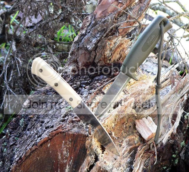

I've been playing with my camera, trying to get the exposure right, so I took a few photos of some knives.
Becker BK-7

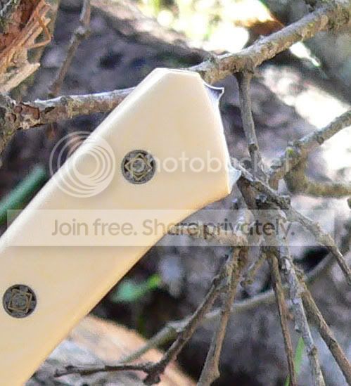

BRKT North Star & Frost 760
Broke BRKT North Star! Yep, as I was carrying it out for the photos, it slid out of the sheath and landed right on the lanyard, which of course snapped off. Guess I need to get ahold of Mike Stewart and see if he can take care of removing the rest of it. :(
Man that sucks, I dropped my D2 Ka-Bar down some rocks and that never chipped or anything and D2 is touted as being brittle so I find it strange your BRKT blade should break so easy ?
I'd speak to them ASAP and I'd think they would give you a new one !!!
Great pics by the way !!!!
How far did it fall and what did it land on!? I'm quite surprised to see the lanyard loop just break off like that.
Nice pictures.
:(That broken lanyard loop is spooky, Mike will take care of it, but jeeeeze:(
That shouldn't have snapped like that. It may be indicative of an overall HT problem on that knife. I'd send it in for replacement.

Thanks guys.... Needless to say, I was very surprised that it broke off like that. The first thing that I thought of was heat treat, but I've got no experience in that kind of stuff, so we will see.
I just finished packaging it up with a note to Mike, explaining what happened and I stapled the small piece of lanyard (in small plastic bag) to the note. Sure would be nice to get a new one, that's for sure, but whatever Mike thinks is best is OK with me. I'm sure that he will be fair about it all.

A little info from the Crucible site regarding tool steels like A2.
There are several other factors beside inherent material properties which often contribute to chipping or breakage failures. Tool steels are notch-sensitive materials. The presence of notches, undercuts, sharp radii, changes in section, or any geometric features may concentrate applied stress and exaggerate the material’s tendency to break. All reasonable precautions to avoid unnecessarily sharp radii should be exercised.
