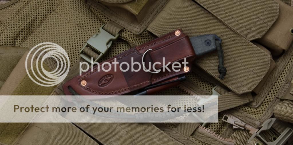

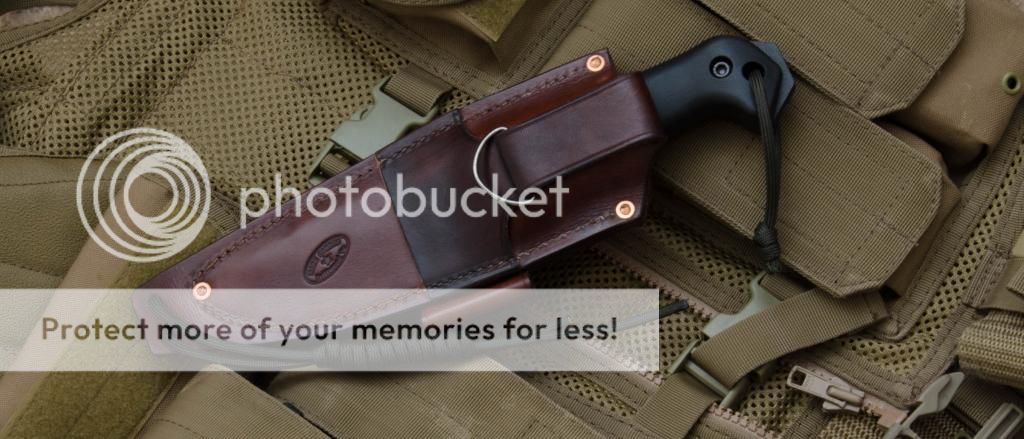

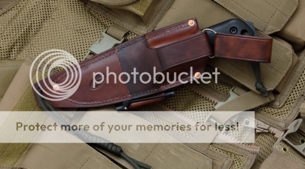

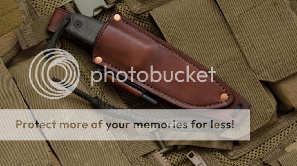

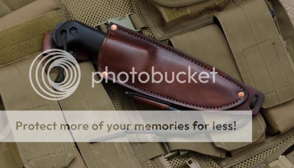

Some recent work that I've done.
All have fully lined interior, firesteel loop, military grade black hardware, removable lined dangler, copper riveted, and 100% natural beeswax/oil finish.

ESEE 3 Bushcraft sheath with firesteel, removable dangler, leg tiedown
CRK Green Beret with firesteel, removable dangler, removable retention strap, leg tiedown
Becker BK2 with firesteel, removable dangler, leg tiedown
Mark, excellent hard use designs that appear to be bullet proof, yet beautifully finished.. Who says you can't be tough and beautiful at the same time? I really like your design for anchoring the primary loop using the side seams. Just excellent work start to finish.

Very nice. I especially like the CRK sheath. Looks like a solid upgrade from the factory piece. Great attention to detail. Makes me want to go draw. Thanks for that. :)

Paul, thank you! I like to make my 'user' loops that way for a couple reasons. I didn't want to use rivets, to keep metal from the inside of the sheath (to protect the blade). I also didn't want to have any loop stitching across the inside of the sheath, to keep it from potentially being cut. Also, I like how it looks!
Strig, the GB7 sheath turned out awesome. I really like that the retention strap is removable. It's not needed 99% of the time because the knife fits so well, but when you use it, the snap on the back side allows the strap to easily pivot down and out of the way of the cutting edge when re-sheathing, so it basically cannot get cut. (I would normally have the strap come across the top of the guard on the thumb side, but on the GB7 it isn't big enough to secure with the strap, so I ended up on the cuttin' side)

sorry if I'm resurrecting a post here but I had a question on the firesteel holder. Is that basically part of the welt, or on that same layer? It looks very well integrated.
Cold, yes I cut out a section of the welt and replace it with the loop. Total thickness of the loop is same as the welt.
