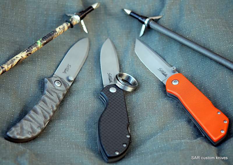

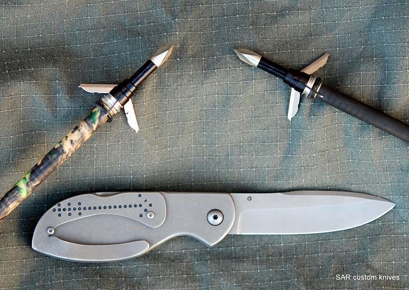

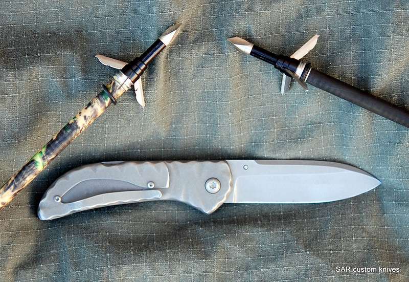

Broad Arrow Drop point
3" cpm blade with false edge stone wash finish OAL is 7"
3 3/4" Chad Nichols Damascus is .090, bare side is .100, clip is .040 stonewashed
.250 pivot

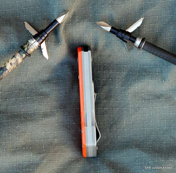

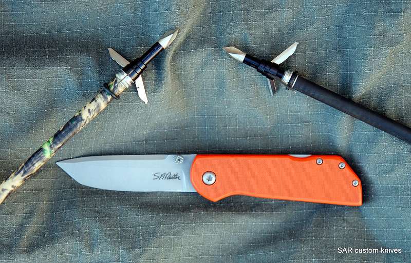

Broad Arrow Tanto
3 3/4" Ti frame side with G-10 is .071, bare side is .100, clip is .040 stonewashed
Course Peel Orange G-10
.250 pivot

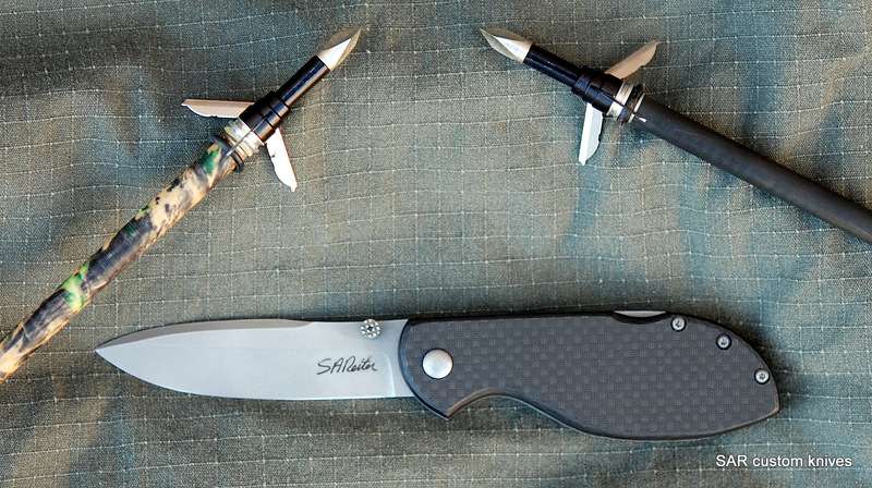

Lost Arrow #2
3"+ cpm blade with false edge stone wash finish OAL is 7"
Ti and Corse peel texture Carbon fiber frame stonewashed
.187 pivot
Blade can be double edged no problem
Ti Clip
Spencer, those are all awesome! I LOVE the new logo too. The orange & Damascus one's are my favorite.
gettin better all the time my friend!
I really like the Broad Arrow Tanto, and the clips are possibly the coolest I have ever seen. Great work
Great new designs, Spencer......the drop-point is my favorite, too. :cool:
Don't like orange knives.:barf:
That damascus handled one is vey nice!:thumbup:
And I like it that somebody is making lockbacks, in these days of liner locks, frame locks, ball locks, axis locks, button locks and whatever.
Kind regards,
Jos
I like the drop point best also. What kind of arrows are those...fishing?
Nice work Spencer.
Peter
They are Hollow Carbon Fiber shaft with expandable knives, they fly like field points, when contact is made the rubber O-ring slips back and the blades slide into the open position. Fishing arrows are always solid shaft with collapsible barbs.
Thanks for the comment on the folders.
Spencer
