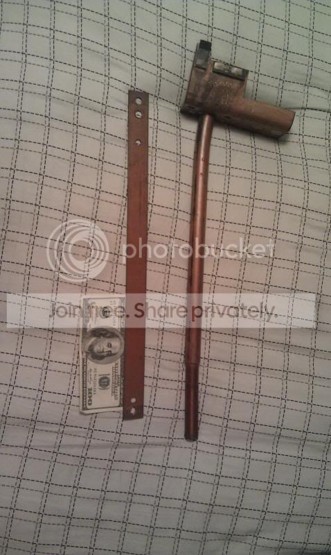

LMK if you guys need copper or aluminum big-ass chunks too. I am out there on a semi-regular basis and can toss stuff in my truck as I tear it down.
Like this, I by no means am trying to hijack the thread, I think this is cool because I have access to stuff it seems like yall could use. If so, lemme know.
