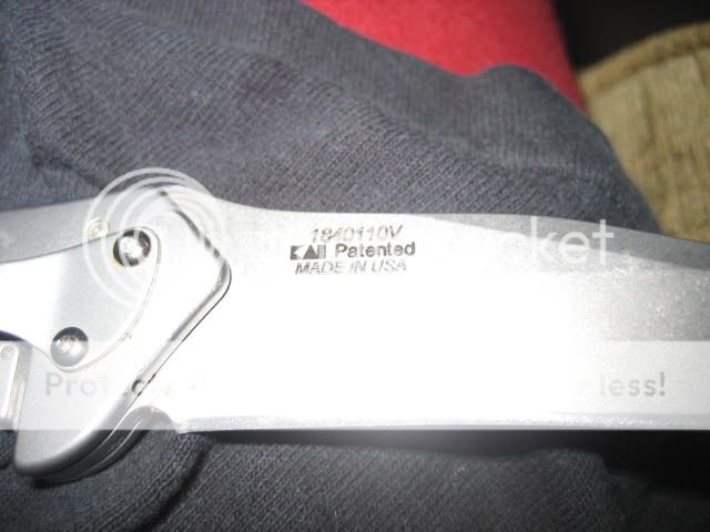

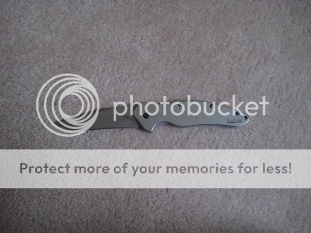

Bead-blasted steel that's not afraid of its carbides. You know it's sexy.

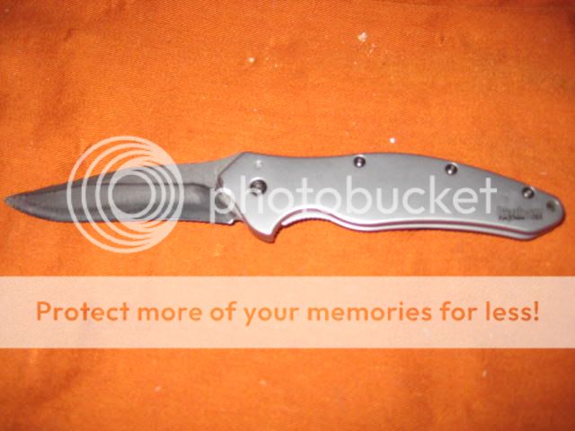

Open the door; get on the floor; everybody walk the dinosaur!
How were they able to make a pointy, recurved blade without making it an attention hound?

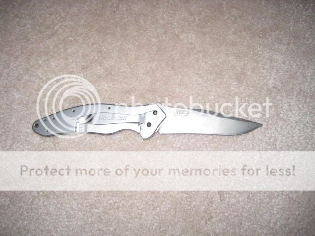

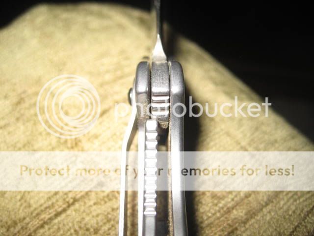

Blade was unruly, so it got thrown in lockup. Should probably clean it a little better...

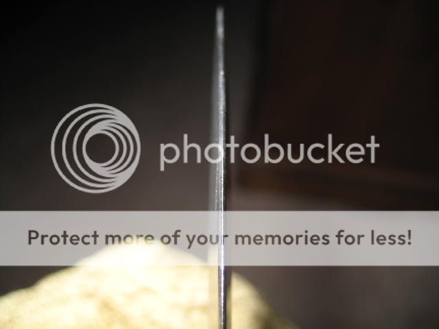

Dull, flat, and shameful and corrected in about 20 minutes.
As someone who generally hates S30V, I still have to admit this S110V blade is impressive. Gotta be how the alloy carries its bead blast. By the way, the edge-bevel never lost its shine and the blade wasn't really scratched after cutting through rocky soil.

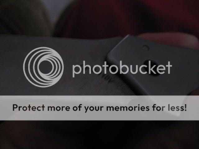

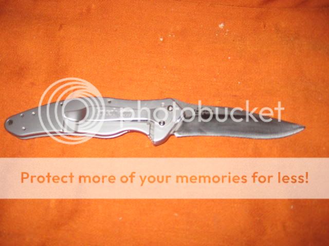

Here are some pics of the blade thinned out with a belt-sander (au revoir, tip. :( ) and sharpened with the 40° setting on a Sharpmaker:
The edge bevels (below the sanding marks) are cute, but it ain't sexy anymore. And still can't shave hair. If anyone has a time machine, please let me go back to when I only did rough grinding on this knife with just a DMT coarse paddle.
